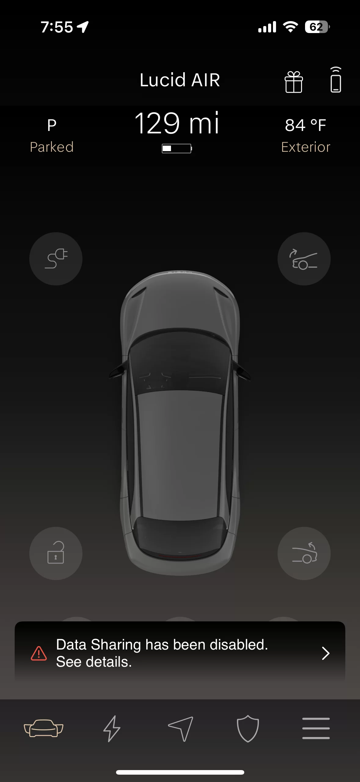

So, I have posted about my problems with SiriusXM and the car’s internet connection, or lack thereof. I can use Spotify and/or Tidal without issue. In my search for a remedy, I turned off Data Sharing and turned it back on. No joy, so I had SiriusXM cancel the non-working Lucid service. I will just use CarPlay if I want to use SiriusXM I guess. Problem is that I now get a banner on my app that says data sharing has been turned off even though it was turned back on. The app will not let me lock/unlock the doors, open/ close the frunk/trunk/ charging door or anything else on that page. It will, however, show me the charging status. I have reset the car, changed users, deleted the app and reloaded it, etc. nd still no change. I have looked at this both at my house as well as when I was out to dinner, no difference.
Any thoughts?

This what my app shows which is not what the car shows. Crazy that the phone is definitely communicating with the car, but none of the car controls are available on the app and the mobile key (unlocking/locking) the car does not work.
My app has been stuck like this for a few days now as well, after I turned data sharing off and on a few times from the car. The API says "privacy_mode: PRIVACY_MODE_CONNECTIVITY_DISABLED" even though the data sharing switch is turned on in the car. I can still control it from Home Assistant. The app just doesn't think it can, so it won't try. I don't think this is related to your SiriusXM issues though, and it doesn't seem like a connectivity module failure either.

So I never actually made it back in for a service appointment, but I figured I'd try fiddling with the data sharing setting again today. They clearly did some work on it in OTA 2.2.2. I turned it off, which requires your account password now (great idea, since it disables GPS tracking), then turned it back on. My app came to life immediately. Problem solved for me.
