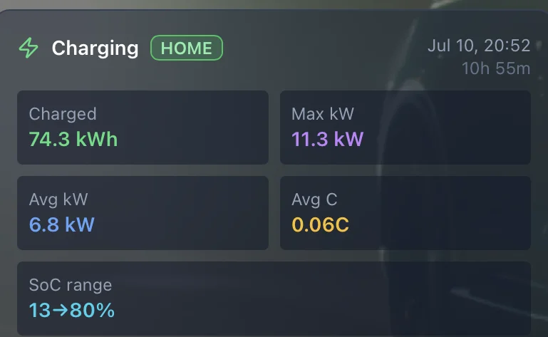

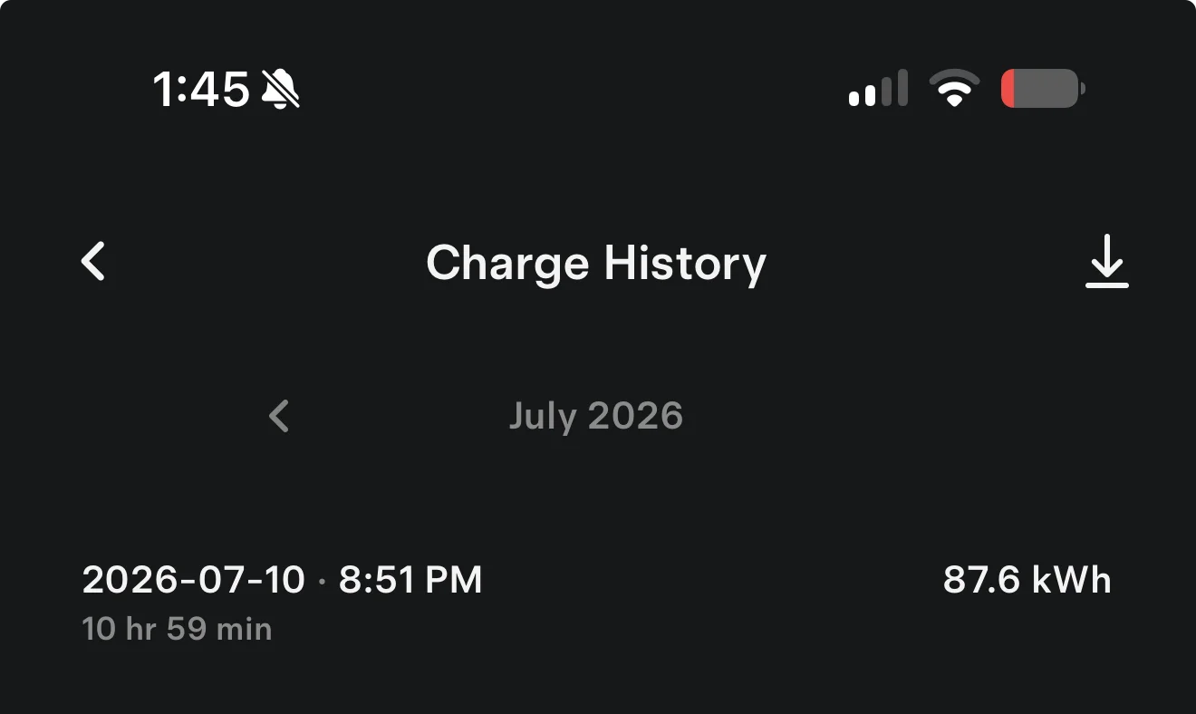

Last night my car says received 74.3KW but my charges says 87.6Kw delivered. A loss of 13.3kw which is nearly an 17% loss. I asked Lucid and my service tech and also posted in this forums. Only members in the forum responded but theirs is around 10 to 14%. Mine is even higher.
Lucid has no response for me even after requesting 10’s of times to check my car or help me understand the math :(
