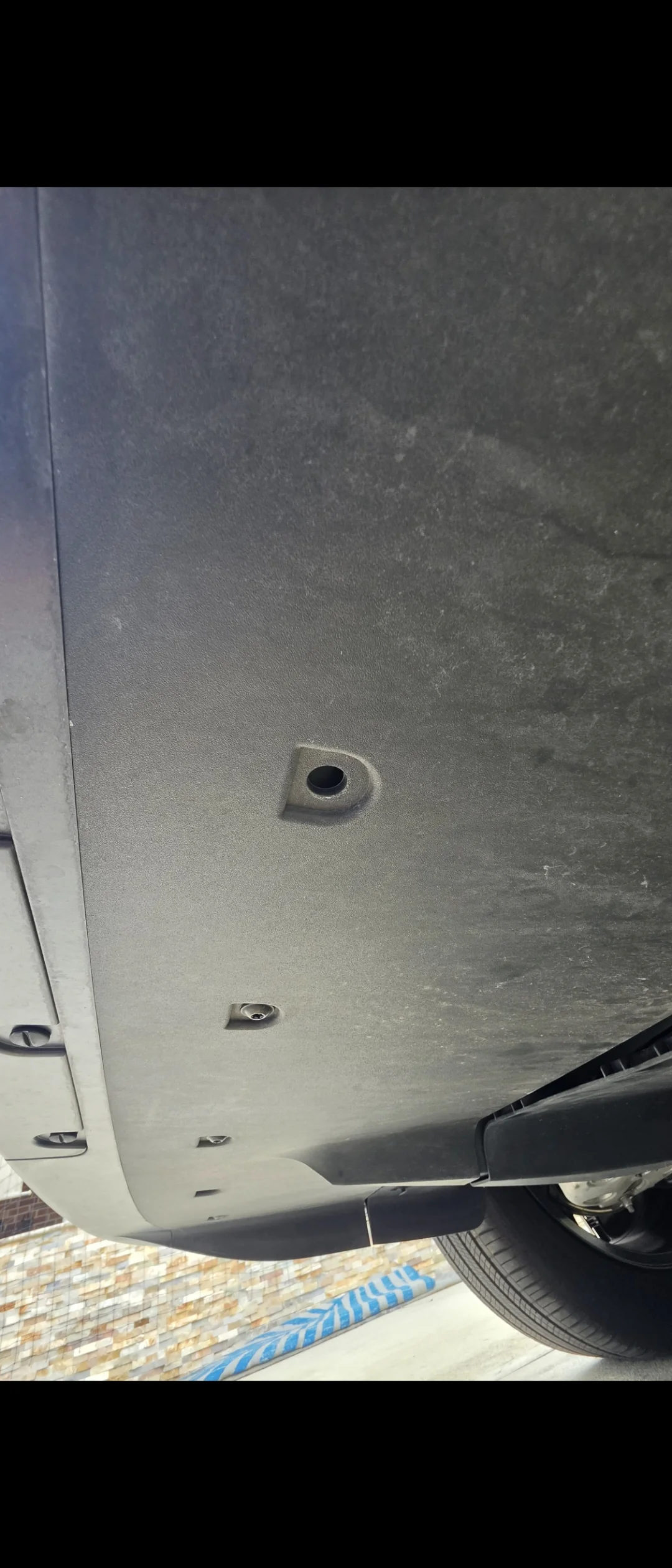

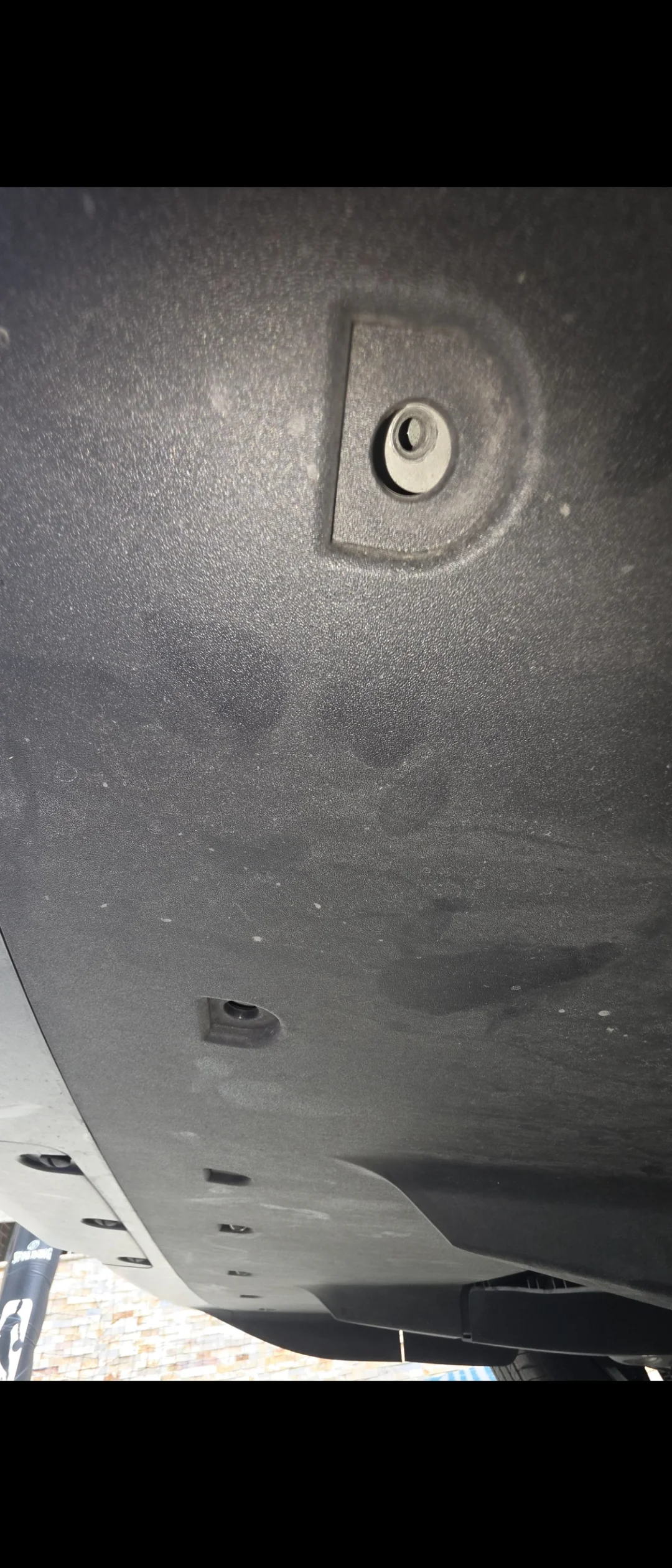

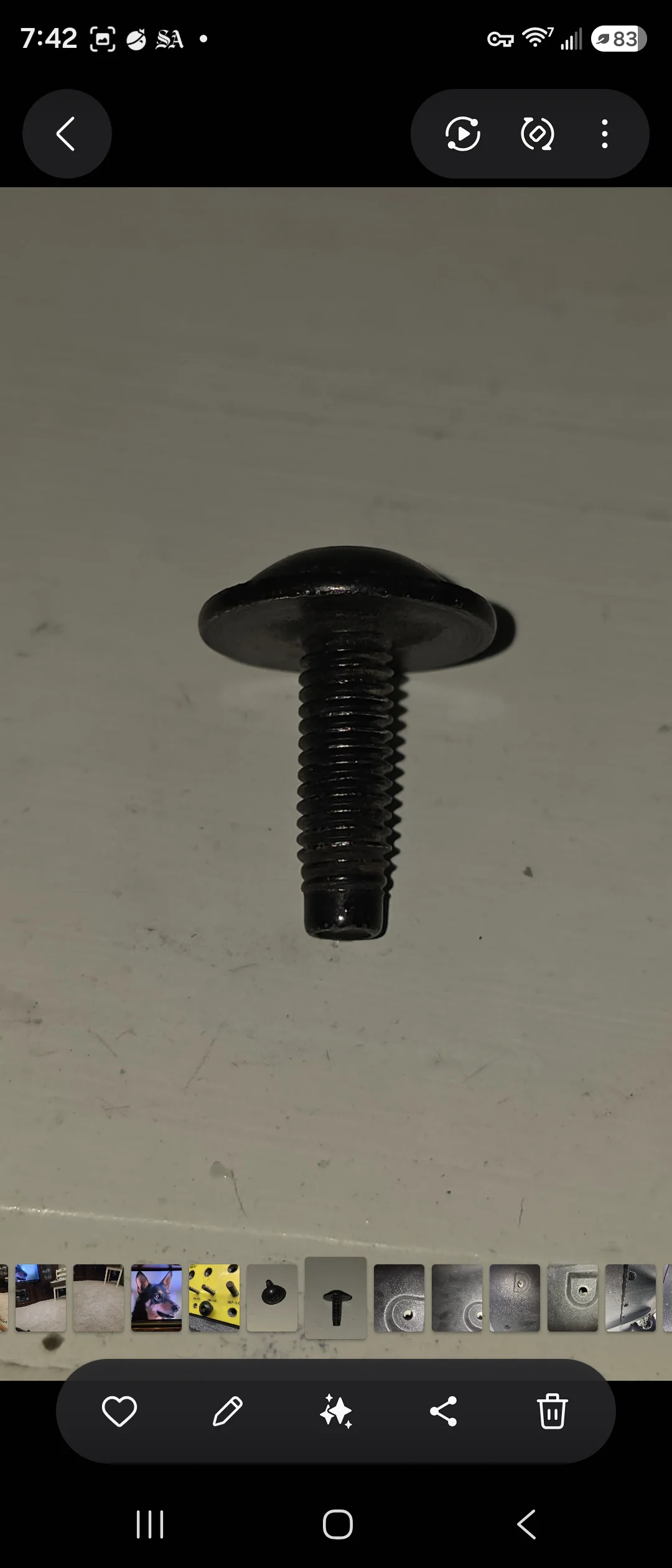

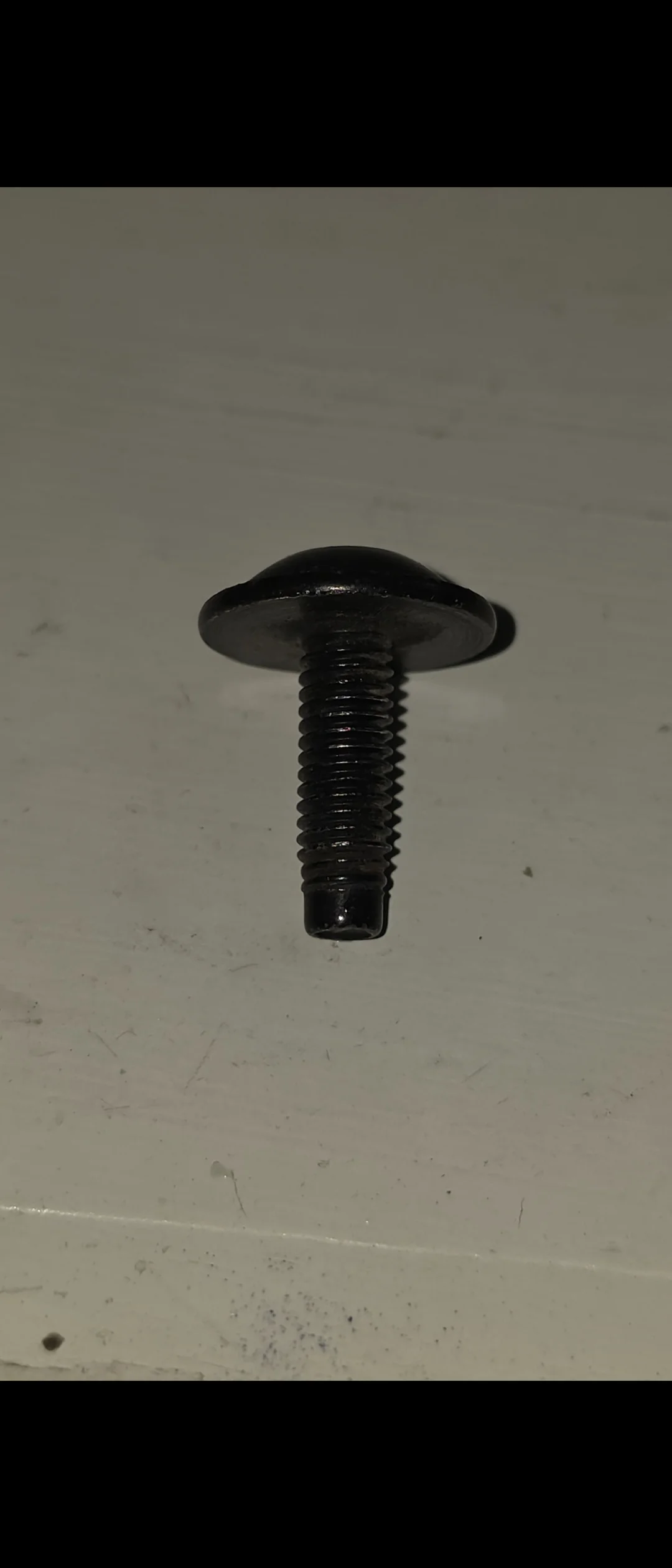

Glad i spotted this during a trip because the panels were about to come completely loose. These are the rear underbody shields and there's approximately 14 bolts, but only 5 were present. After inspection, there was no threadlocker at all for any of the bolts, which explains why they came loose. Mine is a 2027 as well, so shame on Lucid for missing such a basic step.
Regardless, dont wait for your panels to come loose or get lost completely. Plus the sag is causing aerodynamic issues and more road noise. Blue threadlocker 242 should be enough.

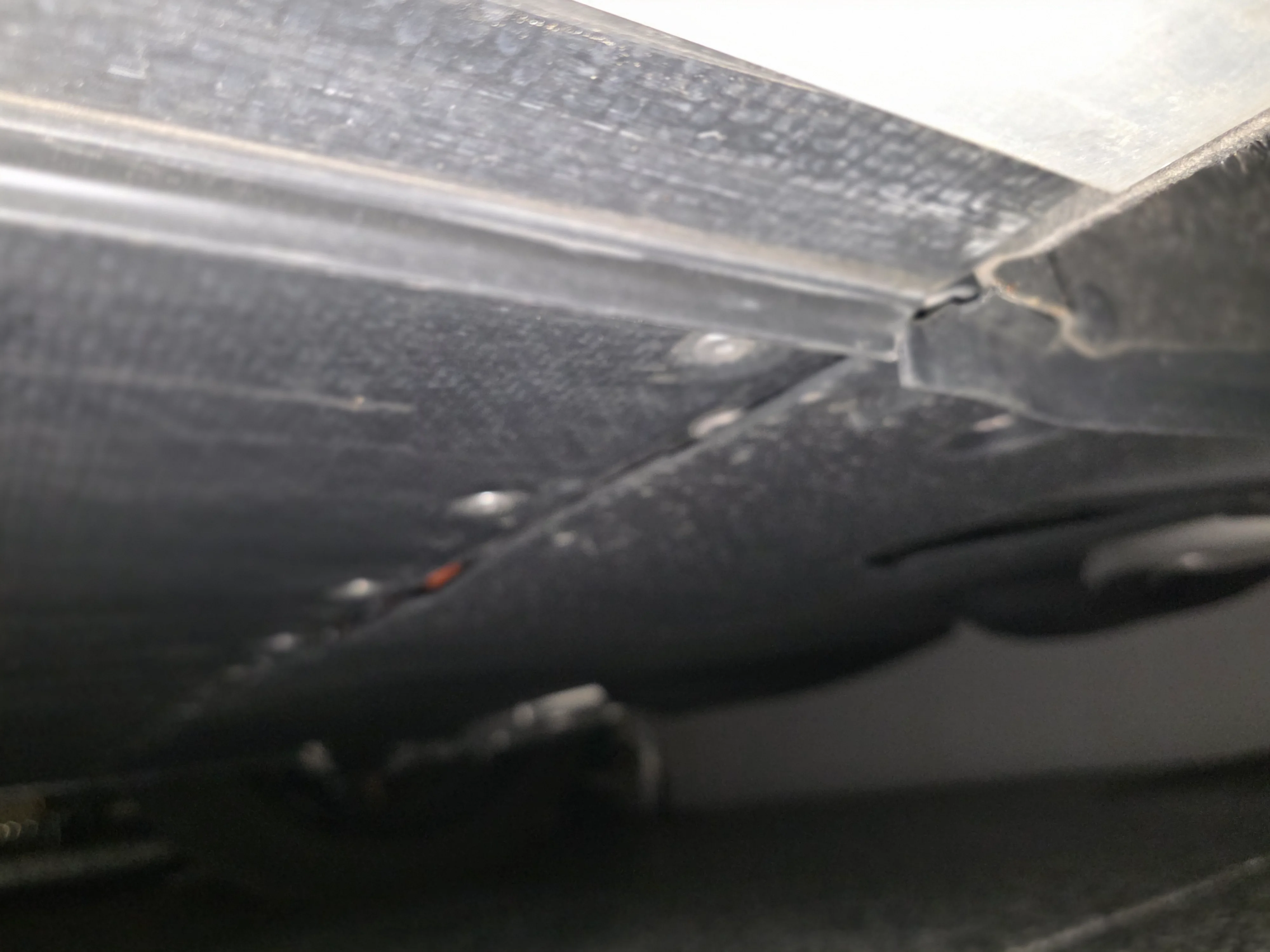

Just checked mine, all there no obvious loose. 2026 delivered Dec 26. But, since I never looked under there before checked everything else. Bolts all there I think. But there is a not very aerodynamic spot or two underneath where the back panel meets the middle panel (back driver side door a couple of feet in). One the back panel is a 1/4" lower going over a bolt underneath. The second almost a 1/2" gap not sure why. Picture attached ... see red spot ... wiring I suppose. Intentional or sloppy design?
