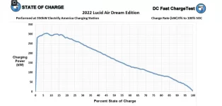

1. The wonder box is cable of up to 19.2kW. Miles is a poor way to measure charging as miles per kWh can vary significantly. The Air will be able to pull the 19.2kW to almost 100% state of charge. See graph below.
2. Yes. The car and the app will both show how many kW the car is charging at.
3. From the graph below you can see the max the car can pull.
If the Air is at or below 5% of charge and the battery is preconditioned and the EA charger can provide as much power as the Air asks for, you could add ~55kWh in 15 minutes. At 3.7 miles per kWh you could go over 200 miles.

the curve on a L2 charger will be flat. You will pull the full 9.6 kW from 0% to almost 100%. The L3 curve will be much faster when at a very low state of charge and then it slows down from there. It slows considerably after 80%. you will notice that a L2 charger may actually be faster once you get to a high state of charge.

Is there a chart like what you posted for the super chargers for the hom 80AMP Charger? Mine drops from 18Kwh to 7Kwh at about 210 miles according to the App.
