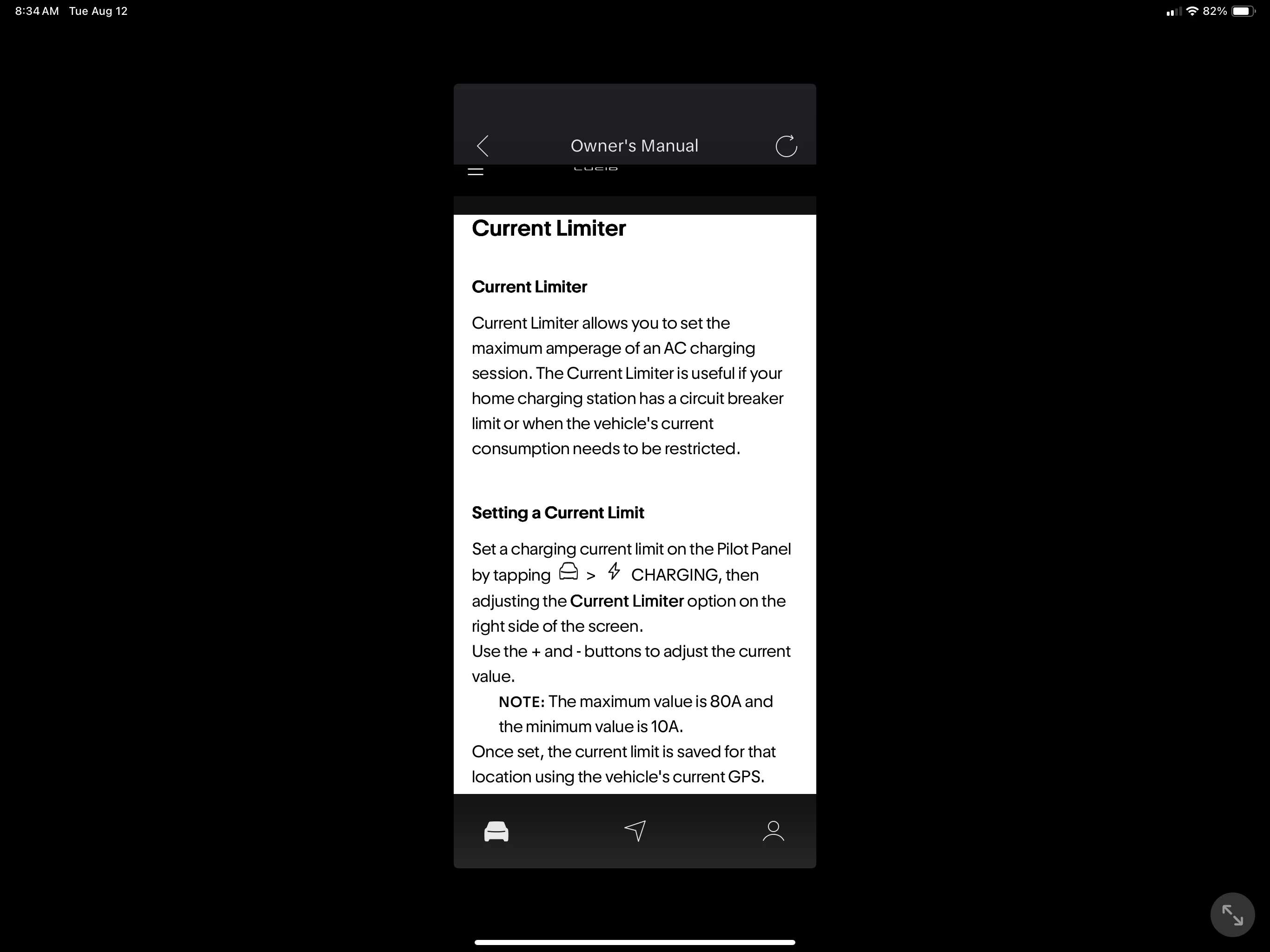

Keep in mind that the last update allows you to set max amps going into the car. Make sure that is not set too low.

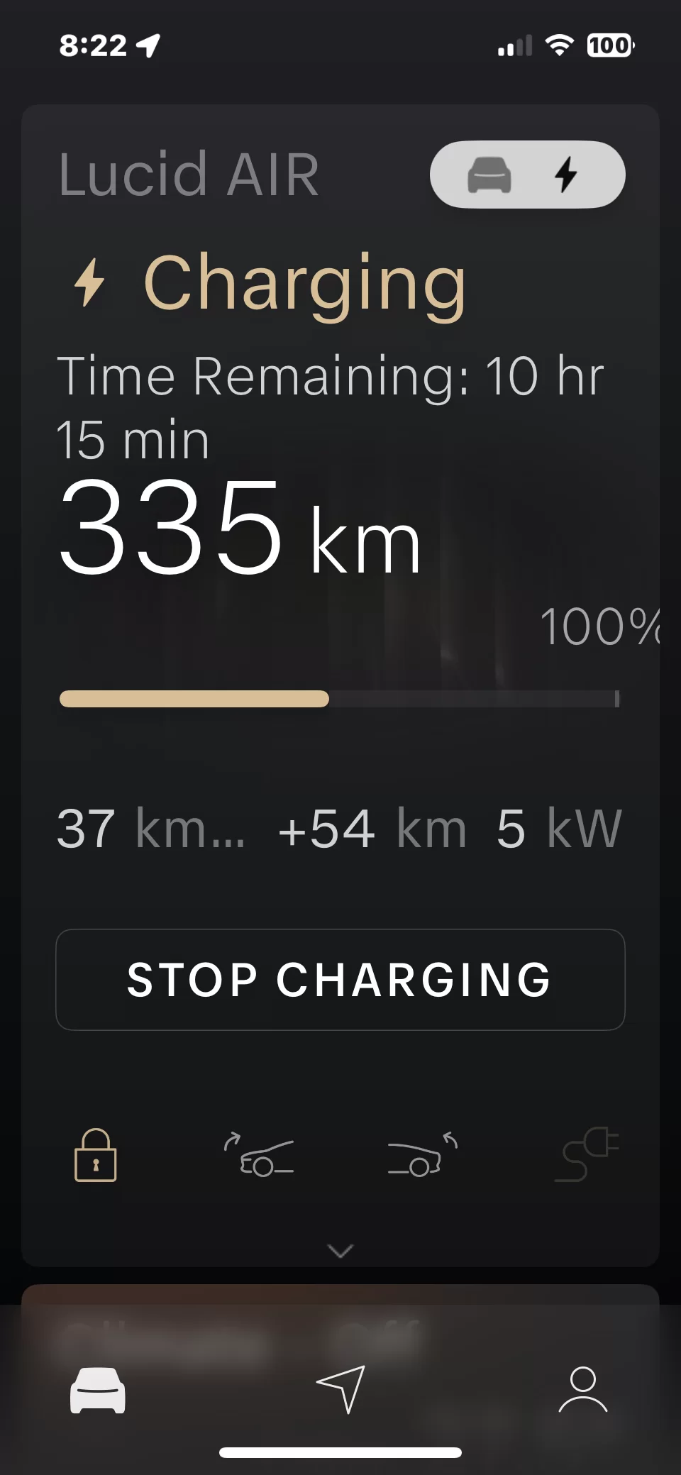

Thanks - how to access that? From the car ‘s main screen? Also here is a pic of charging. It says 37 km per hour … - am I able to expand this info - it seems no where I can click to get more info- sorry for newbie question. It’s a giant leap in tech from my PHEV. 😎

just be aware that the recent update allows two different settings for AC amperage, one for home .. it's geo-based so make sure you know how it's working (online manual, update email etc).
