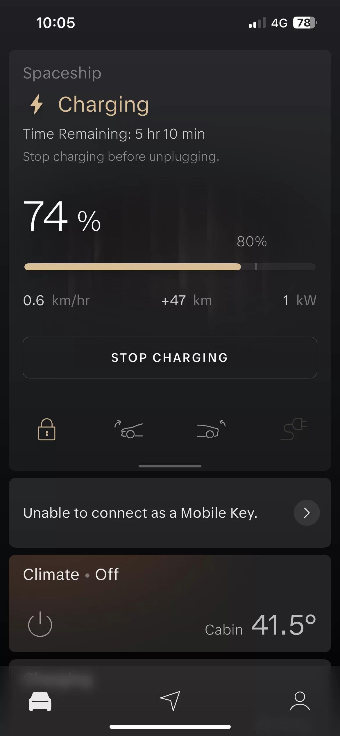

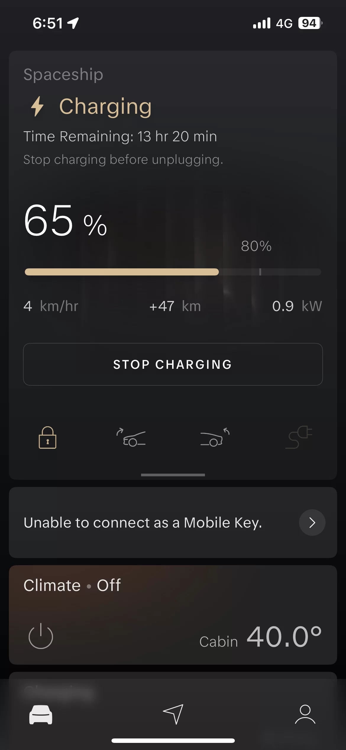

I decided today to push the car hard and explore it more. The weather was hot like 107f / 42 degrees so I put the AC on obviously and after 30 mins of driving I start to push the car fast to driving no less than 85 to 100 for about 5 mins or 7 mins
When I got home to charge the car it started to charge to 7kw then suddenly it dropped to 1kw or less
I thought umm I guess the car is too hot so I let it sit for 40 mins then tried again and the same happened
Note that My charger is 7kw wallbox
Is this normal ?
I restarted the charger and plugged the car again now as I am writing this post and crossing my fingers. so far it seems doing fine as normal

My car does this in Phoenix sometimes while charging in the summer. Your car is using 6kW of the 7kW from your Wallbox to cool the battery and AC to DC converter. Just let is go and you will see the charge rate rise and fall several times while the car is charging.
