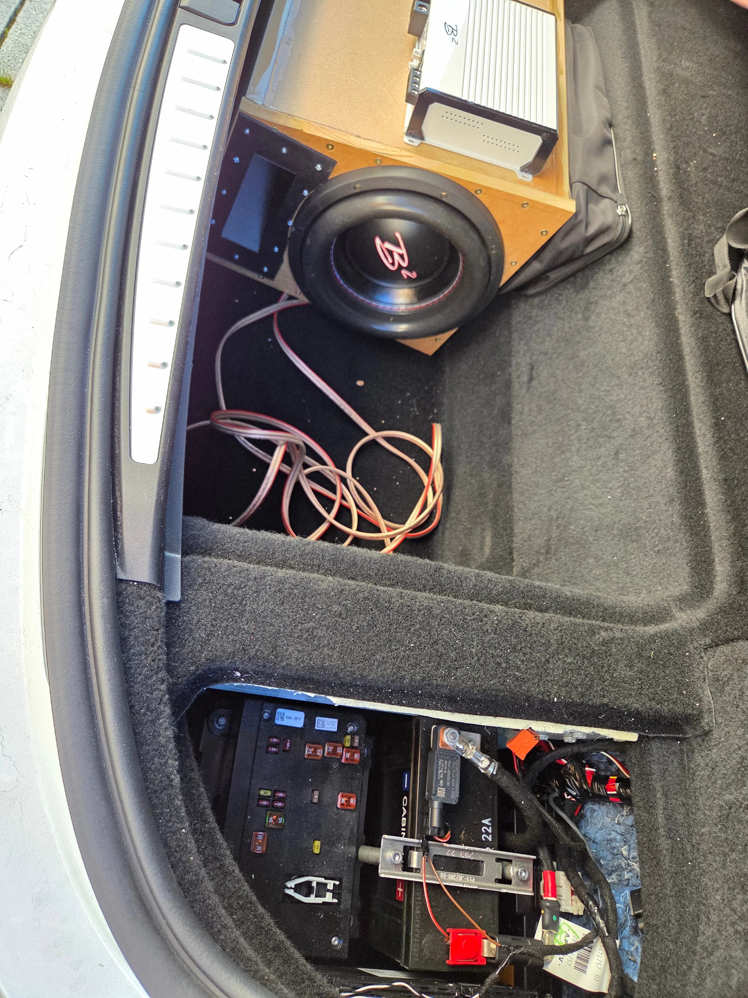

I installed a subwoofer, amp and a LTO battery and therefore I disambled almost the whole trunk, but I didn't found modules in the trunk. there is just a fuse box, tiny battery and a bunch of cables.

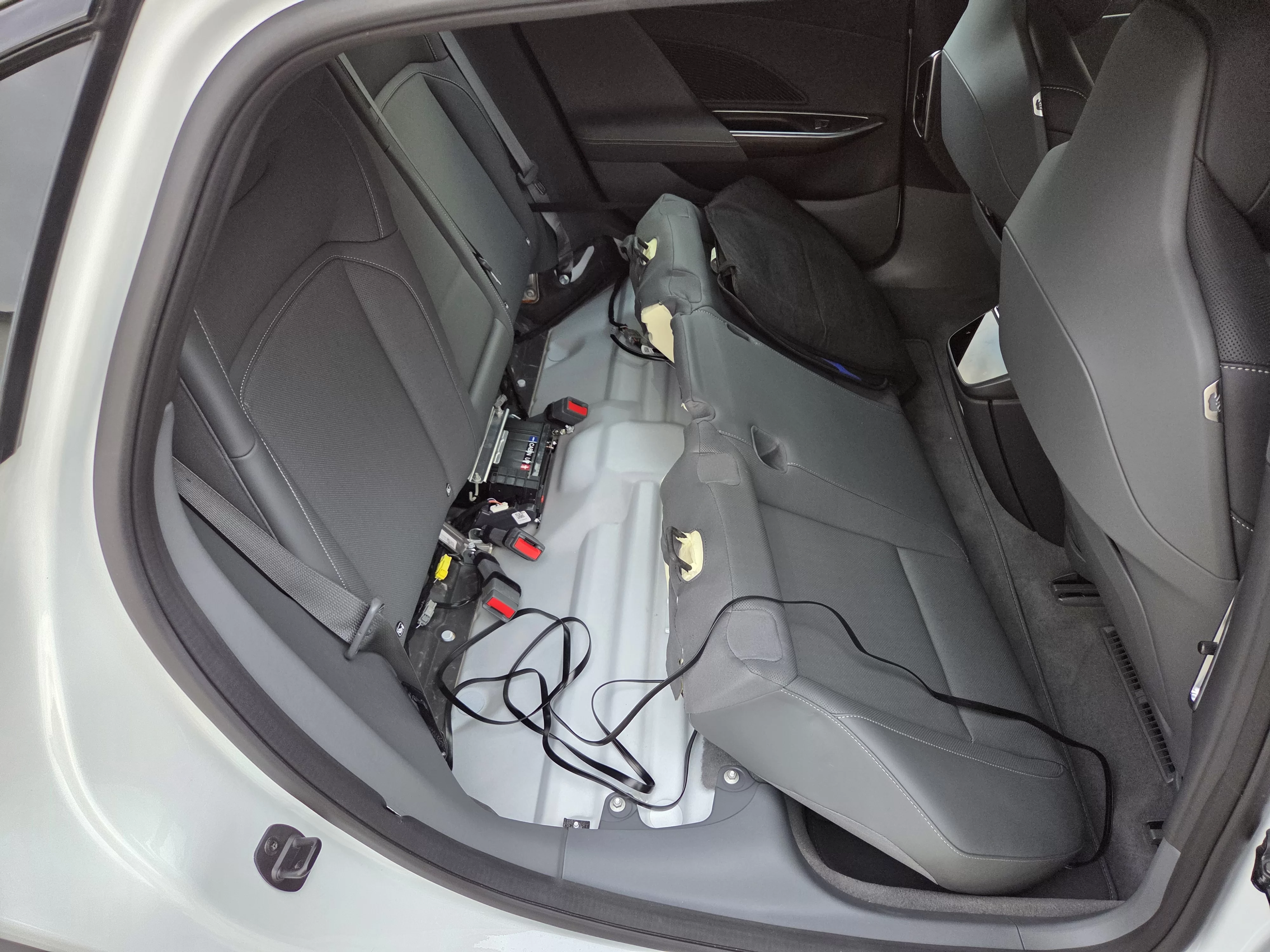

under the backseat is just one module, but i can't belive this is that expensive.
