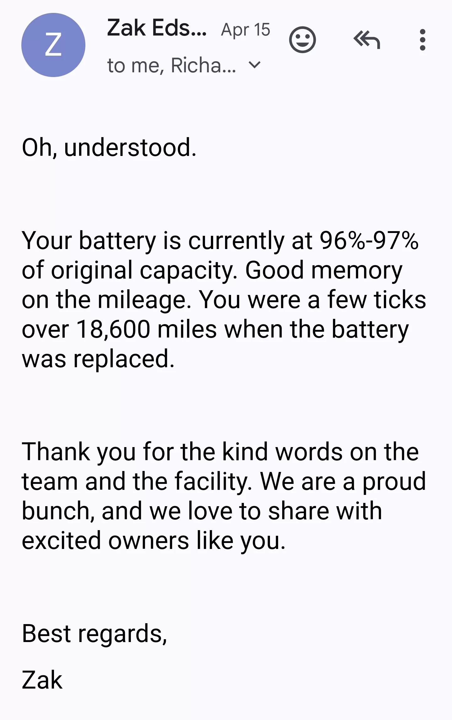

While meeting folk at King of Prussia, 2 weeks ago, I asked Zak Edison, extremely nice guy, about my battery degradation (car build 08/22, HV battery replacement @ 18,600 miles).
His response:
So, not to worry much, enjoy your Lucid.
