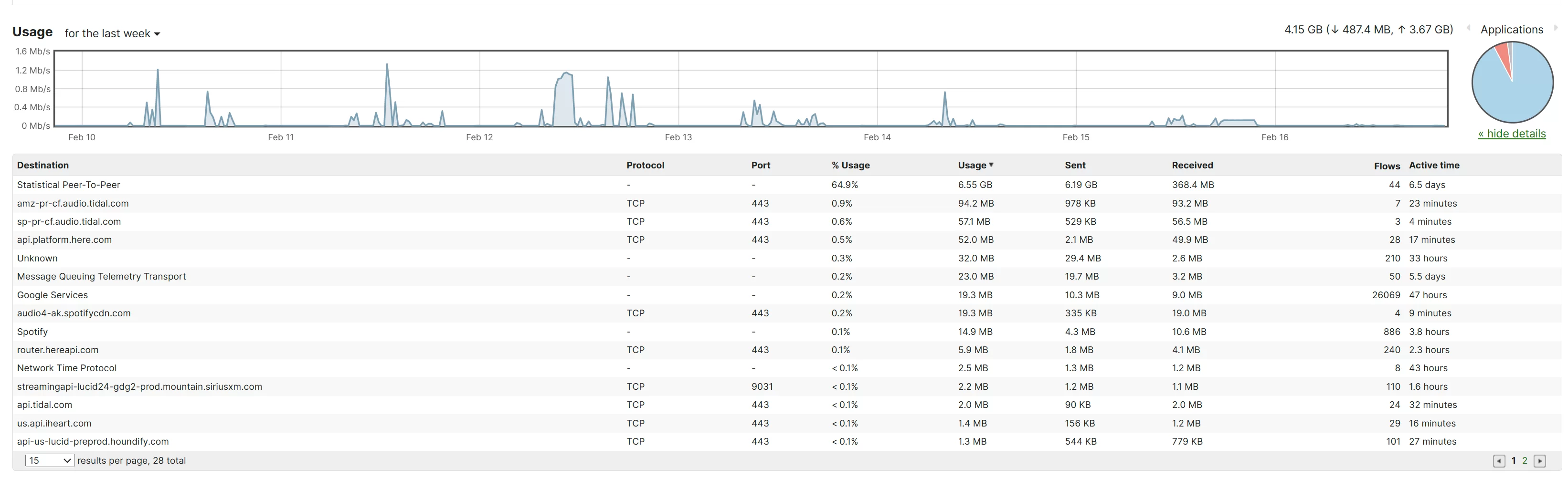

Is the car connected to your home network? If so, you could kind of see how often its turning itself on to the point its connecting to a music service. If you keep on seeing meaningful-ish data consumed ever 30 minutes you would know how often its turning itself on. Also, if the keys are truly that close all the time to the point where its unlocking itself all the time, the battery would die rather quick. I was doing this when I first got the car and the first bat only lasted maybe 3 months. This is what my car pulls a week and how often. If it helps.
