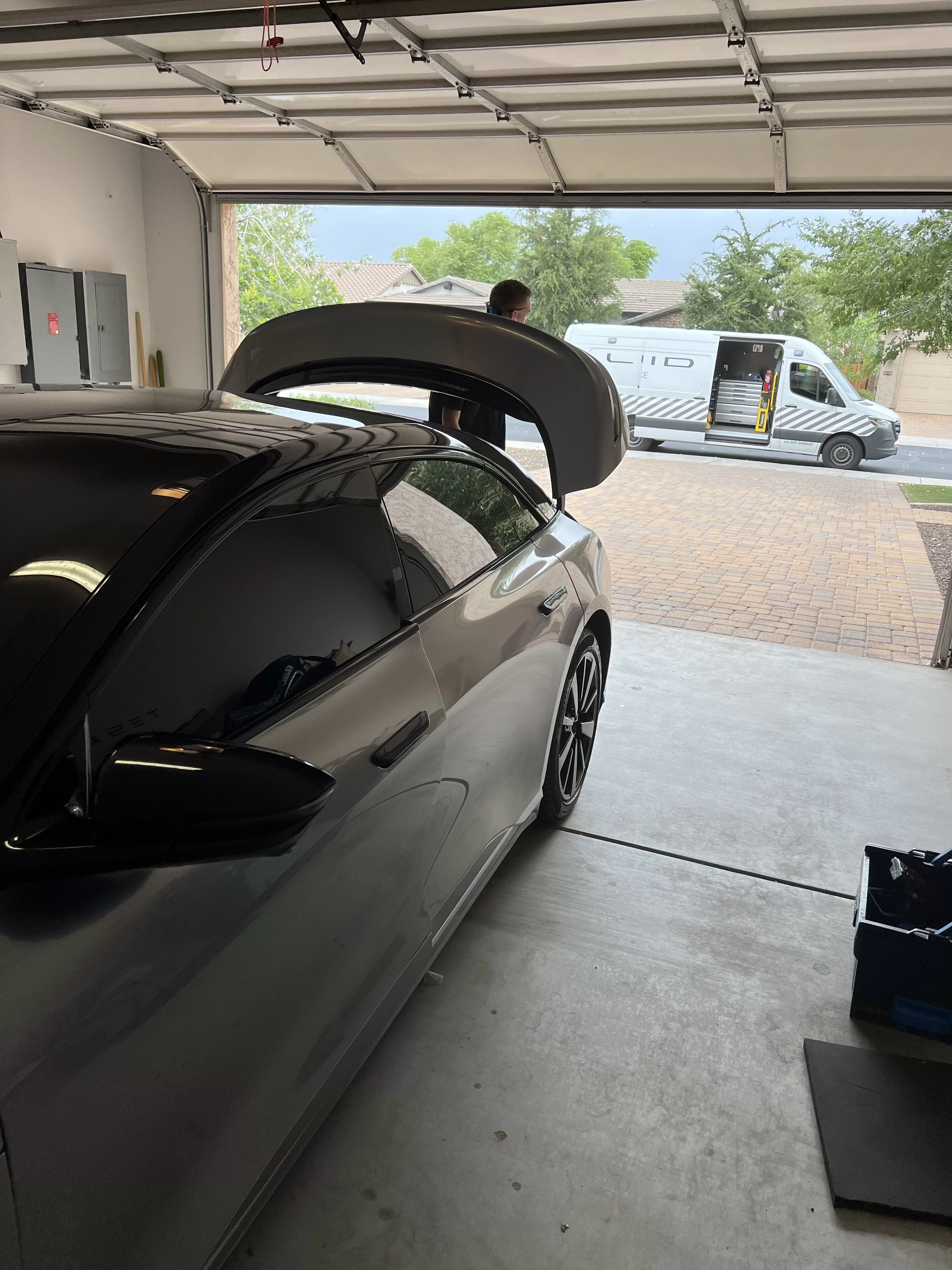

So curious on this I had the service people here yesterday and they said I need to make sure they program the set of wheels 🛞 and their new TPMs sensor and since I switched out of my Lucid. TPMs that when they switch back that I would have to reprogram again ie another service appointment. Soo is this our current state? Can the car still only handle 1 set of TPMS sensors could anyone confirm ?
Service photo for proof

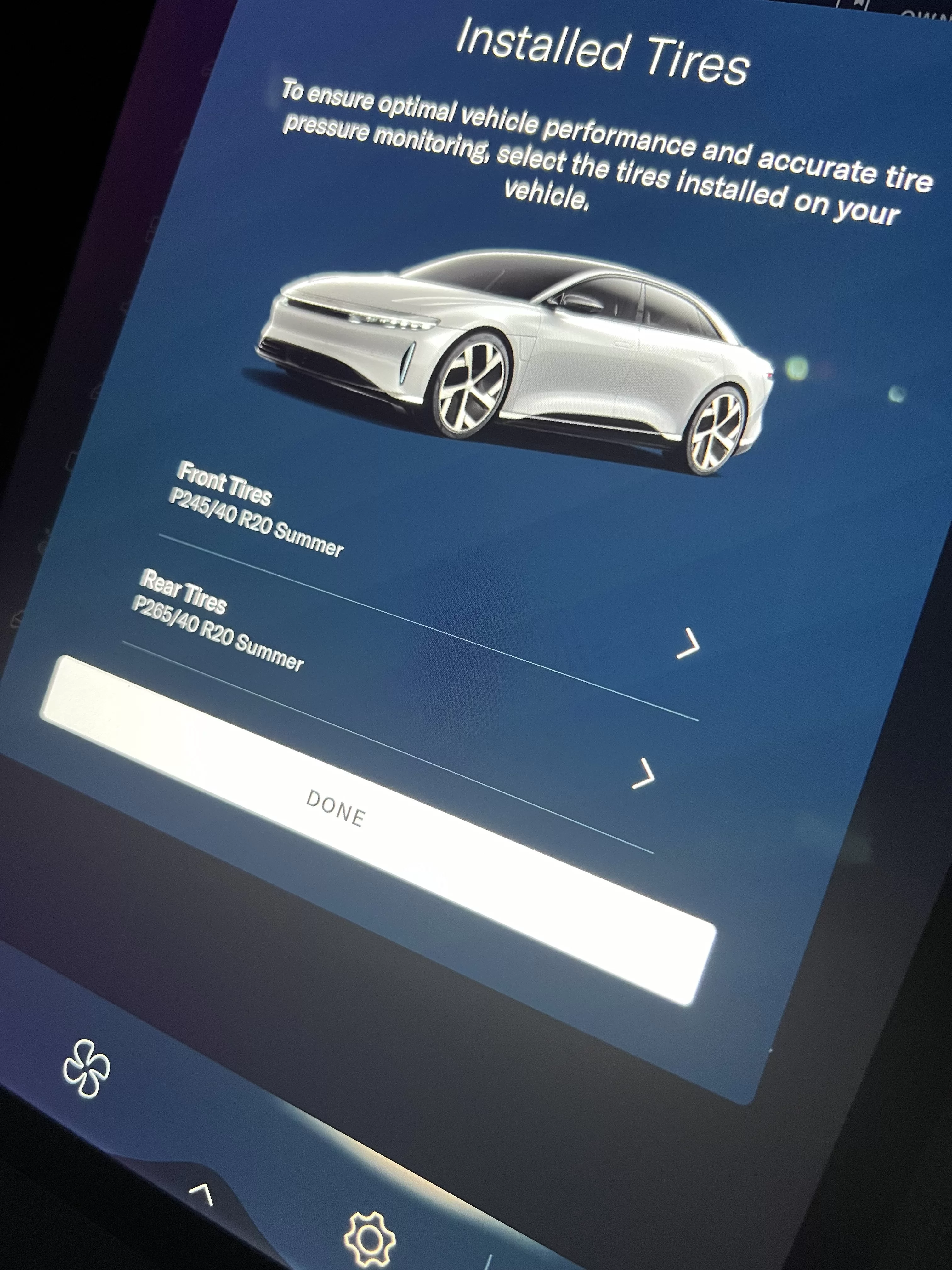

Arg I had service program the 19s yesterday and my 20s are currently getting powder coated can I tell the car I have the 19s now ??
What does it say on the screen?
So I got in the car and it still said 20s.
I updated to 19s so is your assumption that this is now saving this TPMs sensors under the 19 inch size and when I get my 20s back and installed I would change this back to 20s and everything will just work? Has anyone actually managed 2 sets of different TPMs sensors yet ??

View attachment 20847I updated to 19s so is your assumption that this is now saving this TPMs sensors under the 19 inch size and when I get my 20s back and installed I would change this back to 20s and everything will just work? Has anyone actually managed 2 sets of different TPMs sensors yet ??
When you tap the arrows, mine gives me the option to switch between 19s and 21s. Lucid needs to program it. If you tap the arrows, it only shows the 20s? If so, sounds like a quick service visit is in your future.

Assuming service has set it up for you once, you would go into that menu, tap the arrows, and select 20s. It’s not hard, assuming service has set you up.

Click the arrow, bro. Are there two options?

If your car ever had the 21s on it, it would work. For example, mine lets me pick between the 19s and 21s, but that’s because I had used both and both had been setup previously. Mine doesn’t show the 20s because I’ve never had them on the car.
