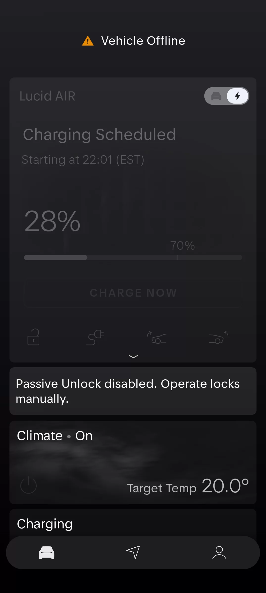

I too first noticed this issue today and am on 2.8.16. Here is a screenshot of the Android app. Passive unlock with my phone worked fine along with all else. But at home when I turn off passive unlock I had to use the key fob, which I never carry.

On your screenshot, I saw your 20 degree target temperature and thought 'Is this guy part penguin?'. Took me a minute to figure out it's Celsius. Such is life when you live 1k+ miles south of Canada.
