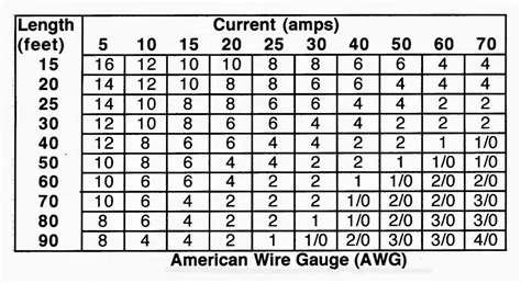

length of run is important = you got that right.

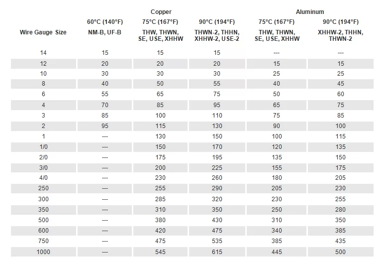

Looks like #2 copper is plenty for 50 foot run using the Lucid wall charger at full 80 amps (if it's torqued correctly and the breaker is correct).
