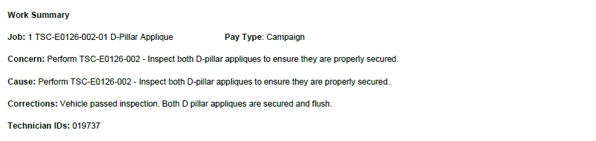

There is a TSC campaign for that one that I had a done by mobile service.

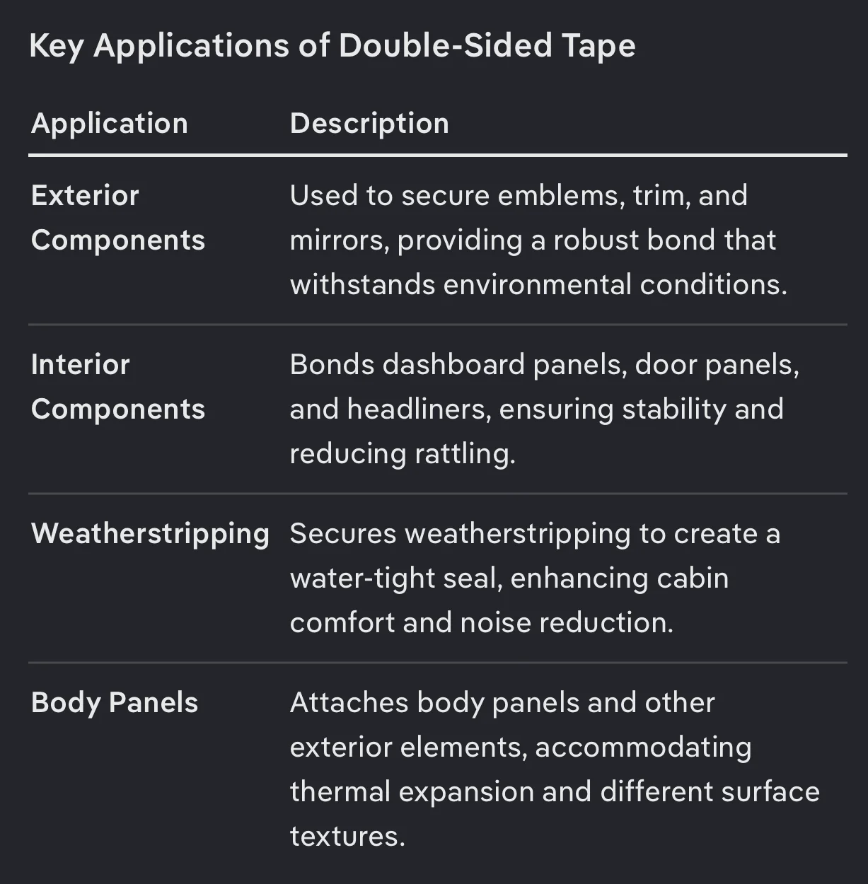

There is also a LOT of two sided tape used on these cars. A problematic amount.
Use of Double-Sided Tape in Automotive Manufacturing​
Automotive manufacturers increasingly rely on double-sided tape for attaching various vehicle components. This method is favored for its strength, durability, and versatility in bonding different materials.
Advantages of Using Double-Sided Tape​
  • Strength and Durability: Offers a strong bond that can endure various weather conditions.
  • Versatility: Effective for bonding dissimilar materials, including plastics and metals.
  • Efficiency: Speeds up the assembly process compared to traditional hardware like screws and bolts.
Double-sided tape has become an integral part of modern vehicle assembly, contributing to improved production efficiency and vehicle performance.
Nice. I like it when facts are used to counter negative conjecture from a single data point.
Or lazy Chat GPT. There is double sided tape in too many places that should have a fastener, I imagine for cost and time savings purposes. They’ll sort it out.

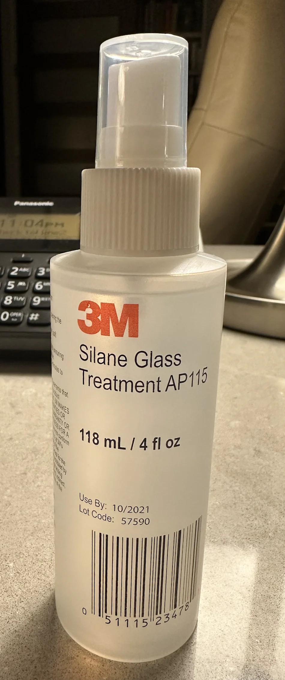

When our house was built almost ten years ago, the window contractor used a specialty 3M VHB tape to attach aluminum muntins to our glass windows for the "le Corbusier" look we wanted. A decade later -- through Florida heat, humidity, sunshine, and 5 hours in the eastern wall of Hurricane Irma -- every muntin is still in place. In fact, when a mower cracked a window by throwing a rock at it a few years ago, we had to purchase a special tool to pry the muntins off in order to reattach them to the new window.
However, some surfaces require that a special liquid be applied to ensure adhesion. (In our case, it had to be applied to the glass but not to the muntins.) I wonder if this is the step the assembly line might have muffed.
This is the treatment we had to use on our windows:
3M makes a wide variety of VHB tapes, each for very specific applications. And different surface treatments are required for different materials. This is why I wonder if there was some flub in Lucid purchasing or assembly where the wrong tape and/or surface prep compound made it onto the cars affected by the recall.
As some posters have said, there is nothing wrong in principle with using tapes and other adhesives in automobiles. But the chemistry and mechanics are very complex, and the materials used have to be carefully matched to the application.
