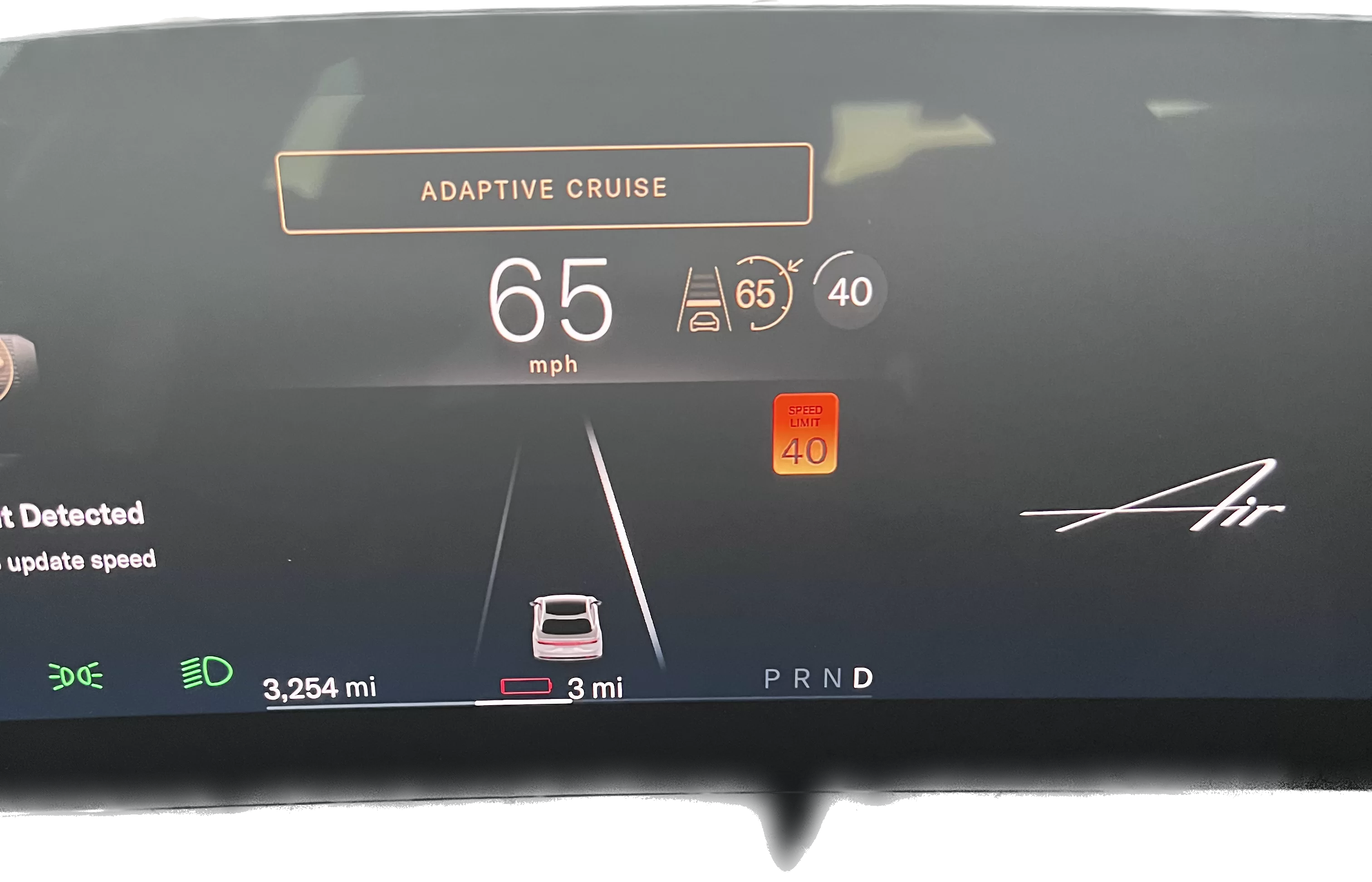

Bummer ... more importantly that 41 miles of range left is starting to make my butt cheeks clench. Hopefully you were on the way to a charger!
That's plenty of range..... how about this 😂
... and I was only 7 miles away from charger 🙂
