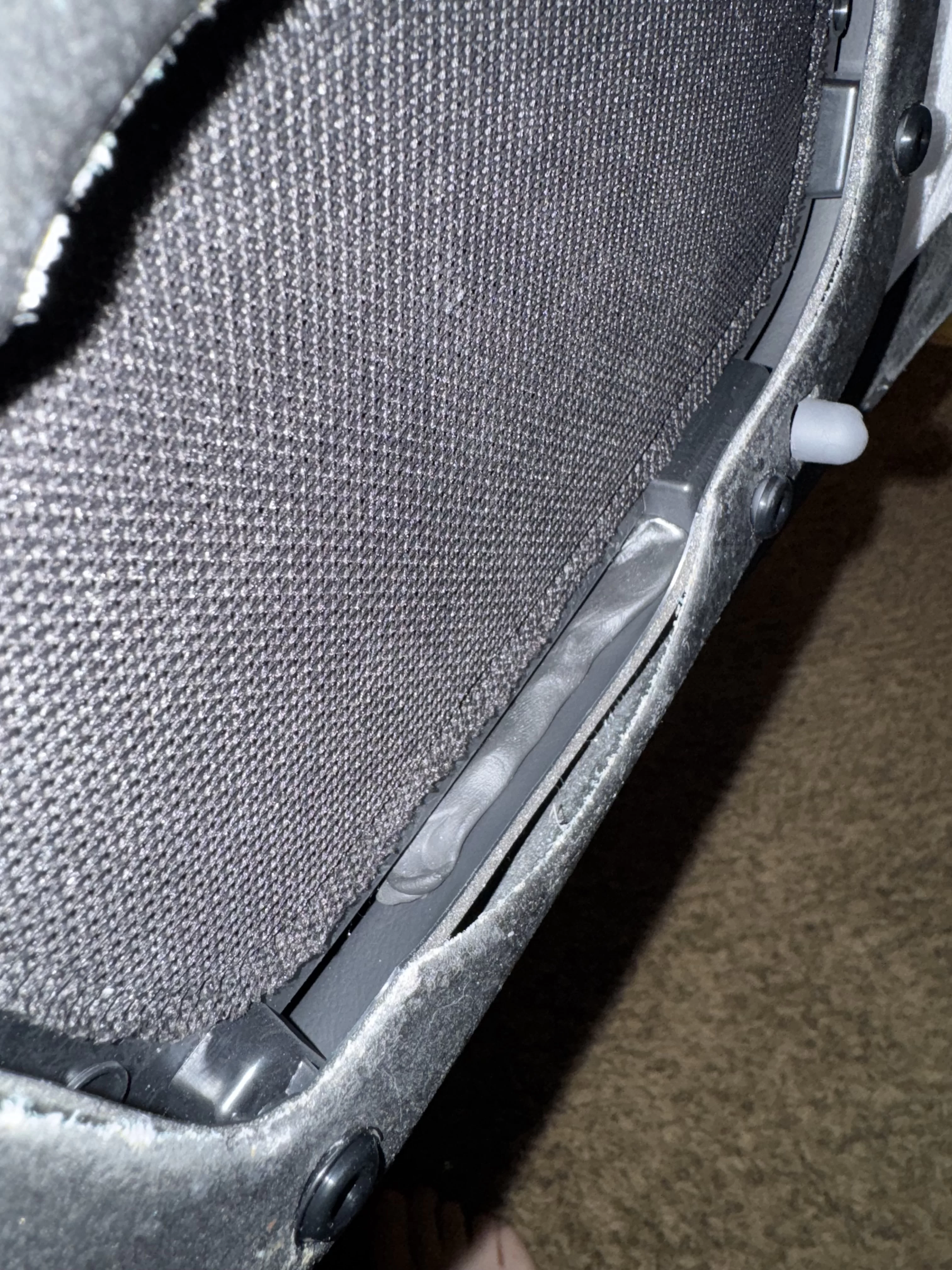

Problem 1 (biggest issue): the speaker grilles are not molded into the shelf. Instead they are an insert that are riveted. This causes the edge of the grill to vibrate against the edge of the cutout, causing rattles. See below:
You can fix this using “butyl rope”. You MIGHT be able to do this from the top of the panel by rolling a small rope of it and wedging in there, but it’s easier from the bottom.
To remove the shelf, fold the seats down, pop the panels off the side seat belt covers, then pop the rear shelf straight up. Pull it out, halfway reach under and disconnect the plug for the (I think) glass break sensor, which is the square hole you saw in the picture.
Flip it over. You will see the gaps, and you can hear the rattle by tapping on the grills. There are three grills.

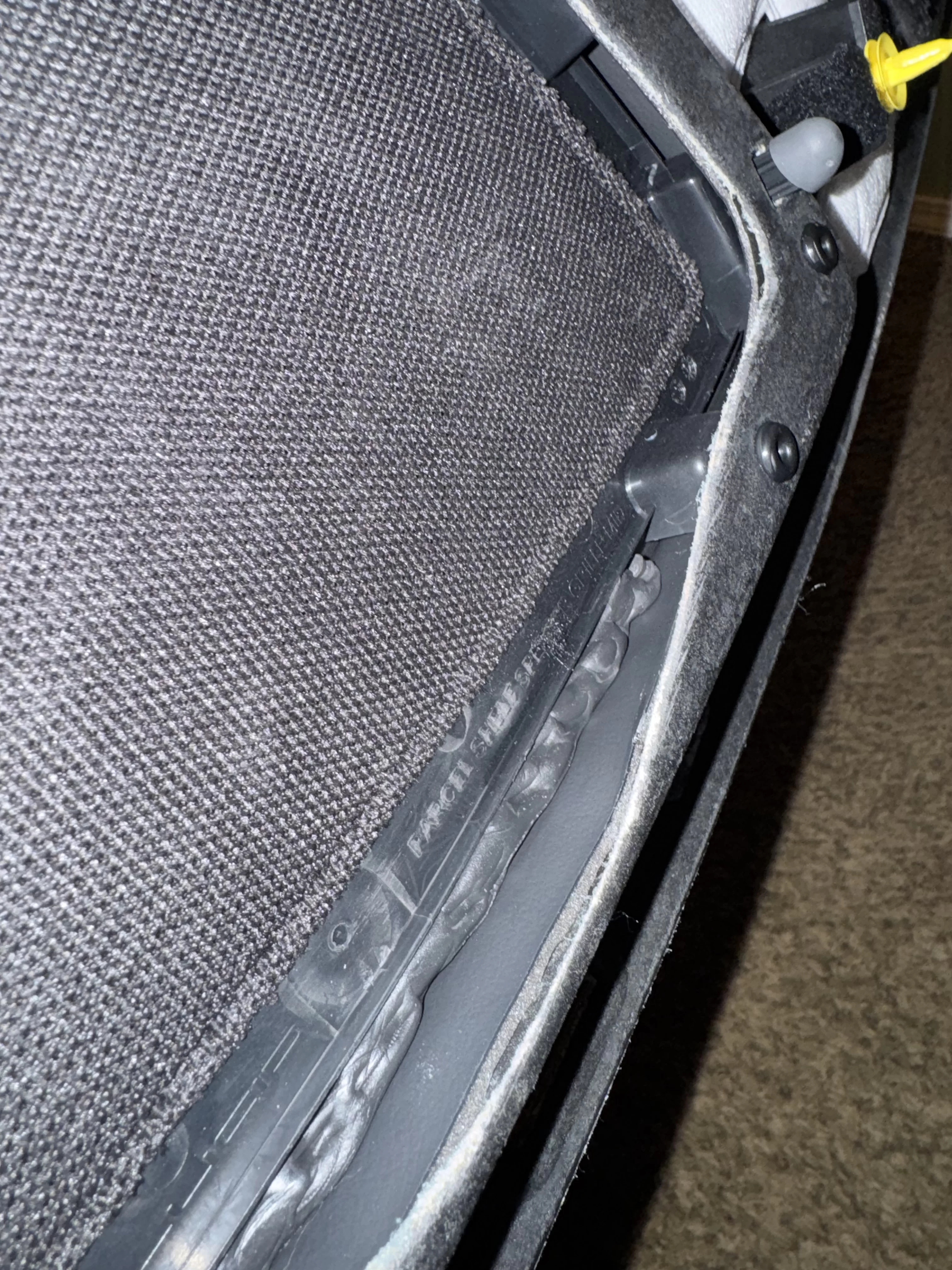

On the back, apply the butyl rope with your fingers and push in with a flat tool of your choice. As below:
Press in to fill the little gap:
Do a few inches in the edges of all 3 on all 4 sides. Tap the grills. You should hear a dull thud instead of the rattle. You have now fixed the problem.

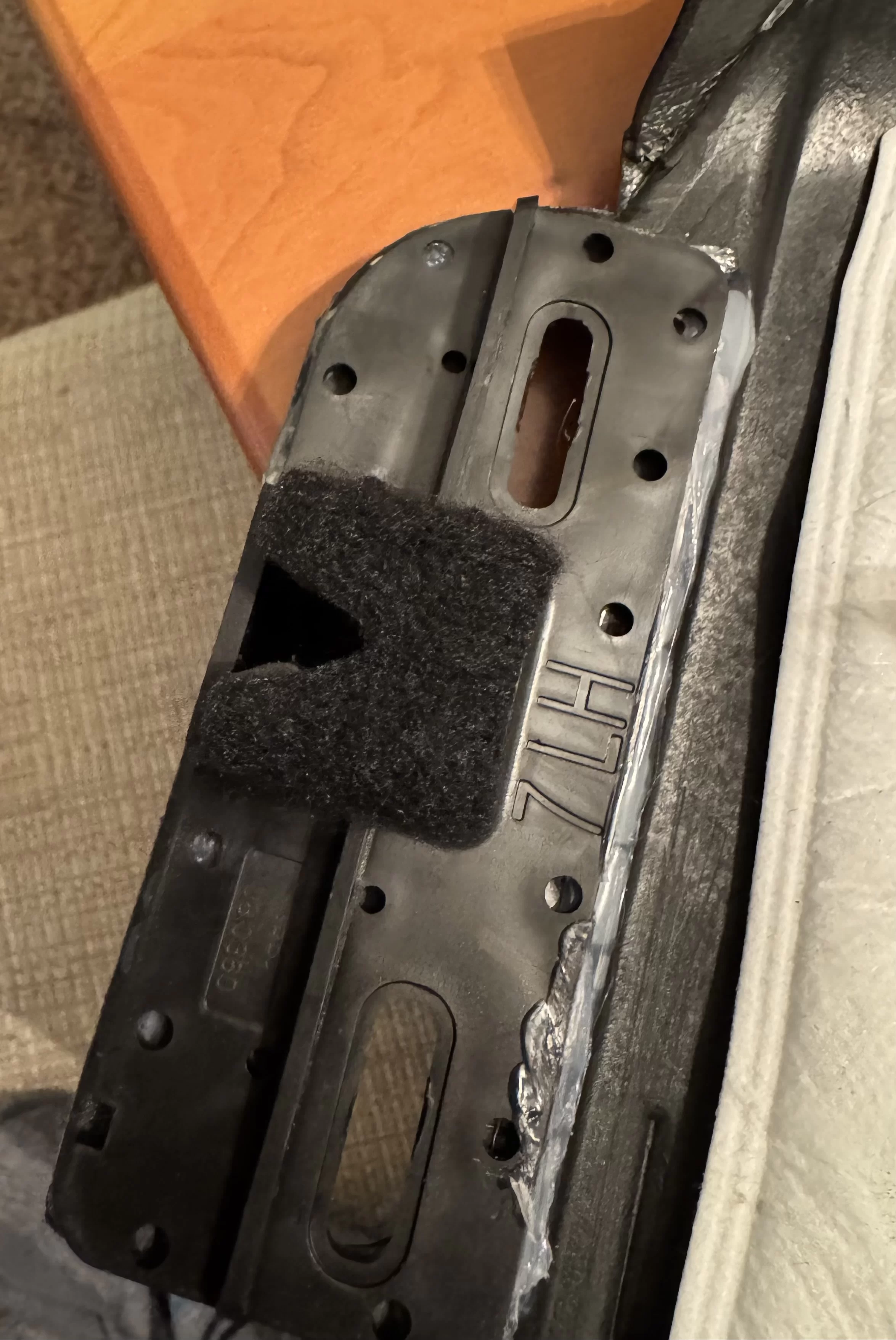

For bonus points: there is also some rattle around the 6 yello panel clips because they are slightly oversized for the attachment points. Pop them off, cut a V in some felt tape, apply tape and pop the yellow rivets back on.

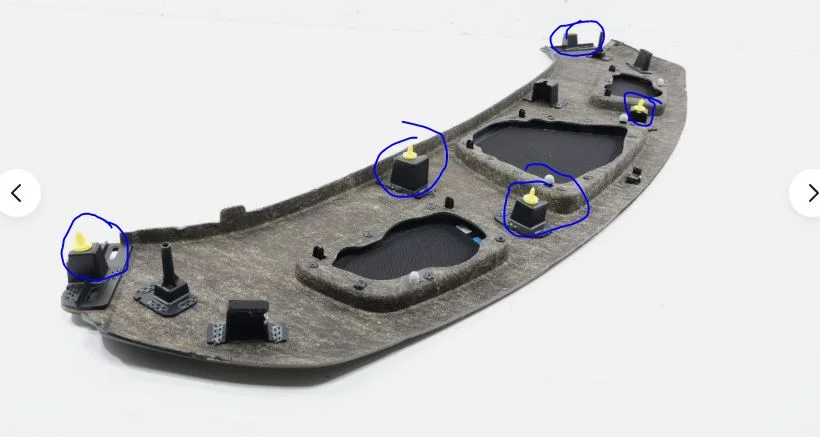

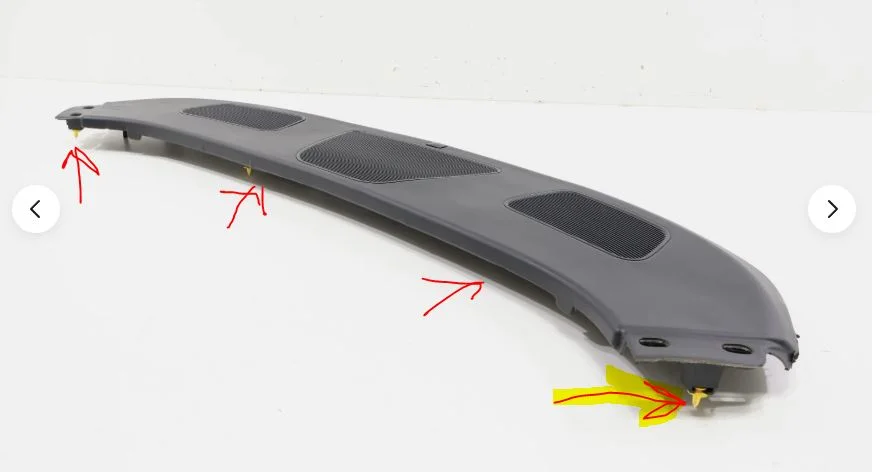

A forum member reached out while working on this and I realized I never put any pics of the actual connections, so here goes!
Here are some updates pics on where to start, and what you're going for. The red is where to start popping, on the backside you can see the rivet locations.
On the 26's, there is a foam block on each side for anti-rattle, and I think a couple more clips. But the idea is the same.
View attachment 39553View attachment 39554

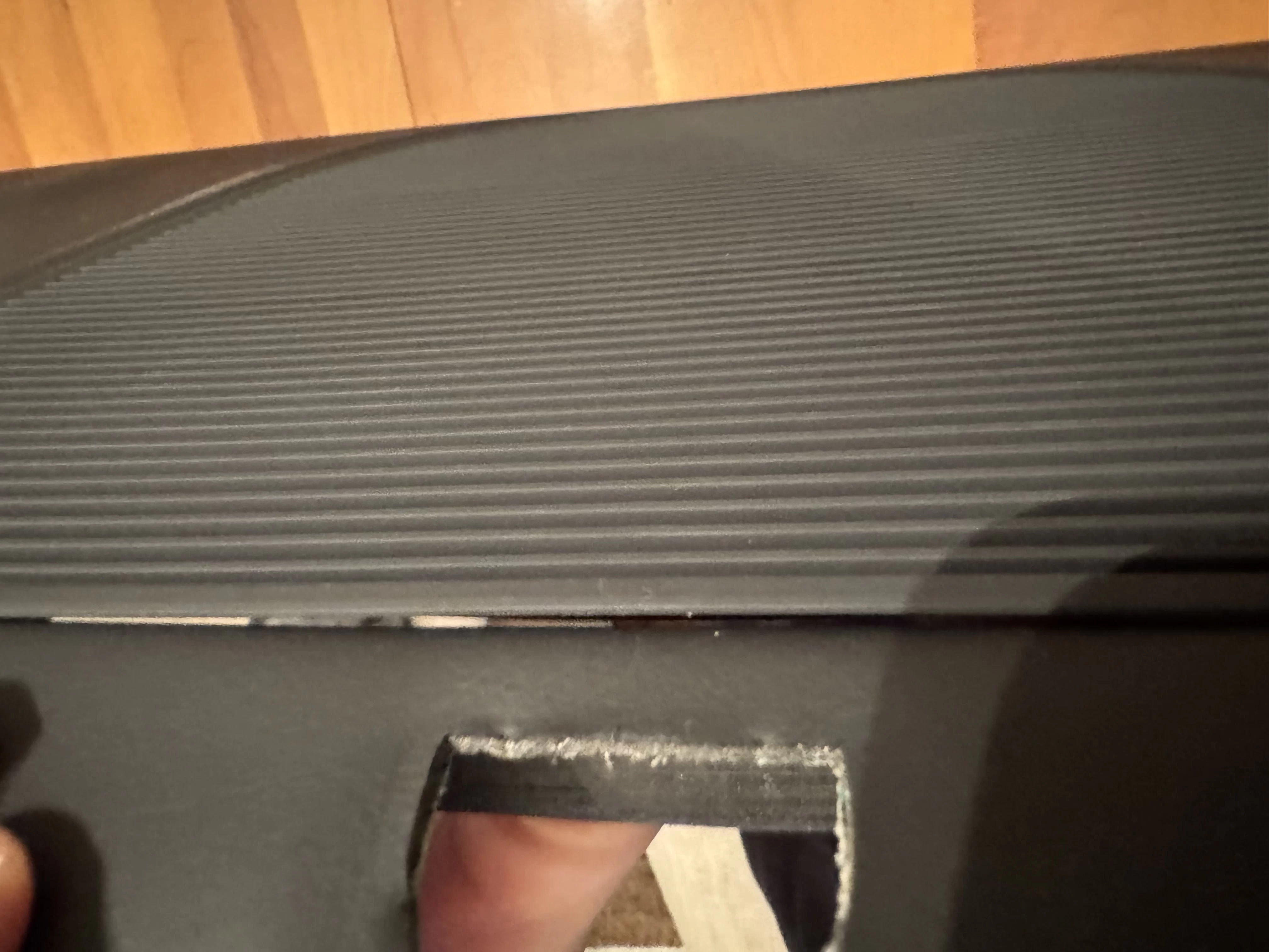

I tried this process today on my 3/23 build AGT. While I'm very grateful to socktucker for the walk through - I want to caution anyone reading this thread that this process is not as easy as this thread makes it seem, and is potentially distructive. Perhaps this is straightforward for a professional, but I cannot recommend to a trim removal novice.
I have a full trim removal kit, but it is rendered mostly useless since there is no visibility under the shelf when removing. When trying to pull up the panel, three of the fasteners were so tightly inserted that the bracket holding them to the shelf sheared off and needed to be carefully reglued. Several fasteners snapped in half. It's seemingly impossible to remove the shelf from the car without bending it or removing considerably more C pillar trim. But the hardest part is reattaching it - with the bending inherent during removal, getting the clips to line up with the holes in such tight quarters with limited visibility is absurdly challenging. And then, you need to put an incredible amount of force to get them to pop in, and at an extremely challenging angle. The whole process took about 3 days including glue time and acquiring replacement fasteners, probably about 4 man hours of actual work.
