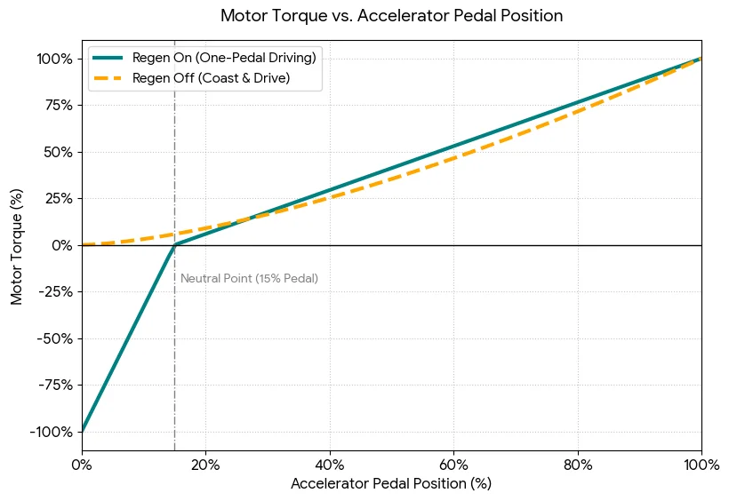

Technically, the accelerator position is for torque delivered and you are correct in that acceleration/deceleration depends on speed. Increasing speed requires more torque to maintain speed due to drag. We cannot accelerate forever at a given pedal position.
You identified the reason for the different pedal mapping with regen on vs off - the pedal range needs to cover different torque delivery profiles. Here is another way of looking at it. What is the zero torque point with regen off vs. on?
  • With regen off, the zero torque point is always at zero pedal press. Any amount of pedal press applies positive torque (accelerate until drag equals power).
  • With regen on, the zero torque point is at some non-zero pedal position. This is what enables one-pedal driving. The pedal is being pressed, yet the torque is zero. Releasing the pedal slightly applies negative torque, slowing you down.
  • This zero torque position in the full-regen case always maps to some positive torque in the no-regen case. Also, the negative torque positions don’t exist in the no-regen case. The mappings must be different between regen and no-regen.
An illustration (curves are not real, example only):
There is one additional nuance. The mapping is dynamic with regen on. The zero torque point changes based on speed (only for regen on, not for regen off). This is why the car applies positive torque/acceleration even with a slight pedal press when stationary vs. negative torque/deceleration) at highway speeds at the same pedal position (in the regen on case).
One could argue that the right hand side of the curve should match with regen on vs. off when the graphs intersect, and perhaps that’s what the Mach-E and other cars with low regen and acceleration have achieved. Maybe this intersection point with the Gravity, which has very high deceleration/acelleration, is so far to the right that it occurs at speeds higher than typical highway speeds or does not intersect until 100% (imagine a straight line between 0-100% pedal position for the no-regen line). Maybe matching was attempted but resulted in an unnatural pedal feel at the matching transition point and was abandoned. We’d have to ask Lucid to get more insight.
There is one additional nuance. The mapping is dynamic with regen on. The zero torque point changes based on speed. This is why the car moves forward with even a slight pedal press when stationary vs. slows down at highway speeds at the same pedal position.

Yes, with regen off, the zero-torque point is always at zero pedal press and doesn’t change. It only changes with regen on. I clarified and edited my post - thanks for pointing that out!

Yes, that's what regen is - negative torque, to decelerate the car when lifting up on the accelerator pedal. Your chart is a good visualization to show the effect of regen on the car's speed.
How they choose to map it to the accelerator pedal is a different matter though. They likely *could* map them equally for the amount of positive torque being applied at any point in the curve (as is done in the Macan), but perhaps it is the stronger regen in the Gravity that drove them to use significantly disparate positive torque curves, to give them more "runway" (so to speak) for the driver to modulate a wider range of regen.
Although as you said, it's not a fixed point anyway, it's dynamic, so I suppose this all could be moot. It's not just the bottom 20% or 40% of the pedal range where regen applied when you begin to lift up on the pedal, it's the entire range of the pedal. If you're 80% of the way down and start to lift up, you get regen there too. But when you're only 20% of the way down, you still want enough room to modulate so maybe they pushed that lower end higher? No way to know what their thinking was, but it's fun to speculate. At minimum we do know that such strong regen does need a lot of pedal runway to modulate. If anything, I'd say the Gravity could use MORE runway in the pedal. A very tiny movement makes a big difference (in both positive and negative torque) so you have to be more precise than, for instance, our Macan, which has both a softer pedal and more room to modulate speed.
