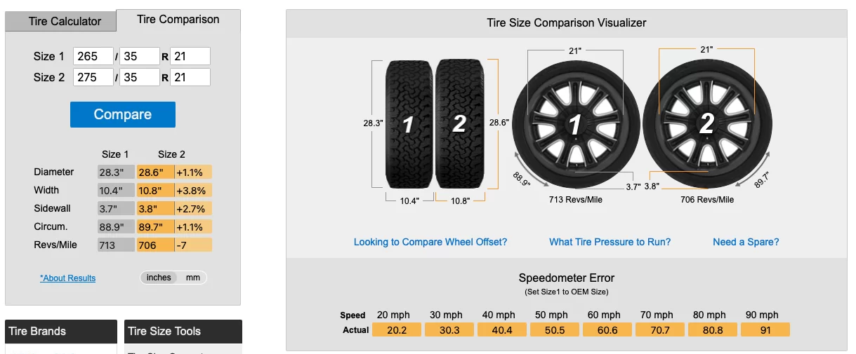

From the tiresize.com calculator, the tire differences in sizing are (Size 1 is stock and Size 2 is the Hankook SUV):
Does anyone think that using the Hankook Ion Evo AS SUV tires would make a good compromise? It's only off by a little on load and only the front tires are lower speed rated, but the touring can't get close to that speed anyway. The actual tire sizes differ a little, but would the difference be problematic? Will the increased width cause rubbing? Is the W speed rating is realistic concern?
