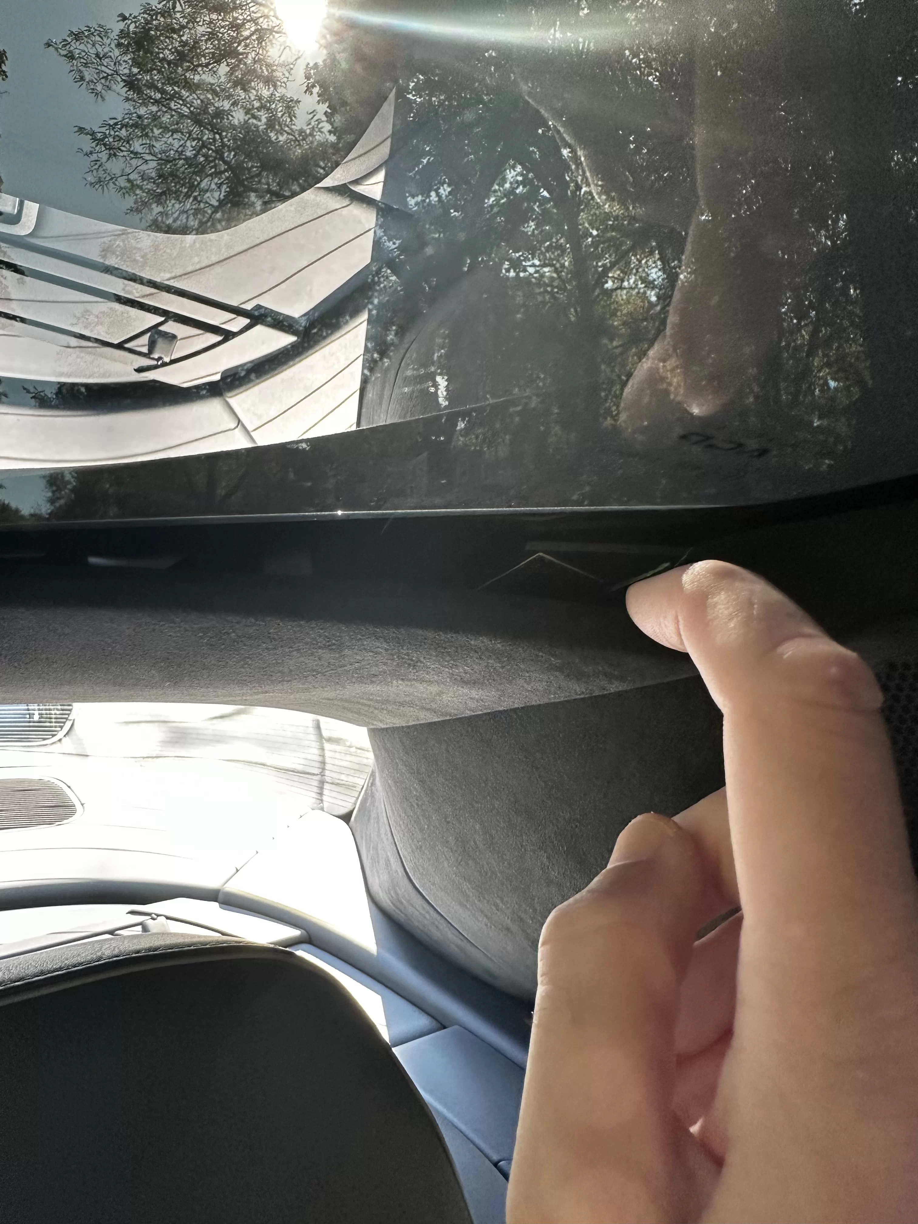

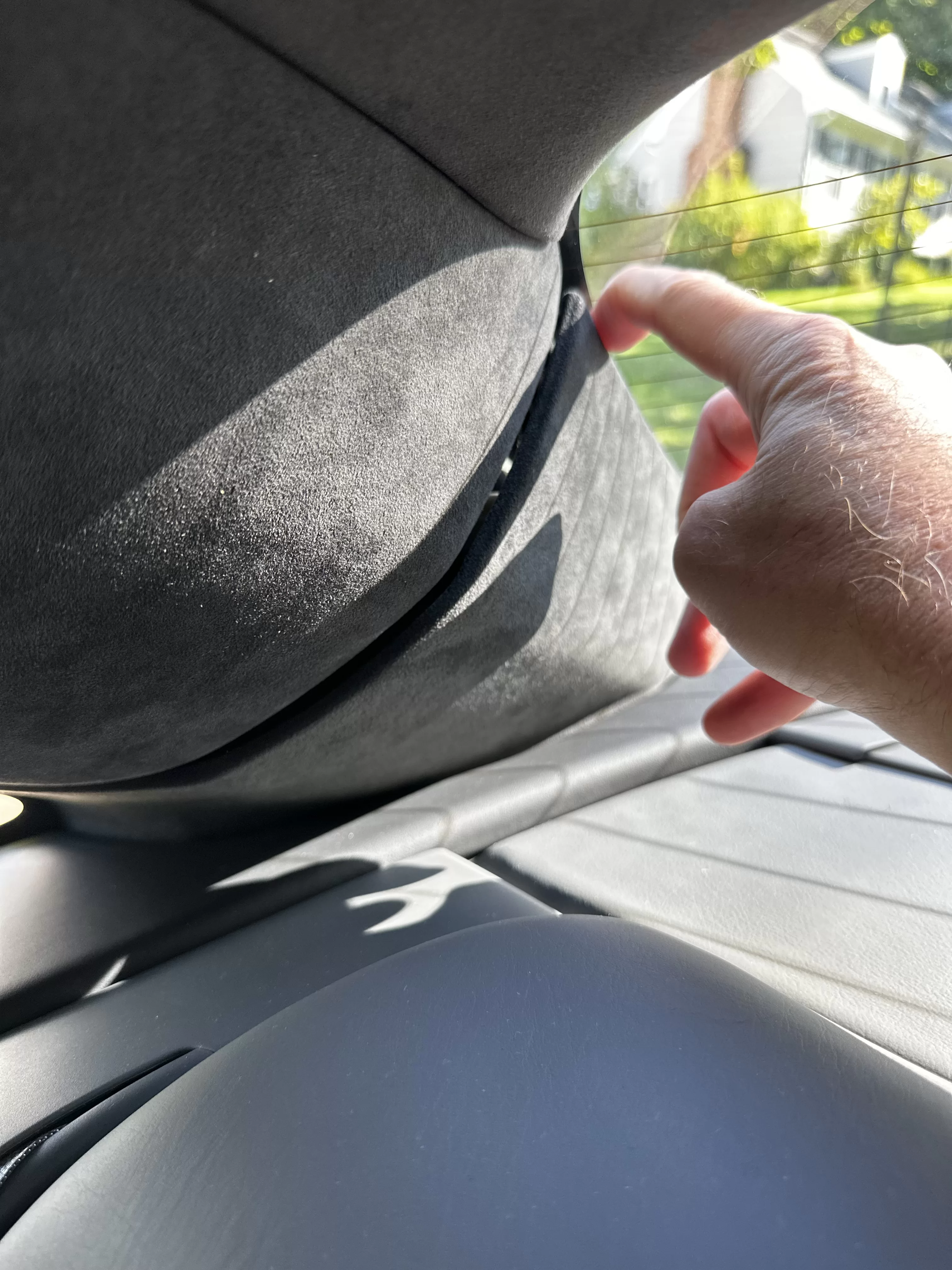

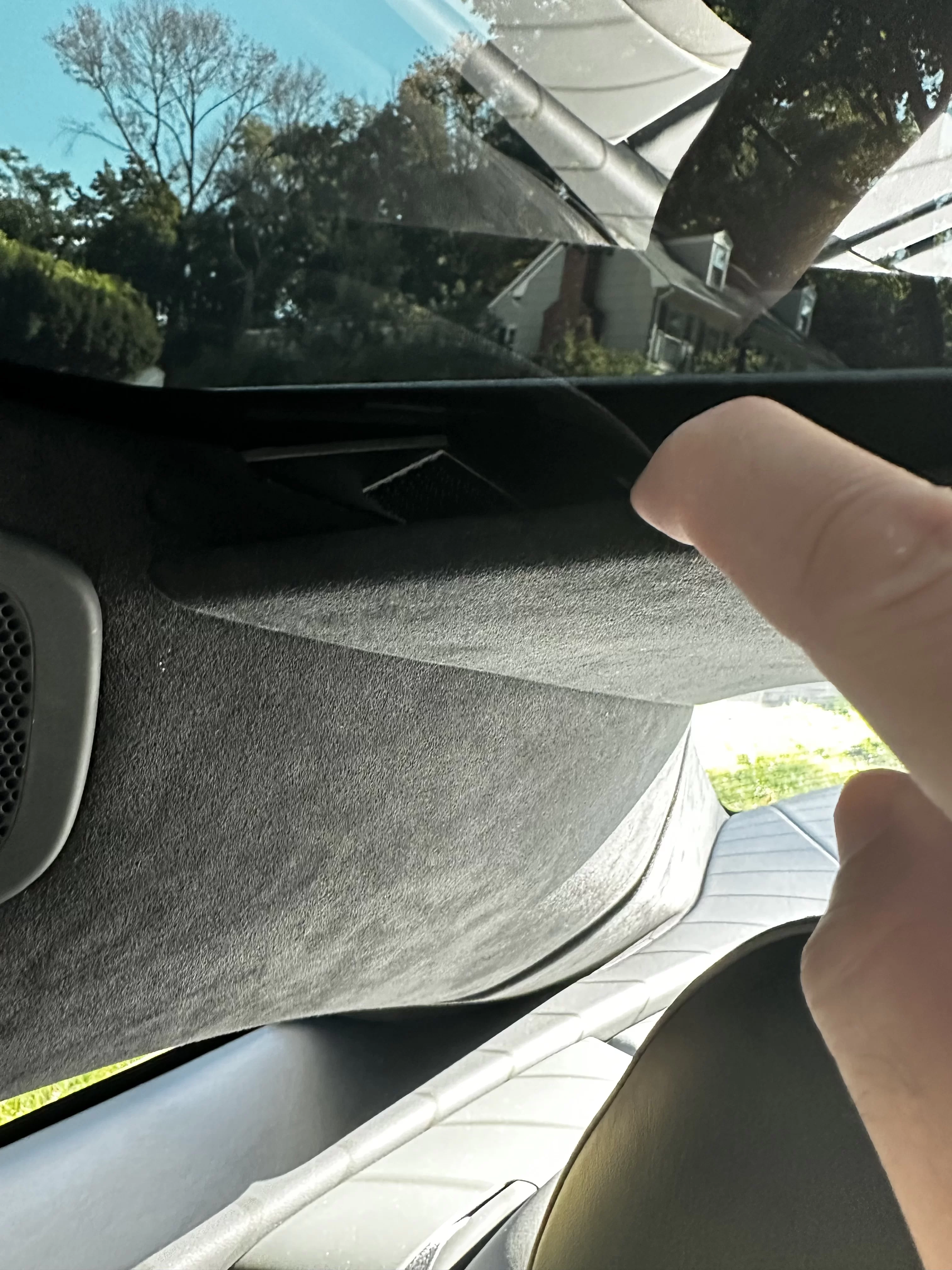

Multiple loose pieces - see pics
Looks like the tape for holding the trims is not strong enough. Or maybe they are not heat-resistant. My carpet dinner in the trunk also fell apart, probably due to heat.
I think it might actually be Velcro . Felt like it but not sure.
I’ve taken out the rear headliner trim piece to evaluate this, as mine didn’t fit great. It’s held in place by the plastic “mushroom head” fastening material, not Velcro. When pressed together it is a strong bond. The issue I’ve seen is the mating surfaces of the headliner and roof or C-pillar are not positioned closely enough together to enable the fasteners to really stick together. Adding a layer of 3M auto trim tape (which is thick) under the “mushroom” strips helped in the two forward/outward spots. For the other locations I replaced the OEM fastener strips on the headliner itself with new 3M strips, and filled the raised “platforms” those strips are mounted to with epoxy, creating much more surface area for the adhesive backing to stick to. The headliner is solidly mounted now, though I don’t like how I can see a bit of the top side of the headliner (white plastic) when looking from outside the car. You have to look for it, but it’s not perfect.
