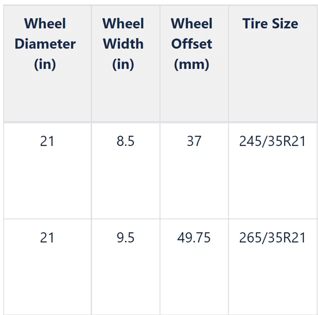

I was able to finally get the measurements for the 19" and 20" wheels from Lucid as I'm looking into possibly buying aftermarket wheels. I haven't found these posted elsewhere on the forum, so I thought I'd share them:
19s - new gen
-Dimensions: 19X8
-Weight: Approx 40lbs?
-Offset: 40mm
-Bore: 63 1/2mm
-Bolt Pattern: 5x120
20s Front
-Dimensions: 20X8.5
-Offset: 37mm
-Bore: 63 1/2mm
20s Rear
-Dimensions: 20X9.5
-Offset: 49.75mm
-Bore: 63 1/2mm
I'm guessing all the wheels are lighter than listed because I had previously found out the weight of the 21" wheels:
21" front 36.5 lbs & 21" rear 37.5 lbs
Hope these measurements help!
