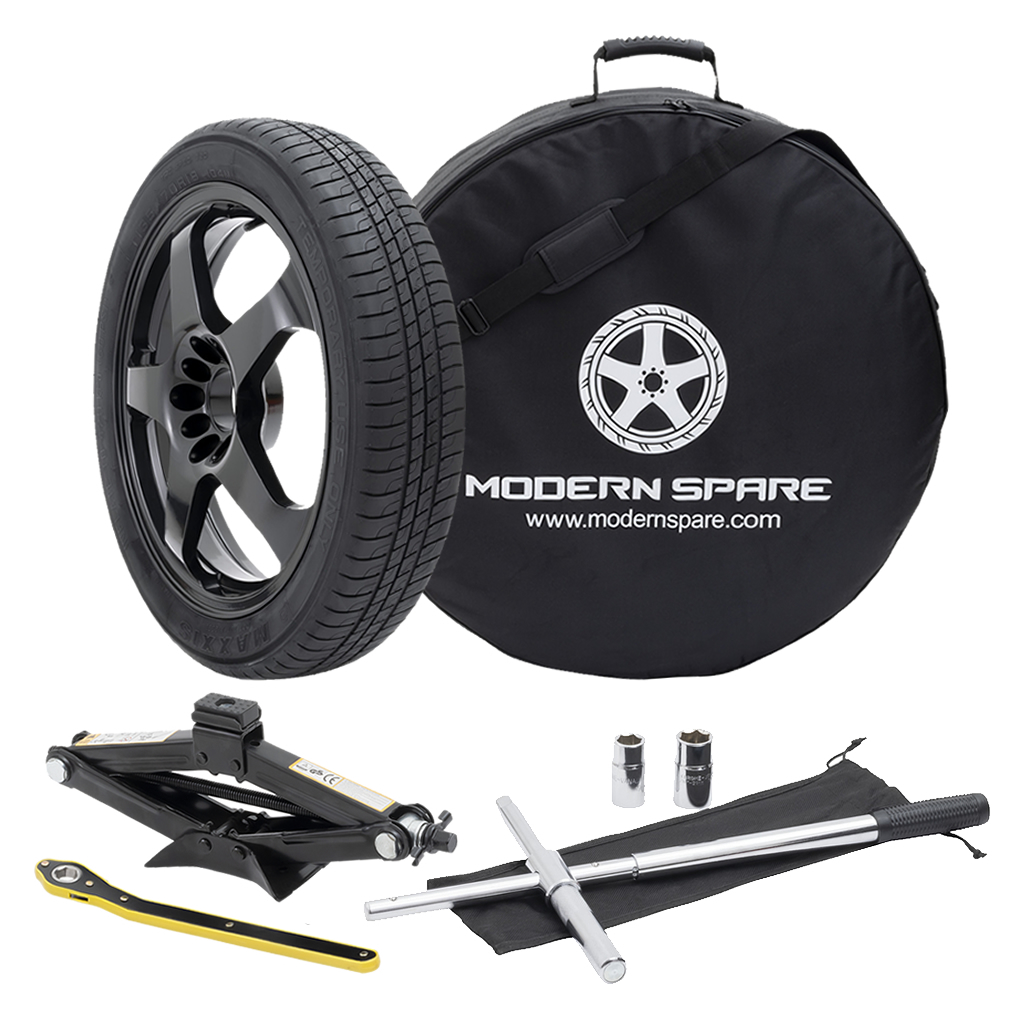

I have a Modern Spare that I used when my 21" took an arrow to the knee pothole to the sidewall. After that, I swore never again with low-profile tires in California and switched to the 19" with the stock all-season tires. The all-seasons have barely lost air in six months, and worked just fine driving through semi-plowed roads in South Lake Tahoe.
