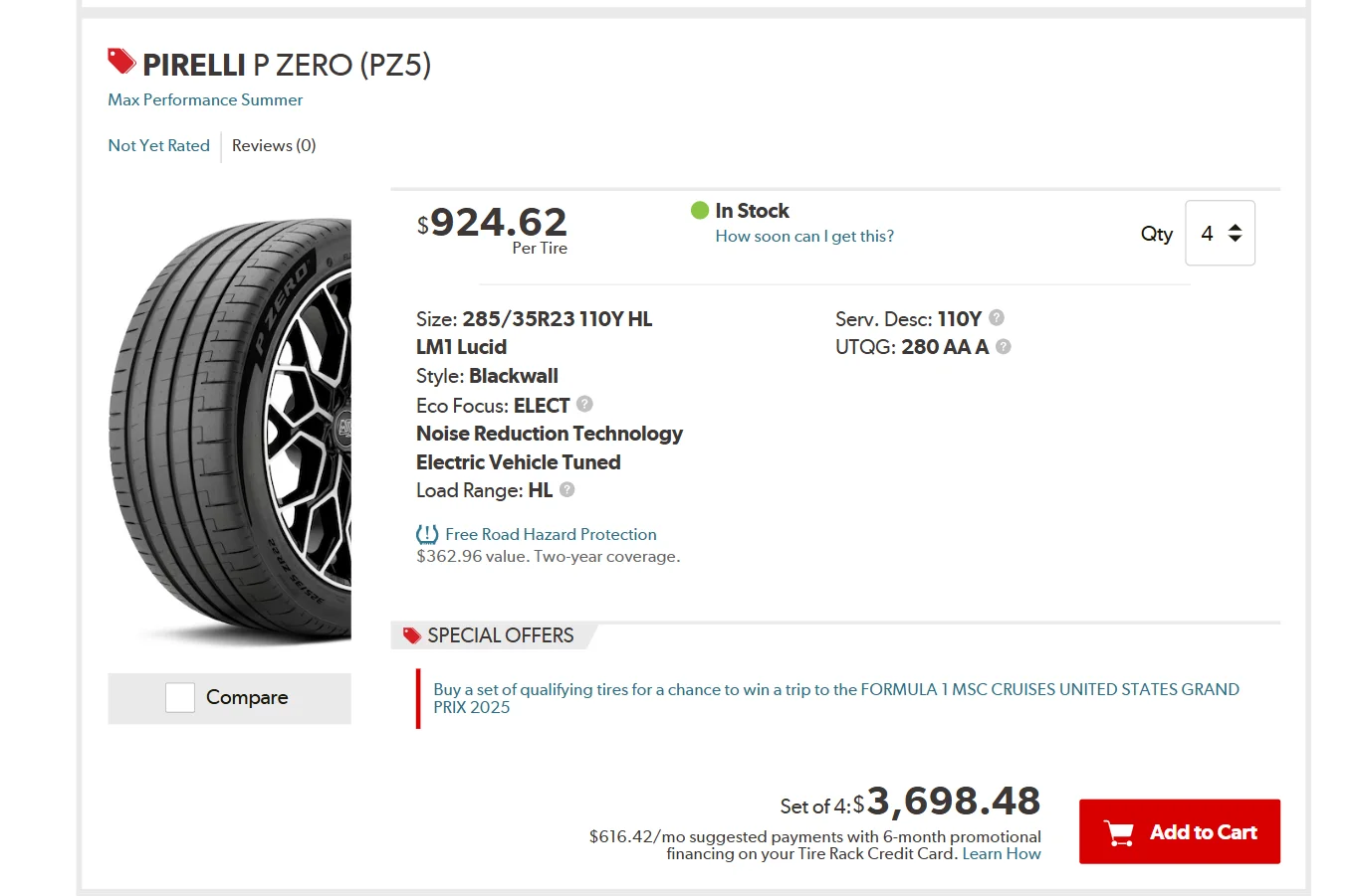

After I look close up to the website and some youtube video, here's the spec:
Front 265/40/22 22x9.5
Rear 285/35/23 23x10
And check this out... whopping $924.62 per tire for the 23" !! (Front tire listed at $554).
$3000 for tire replacement.!

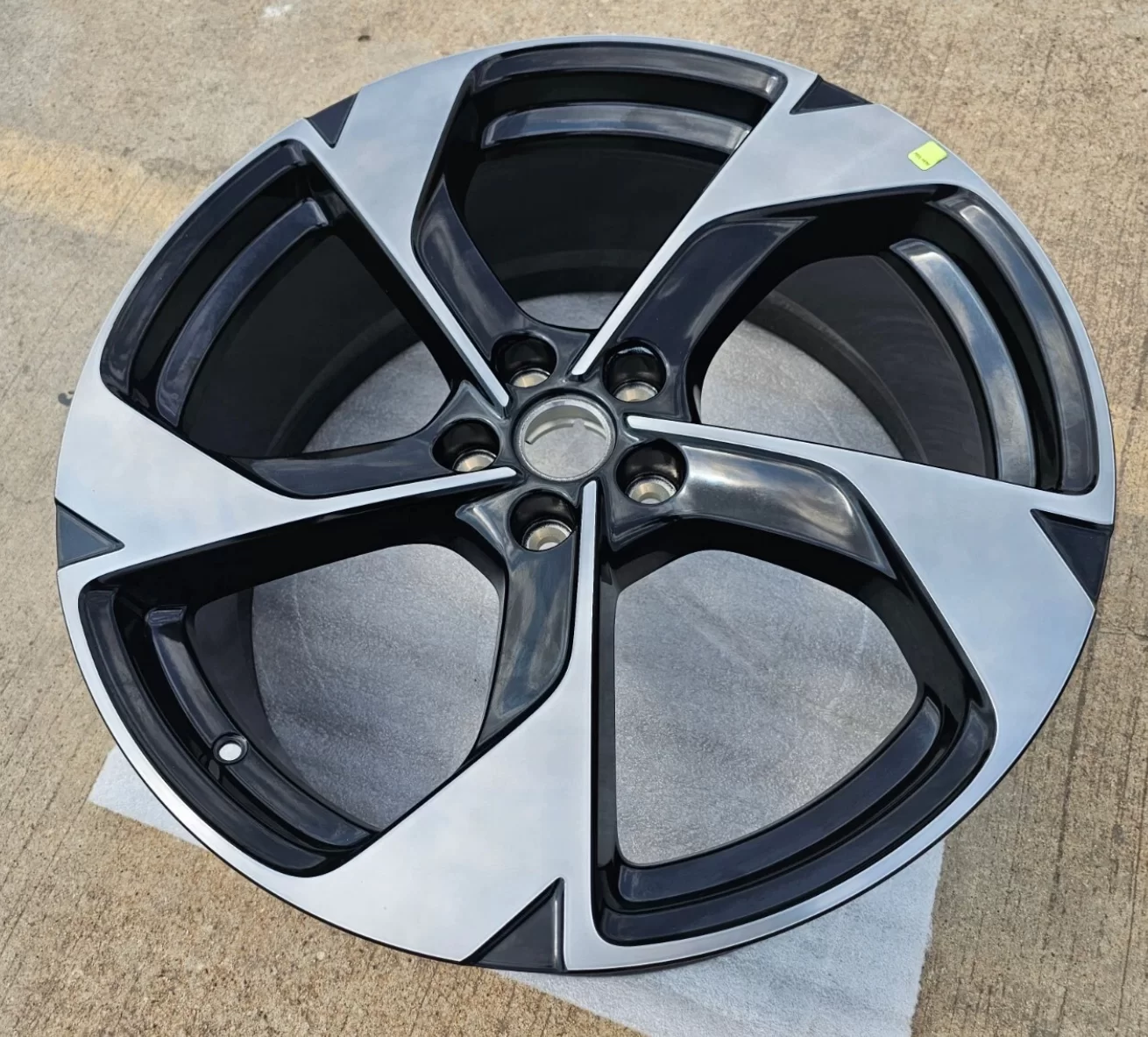

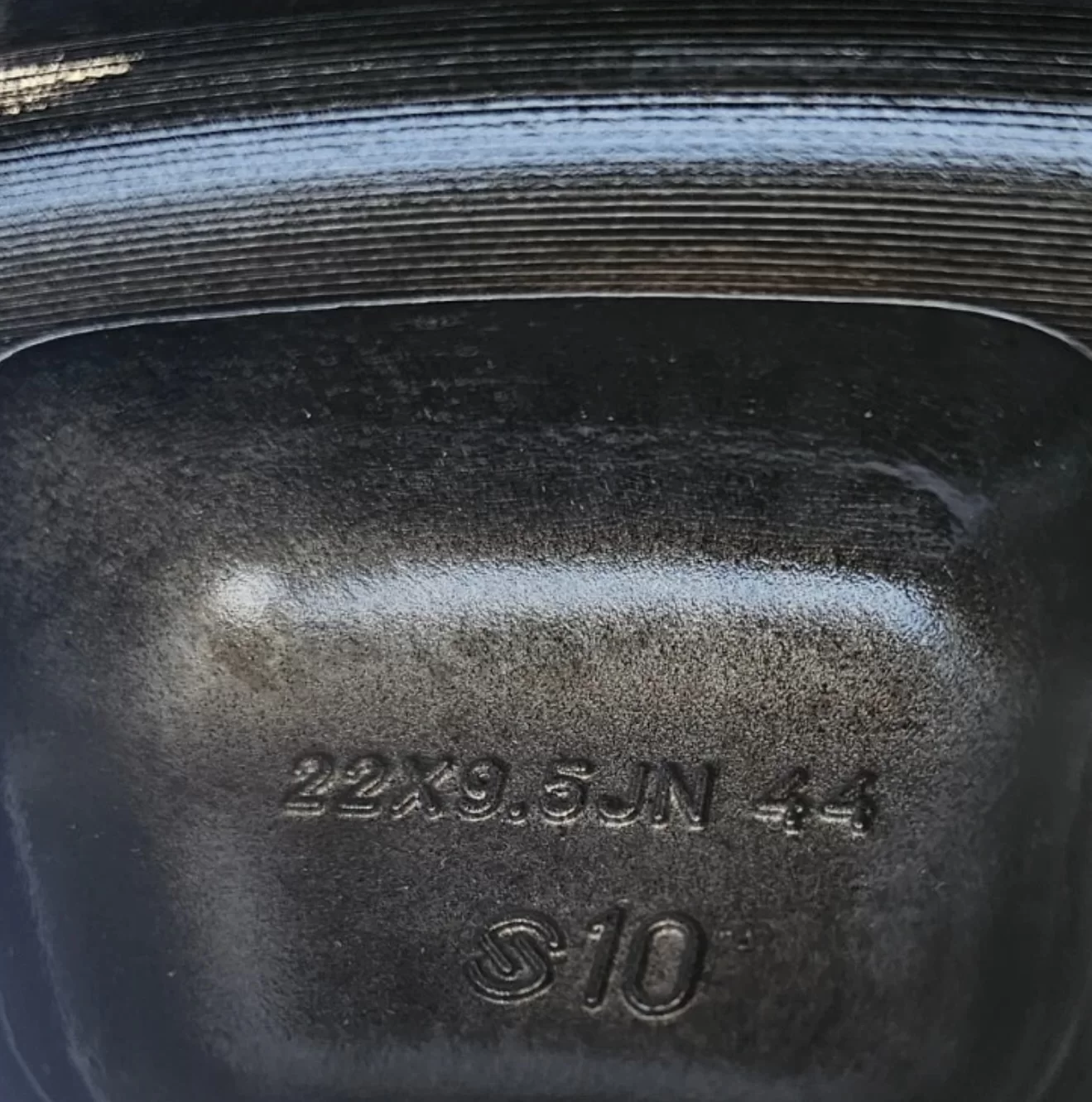

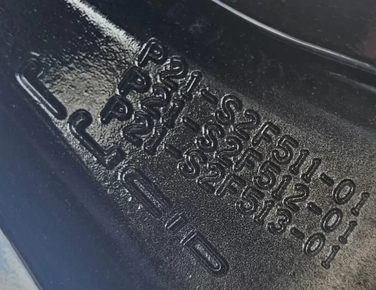

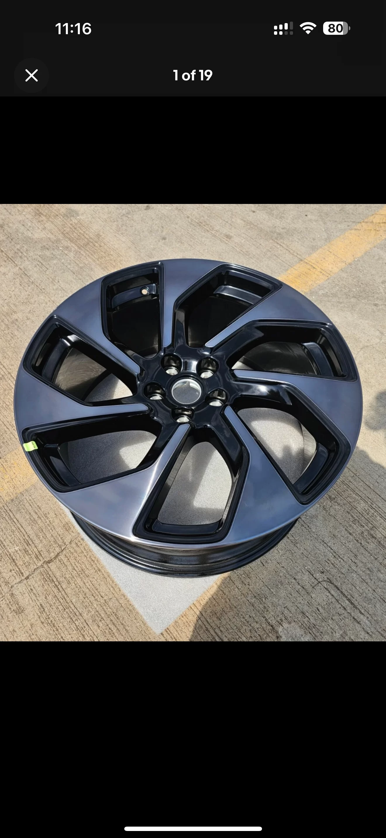

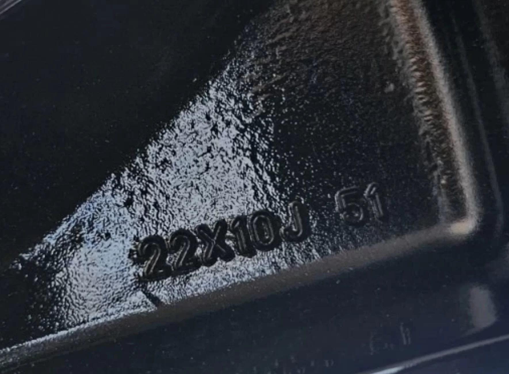

Large size 22” front: 22 x 9.5 and 44 offset, 5x120 bolt pattern
Medium size 22” rear: 22x10 and 51 offset, 5x120 bolt pattern

The front 22” is estimated at 45lb, I asked for a number on a scale, if I get that I will share, otherwise that is a very very heavy wheel.
