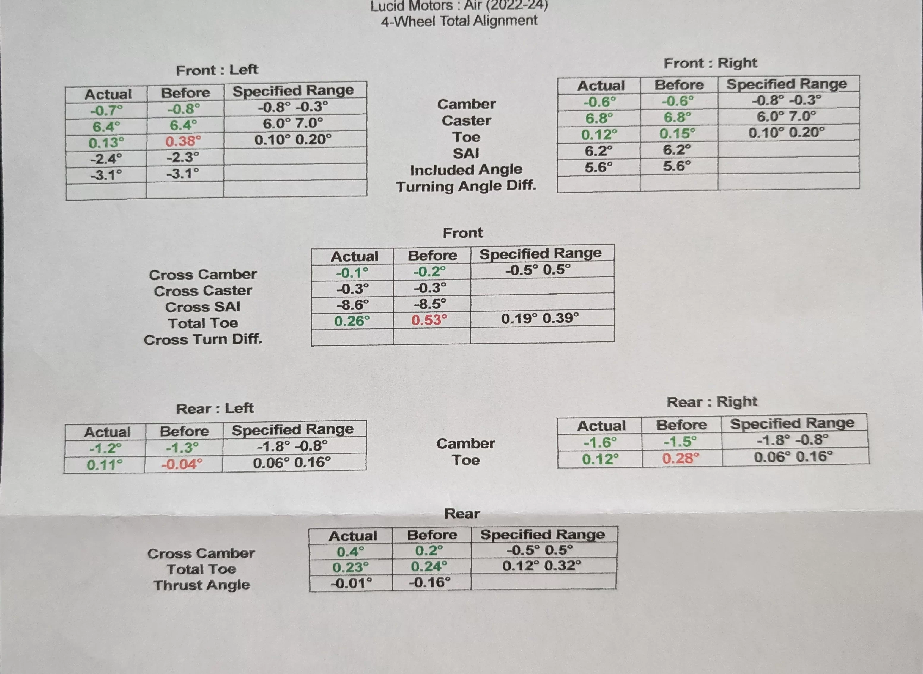

I'm at about 5,800 miles with the AGT ... and I realized that my steering wheel's position was slightly off-center. The vehicle was pulling to the right when the steering wheel was in the center position.
The Costa Mesa Center never answered back.. So I ended up going to a local Firestone shop.
I don't recall hitting any potholes or impacting the wheels on the road, at least not to my knowledge, but the vehicle's Toes were off.
They recommended doing this at about 6k mile intervals.
I ended up getting their "lifetime wheel alignment" service...(+ additional $100)
I figured this would be better investment than relying on Costa Mesa Center as long as I have this vehicle.

Did it correct your misaligned steering wheel?
Yes. they did.
In addition, at 12,000 miles service, I paid Lucid do another wheel alignment inspection back in April.
They screwed it up, and the wheel was off. I had to rely on nearby Firestone again to fix the alignment.
Complained/escalated to Lucid - they offered complimentary wheel alignment at the next 24k service.
That was Costa Mesa.... Not sure if they have that offer/record in San Diego service center system now...
