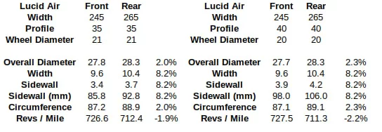

2. If you are upgrading from (Front: 245/40R20, Rear: 265/40R20 rear) to (Front: 245/35R21, Rear: 265/35R21), The overall diameters and front rear differences are nearly identical to each other, thus no calibration shall be required. See attached.
