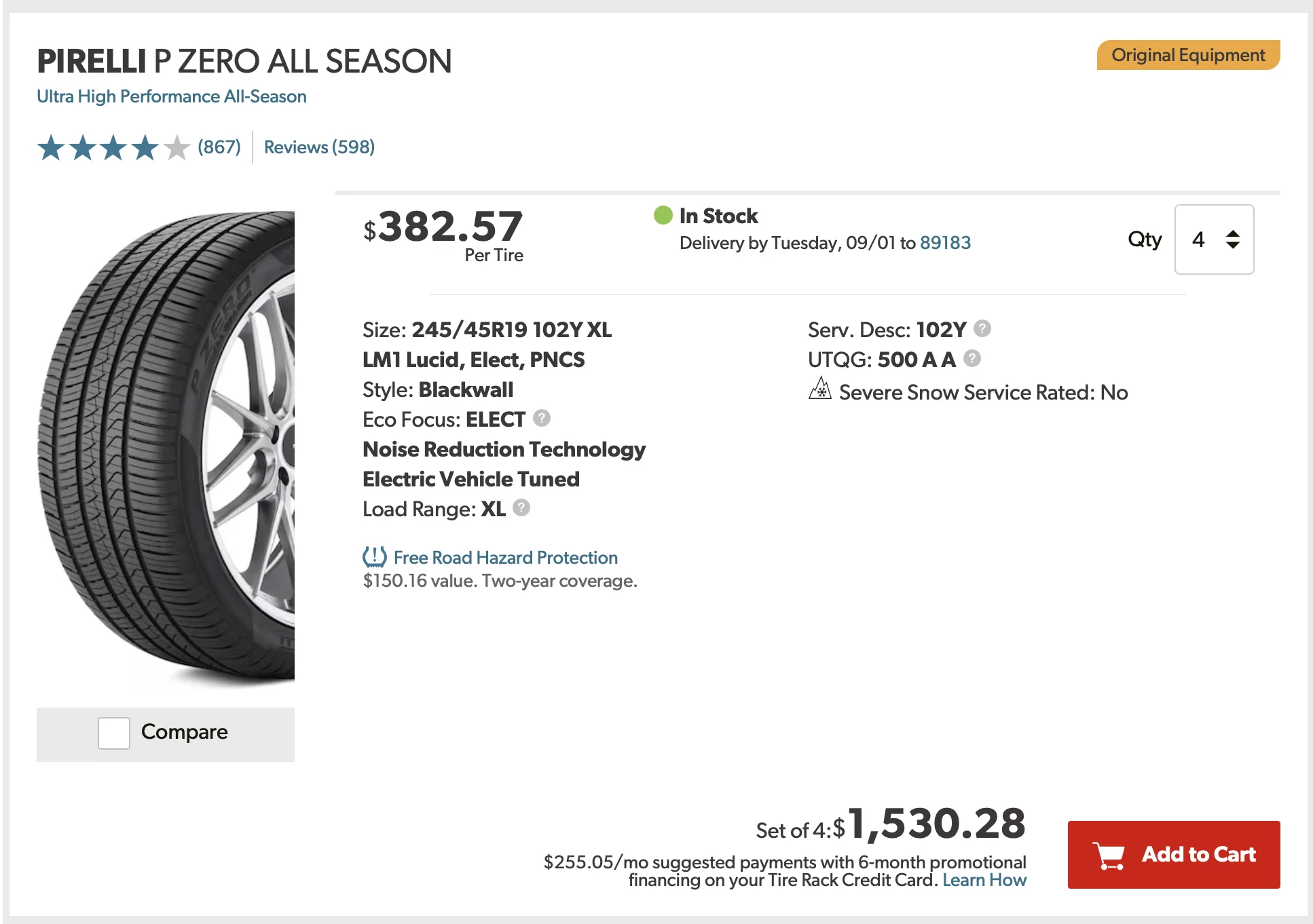

Sorry, I'm trying to help, but you're not making any sense to me.
The attached image is from Tire Rack right now. It's marked as Original Equipment, and it specifically is the same Pirelli brand and same P Zero All Season tires as the OEM 19's.
It's also the correct size, speed rating, and load, and it also says LM1 Lucid. That means it's the original tire. If it was an updated version of the same tire it would likely say LM2 (they did that for the 21-inch summer tires.
It also says PNCS, which specifically means that it is the foam version.
Your messages here seems to indicate that this tire is the exact same tire that your car came with, but you also indicate it is no longer available, and whatever new version doesn't come with foam. These show otherwise.
What am I missing??
