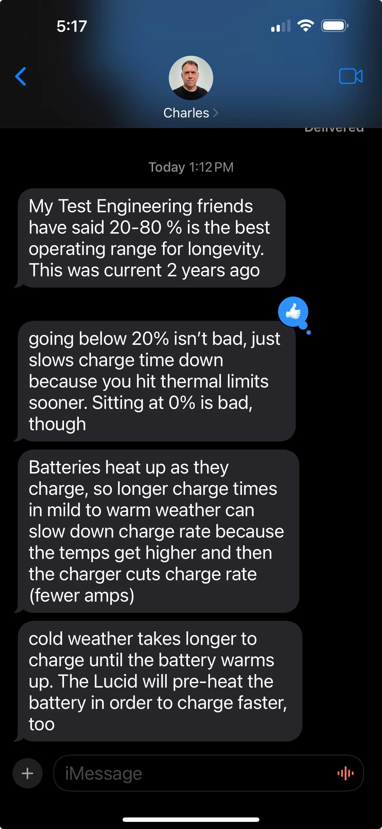

Thank you for your four tips. With regards to tip number 4 - are you saying it would be better for my battery’s longevity to run it down from 80% to close to 0%, versus say, 90% to 20%?
I charge my car up to 100% on an L2 charger about once a week. This allows me to get to work and back again without having to stop and charge. I arrive home after my 280 mile commute with a little under 20% remaining.
Level 2 charging is not supposed to damage or reduce the life of the battery. However, #2 comes into play. If you need to charge to that and you don't need to hit a DC fast charge - makes perfect sense.
