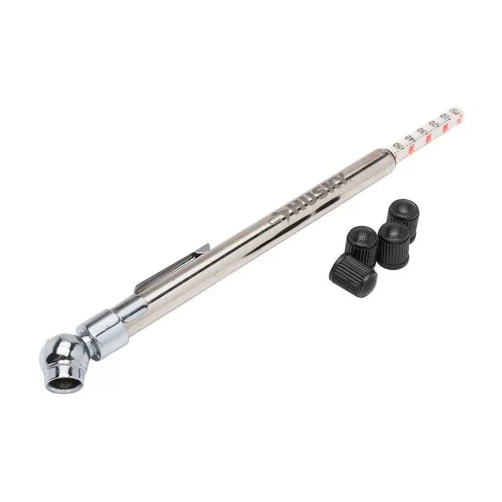

I keep one of these in the door pockets of all my cars:
I have found the pressure readings to be accurate on the Lucid tire inflator / shaving cream kit, even though its analogue and hard to read.
Don't take the shaving cream hose out unless you really need it = you will never get it back in the groove.

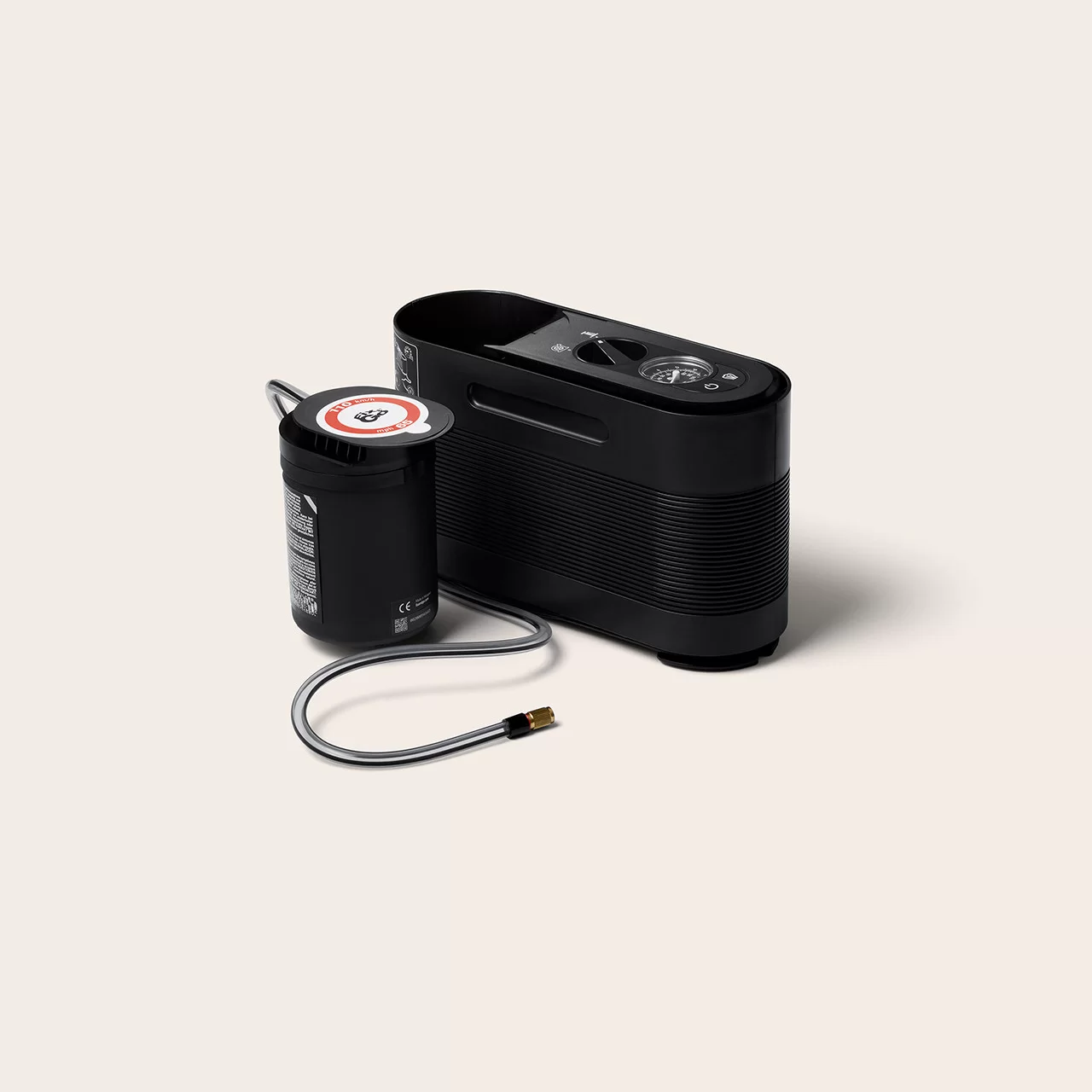

Don't take the shaving cream hose out unless you really need it = you will never get it back in the groove.View attachment 25981
