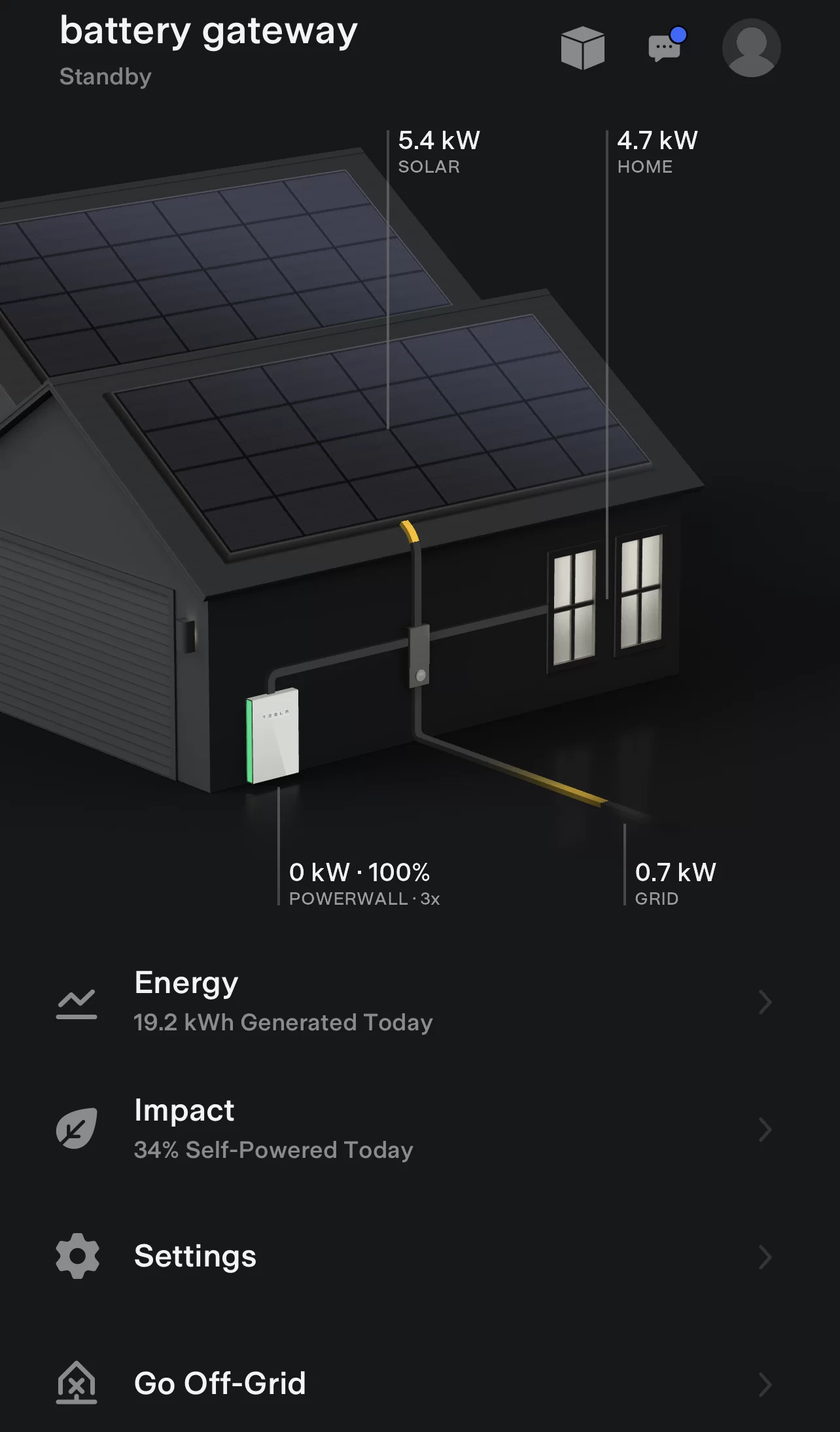

NEM 2. See buy/sell. Summary from my app.
What's this app? I'm not familiar with this interface, and I am a PG&E customer.

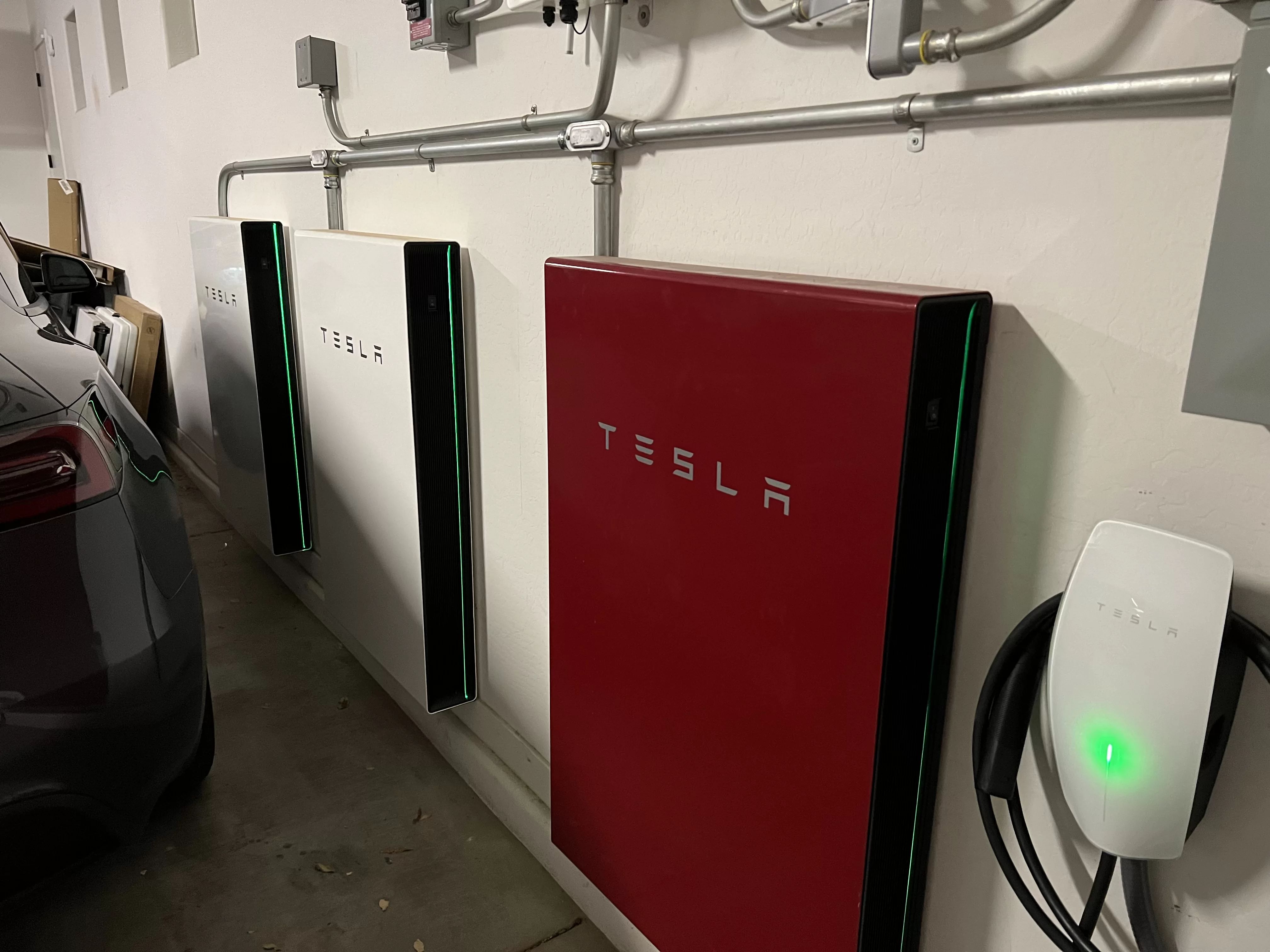

I have powerwalls, and you can install them any time as of new tax credit rules.

Powerwalls backup is pretty seamless and you actually have stored power and software is not bad.
