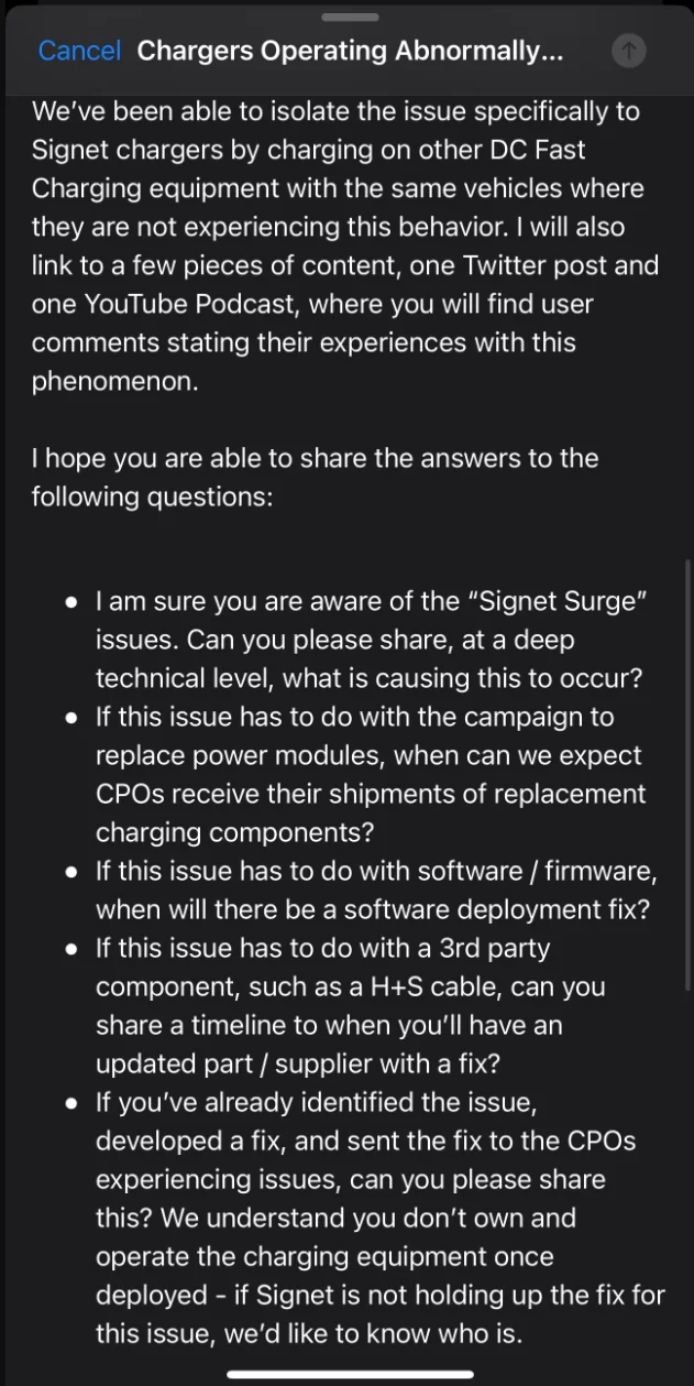

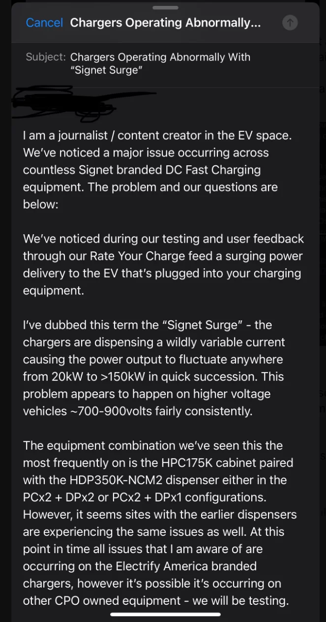

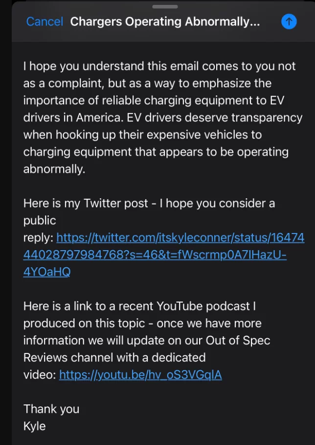

Kyle Connor appears to have narrowed down the type of equipment at Electrify America that is causing "yo-yo" power delivery. It seems to be confined to Signet units:
