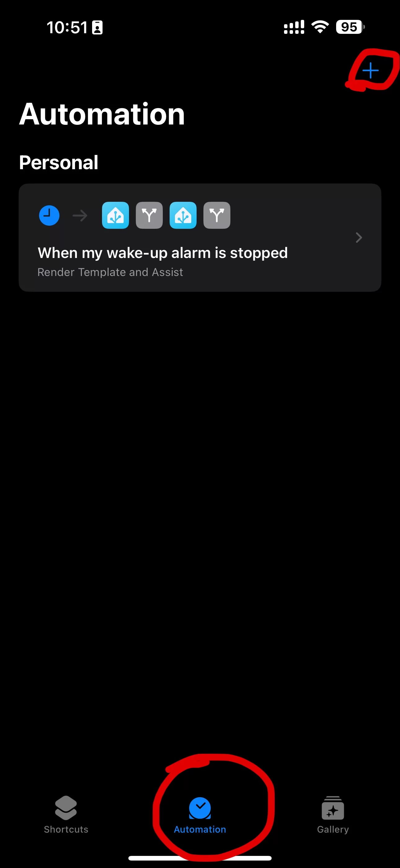

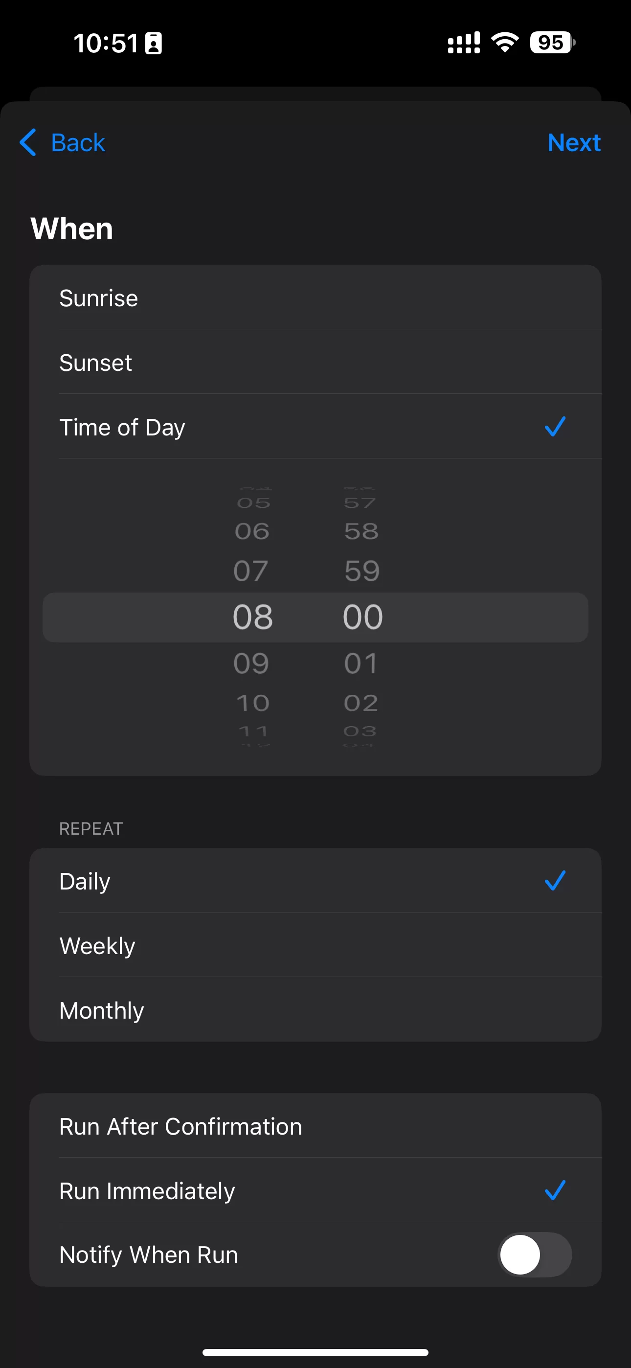

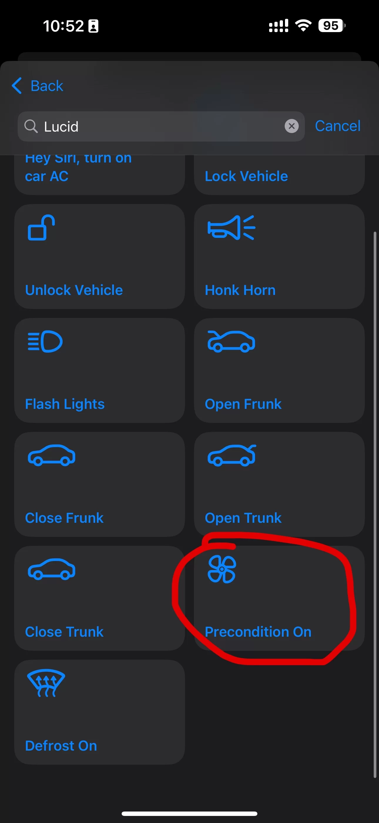

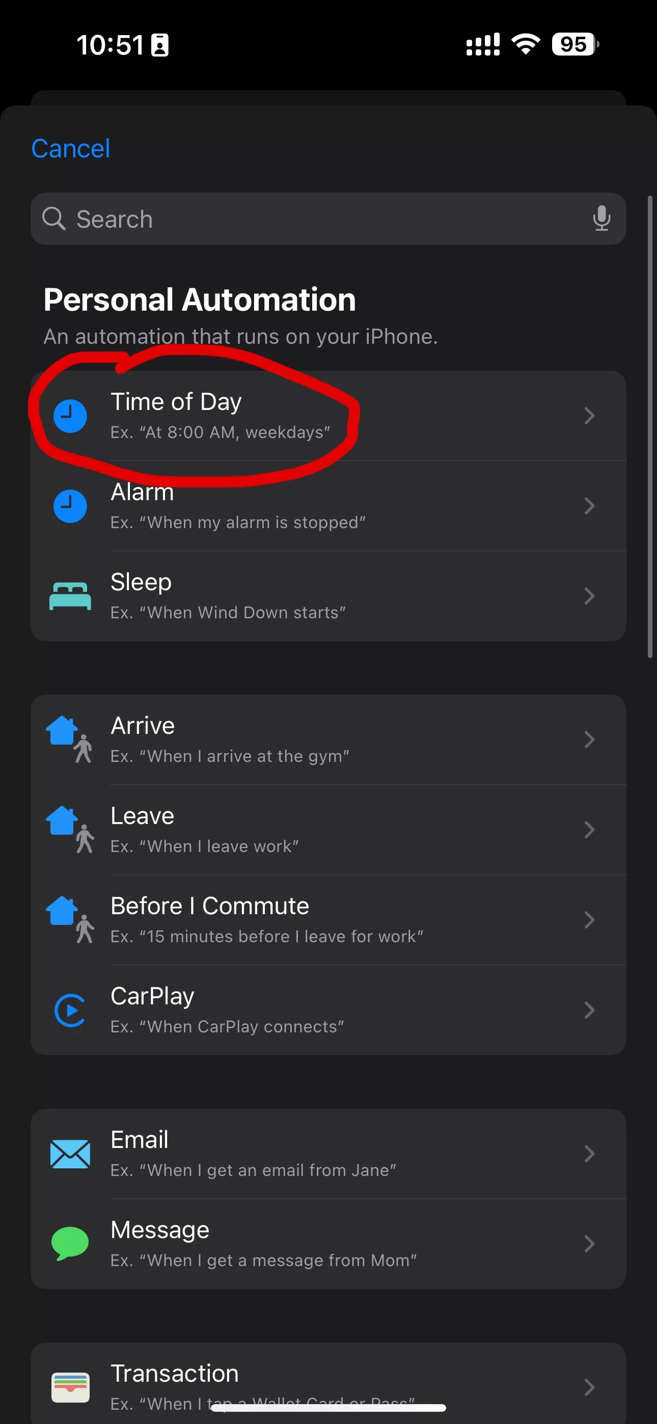

For iOS, find the Shortcuts app and:
I will say iOS shortcuts can be annoyingly inconsistent though, some of them just refuse to work without asking you every time with an "are you sure?" popup which kind of defeats the purpose.
