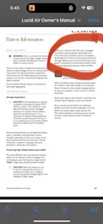

FWIW… Owner’s manual says maintain a healthy SoC between 40-80%
