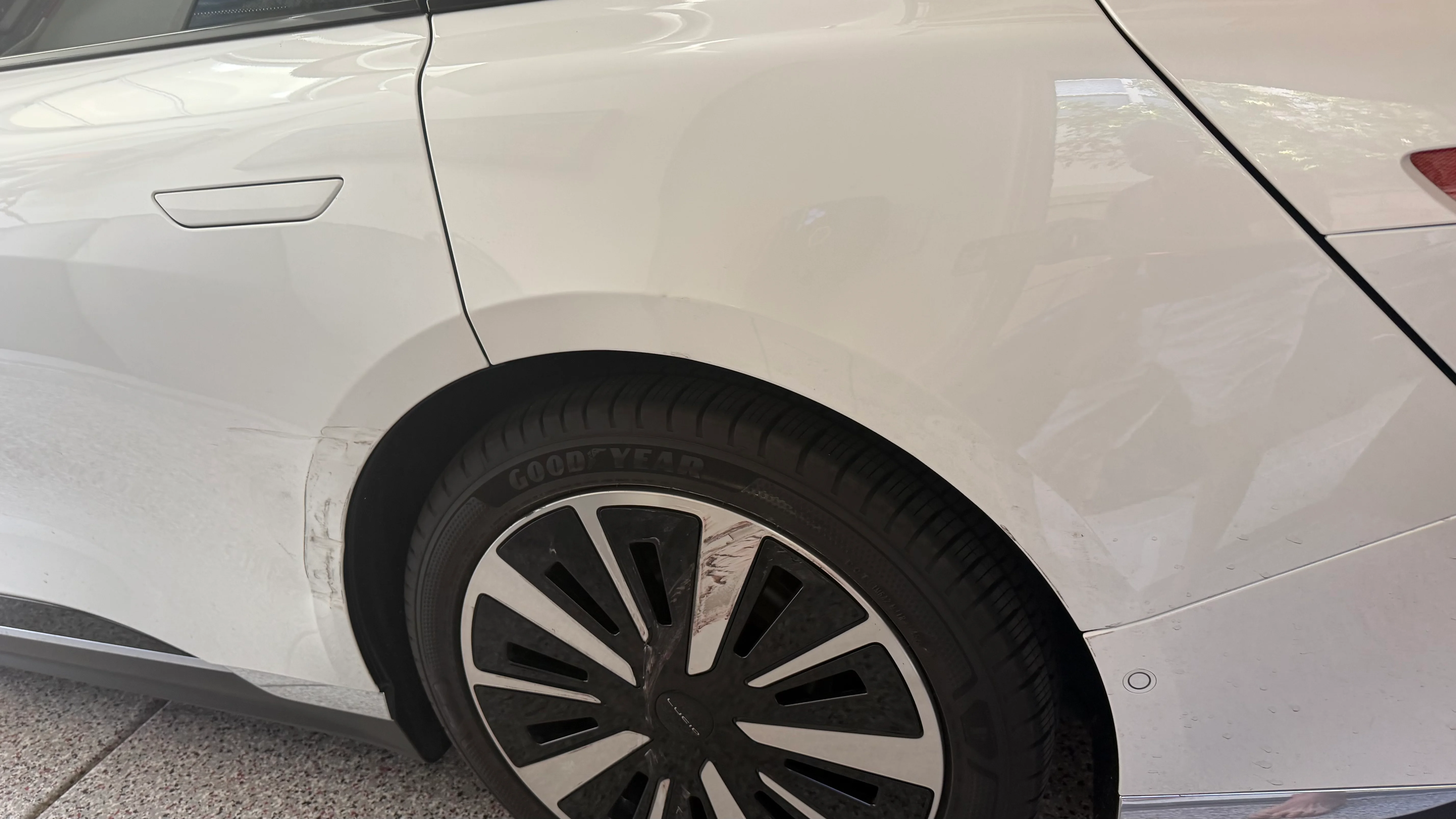

Yeah, I carefully read your post, Andrew. Thanks for all that insight. I was backed into at a low speed in a parking lot. Two vendors, from the visual inspection, said the left rear door had to be replaced and a third said it could be repaired, so I am pricing in the repair to all of the quotes. But I tremble before your advice about what can't be found visually, particularly whether it extends to the rear panel. 😱

Aluminum is tricky, as it work hardens from the impact (https://www.totalmateria.com/en-us/articles/work-hardening-aluminum-alloys-1/).
Once it reaches it's threshold, the aluminum cracks, which Lucid forbids us from welding up with an aluminum specific welder. In order to detect cracking, we use a process with dye penetrant and developer to determine if there are cracks present.
