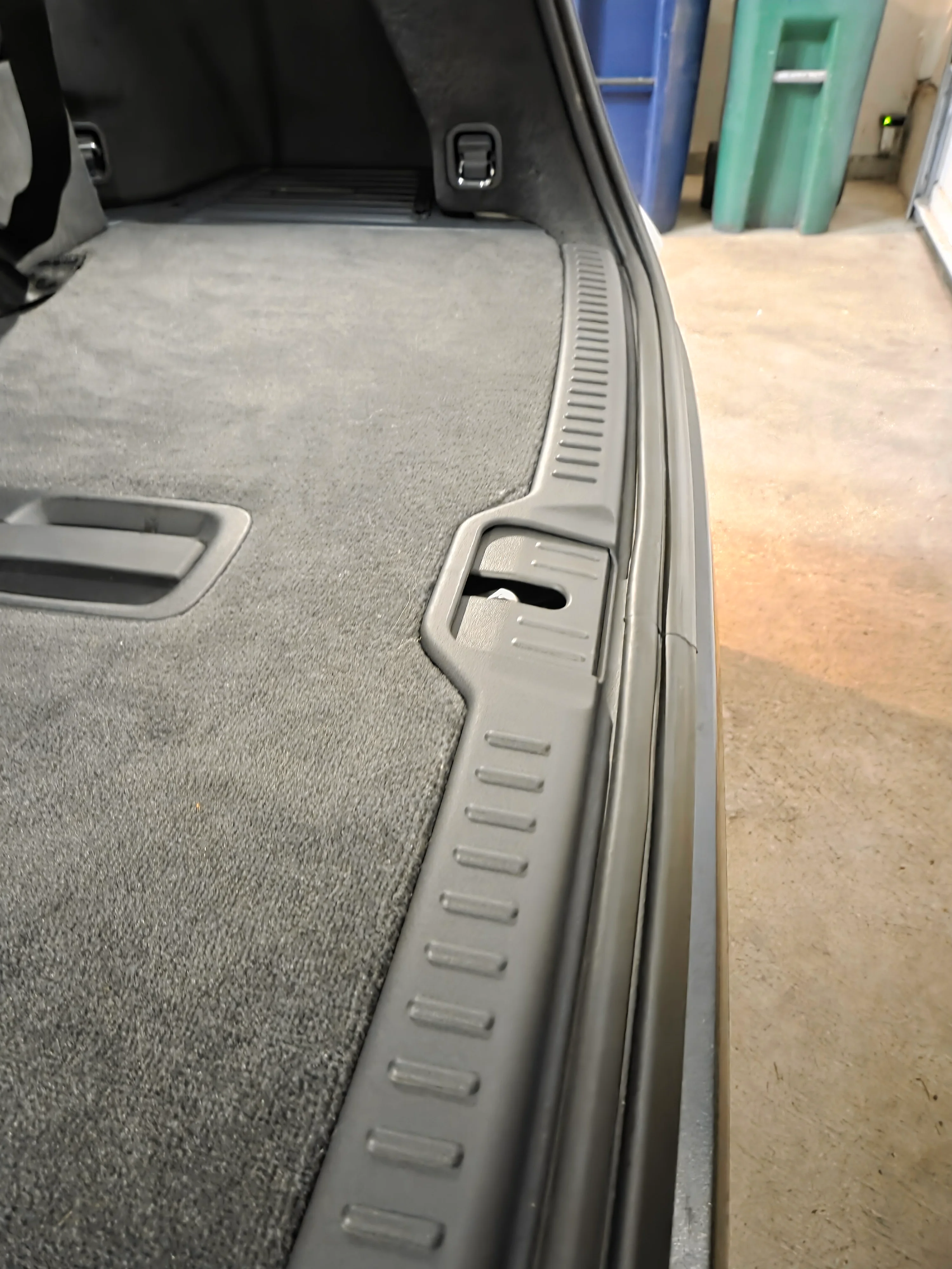

The mobile service tech fixed this issue for me by replacing the trim piece at the bottom edge of the trunk with a plastic one. The original had a metal portion, and he said the metal flap was catching on something. He said he could order a new metal piece for me, but 90% of the time it ends up having the same problem. The plastic one matches the frunk trim and is a lot less noisy when it opens... In addition to opening on first try 😀
Hey, now I need a new-style plastic trim piece! Even though my metal one has been working fine.

Also, that plastic trim replacement plate looks like a must-have. Would cut down on that clunking noise from the metal flap. Which is now my ringtone BTW. 😁
