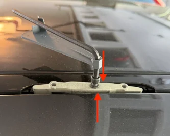

Ignore everything I just said. I went to install mine ands the bolts on the rear bar won’t thread all the way. And now I’ve got one stuck and it won’t come back out. It just spins
If there is room, maybe use vise grips to squeeze the white plastic around the nut-zerts to stop the spinning so you can recover.

Known issue with the receptacles being poorly made. Lucid had to replace mine due to them spinning upon initial install. Highly suggest Lucid Service installing them.
Additionally had to replace three windows due to the poor design of the crossbars and the proximity of bolts to the glass. Ended up just removing the aero bars permanently.

The bracket you see isn’t the problem, it’s just in the way. The thing that receives the bolts, inside the roof rail, broke free of its weld. I have no way to grip that piece, as I can barely even see it, let alone get a tool on it. I googled it and apparently this is a known problem. Great.

This was only the second time I went to install the crossbars. So it's definitely not a repeated use failure.

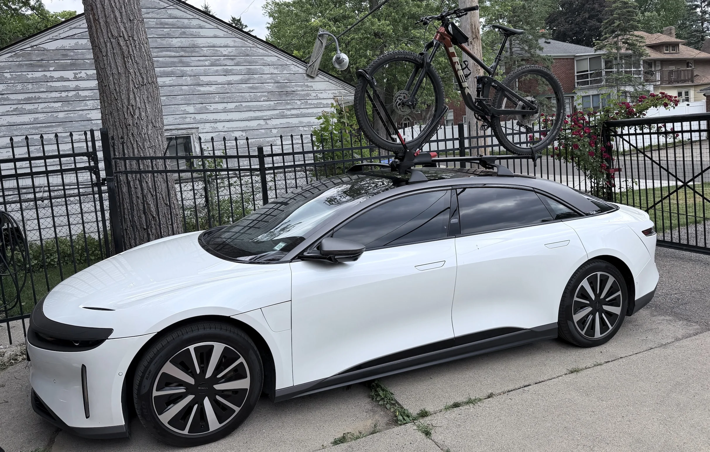

I should have returned to this thread sooner with an update. I acquired the cross bars and bike carriers from a local Lucid owner (Thanks Mark!). Installation was super super easy....for the 1st three positions. Then I started getting visions of @JGard18 and @Dog poop 's issues. The weatherstripping was preventing me from getting the bolt aligned correctly. I eventually wound up using a knife blade to hold the weatherstripping back while aligning the bolt. A 3-hands required job but since nobody else was home at the time and the dogs don't have thumbs I got really creative and got it done with two. Happy with the result. Car doesn't look bad with them on and I've been riding enough that taking them off hasn't made sense. At least not yet. I think next roadtrip I may take them off. The road trip with the bikes is a couple months out.
Did you have pictures?
