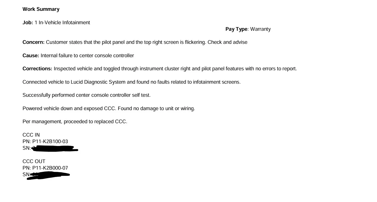

Lucid addressed this for me, albeit after some back and forth.
Here is a snapshot from the work order with serial numbers redacted (probably overreacting there but ya never know).
Hope it helps.
Hope it helps.
