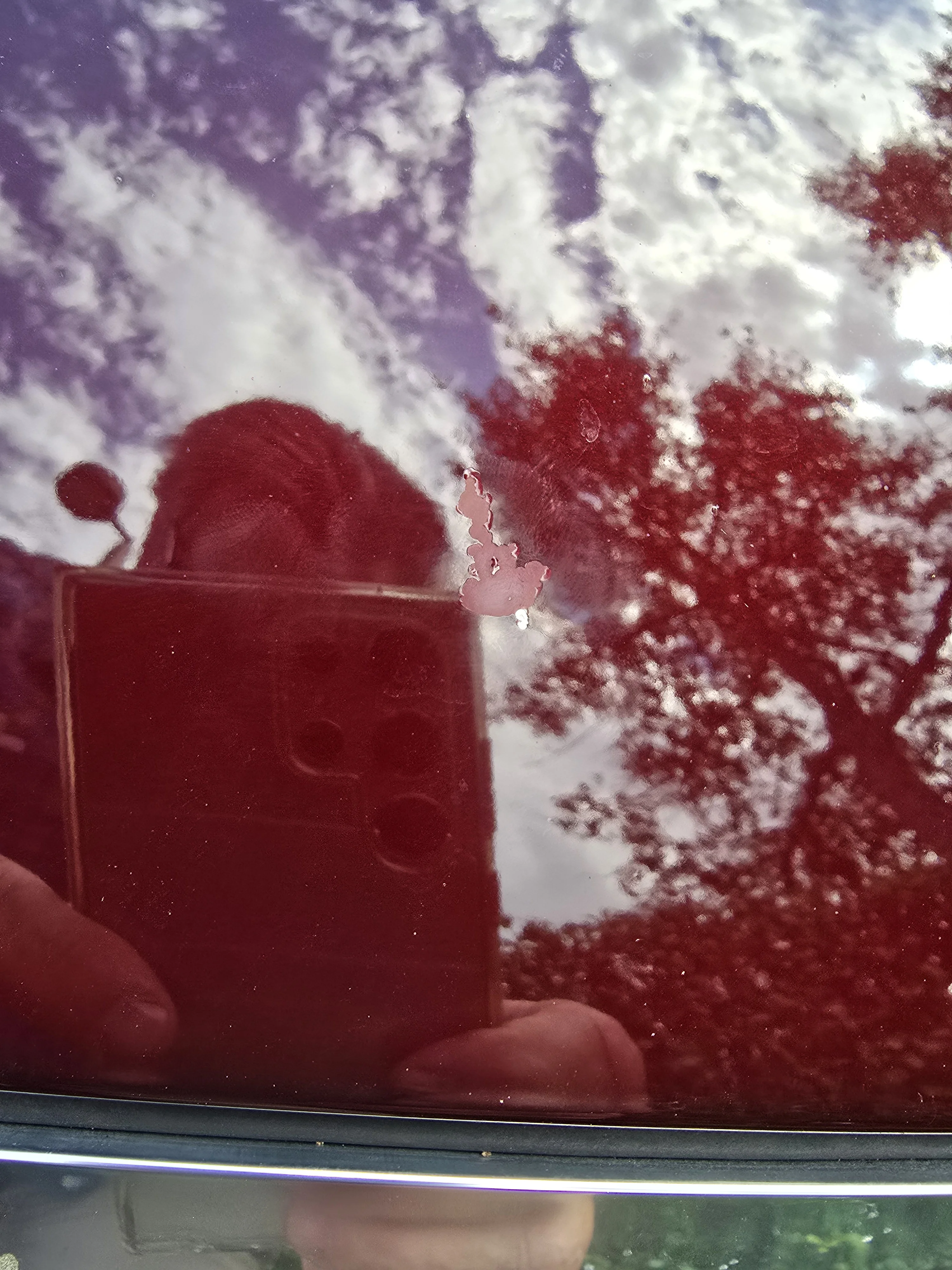

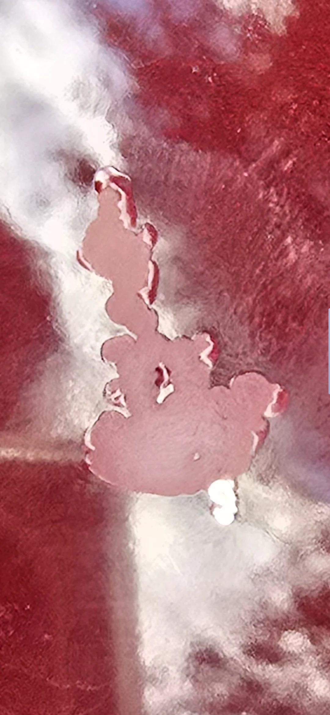

Paint Failure?
Completely understand! Ceramic coatings are great to help provide UV protection and aid in the cleaning/maintenance of the paint, but to ultimately stop rock chipping, paint protection film (PPF) is the best solution on the market at this point. Ceramic coating is not thick enough to stop chipping.
One of the challenges in placing PPF or (even vinyl wrapping) on a Lucid is with the cameras, LiDAR, short range radar, and long-range radar sensors, any film material placed over areas of the vehicle where these sensors live, could result in diminished performance of those systems.
