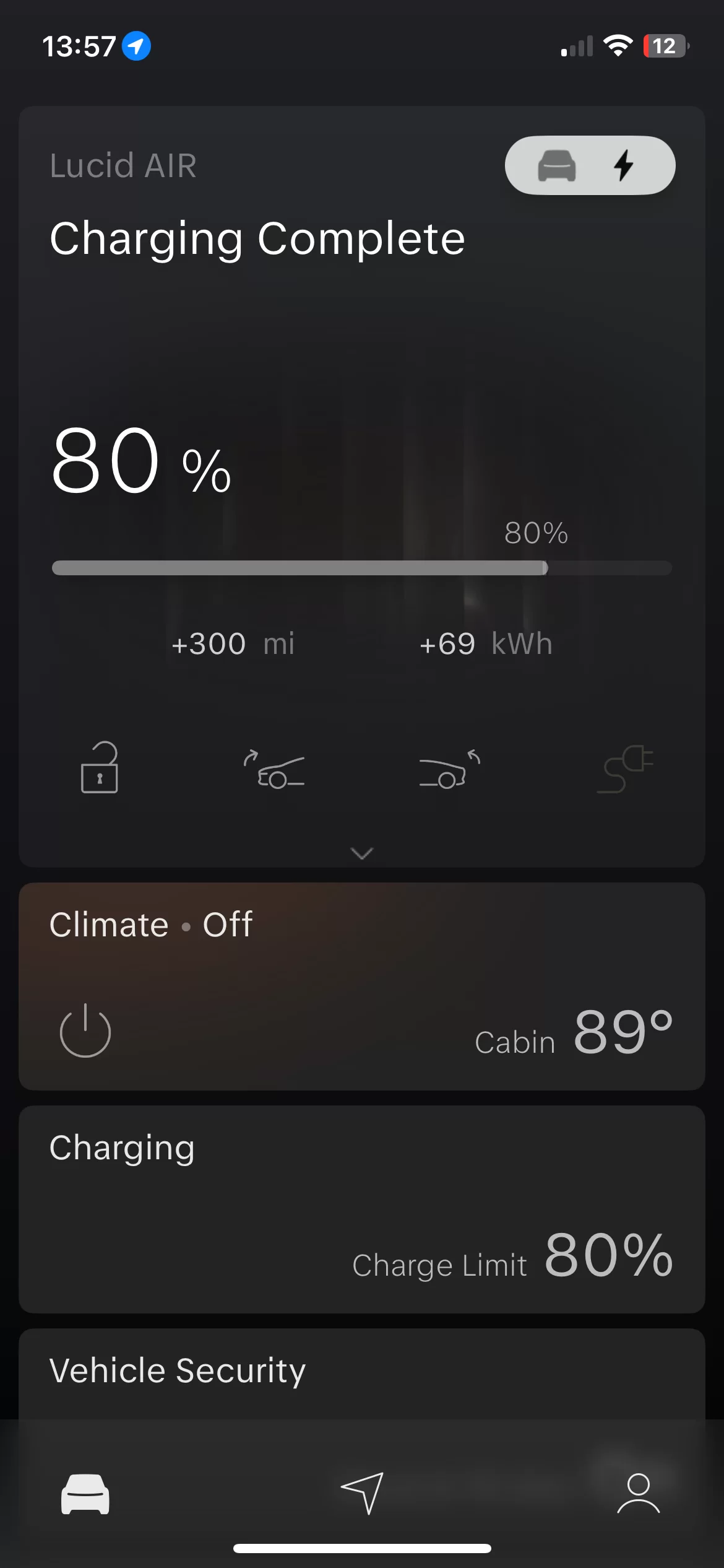

I just noticed when you charge your phone at home and your charging session is completed, lucid mobile charger doesn’t show how much kwh you added to the car to reach to the targeted percentage. It only shows the mileage at the target percentage.
This is so bad, i was tracking my consumption manually through this information and now it is gone. Lucid, please add this information to the mobile app back again. I would like to know how much kW i added to my car at my charging sessions

Issue is still existing. Sending a screen shot. I did not put 69 kwh to the car . When the charging started it was at 27%

Interesting. I have questioned this number as well. The "miles added" seems about right on my car but the "kWh added" does not. I could be wrong though.

Could that be kWh from the plug vs kWh into the battery? There are ohmic losses as well as parasitic losses with charging - CPUs etc and battery thermal management.

Also I just want to do some math here .2023 Air Touring has 92 kwh battery capacity. I charged from 27% to 80% which means 53% charge is added.
If 100% =92kwh
53% is equivalent of 48.76 kwh. So i guess i added around 49 kwh to the car, or maybe 50-51 kwh with losses but definitely not 69kwh.
Also the displayed +300 miles is wrong,too. I did not add 300 miles. This would happen only if i would charge the car from 0% to 80%
