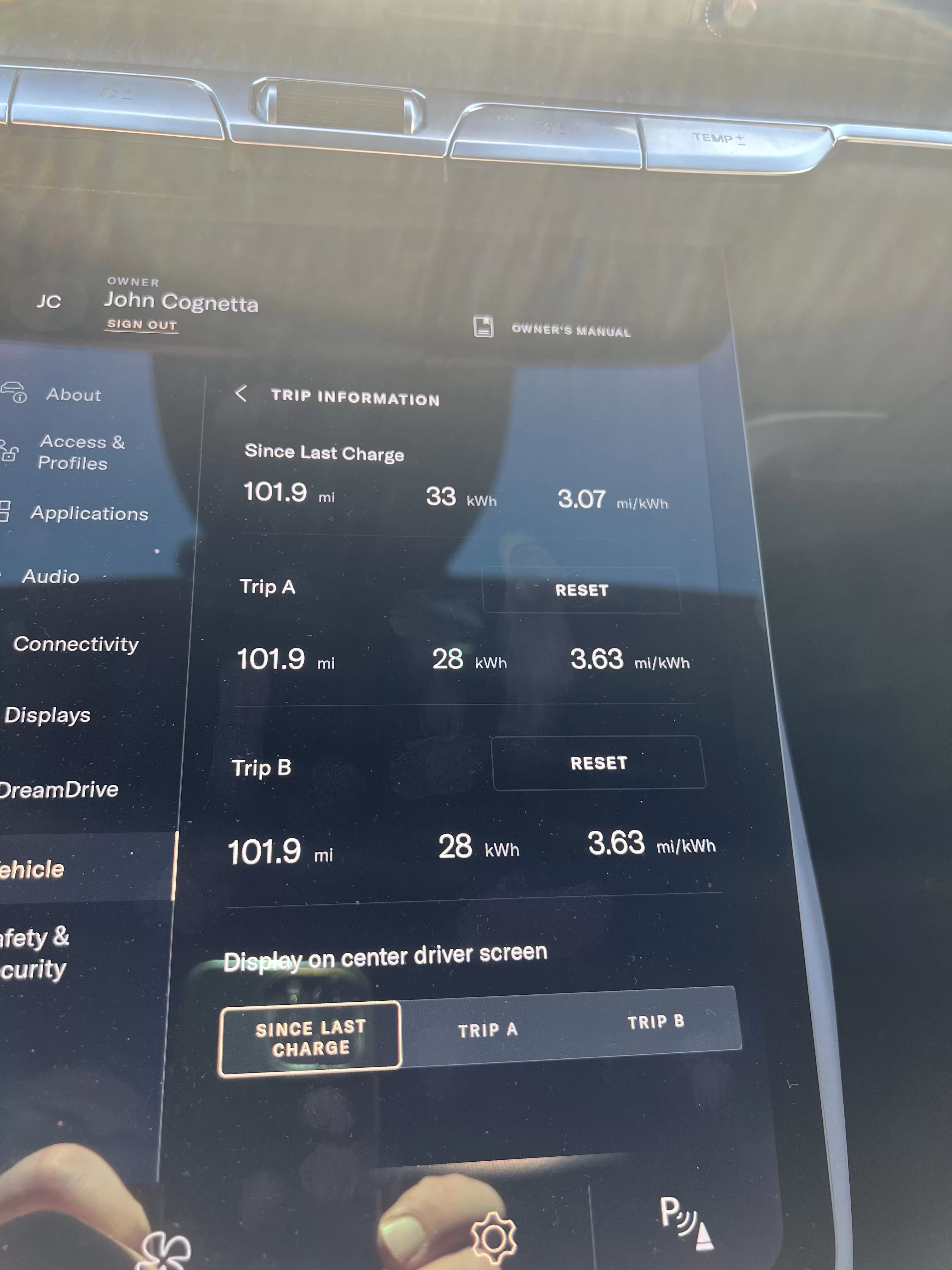

I reset both my Trip A and Trip B displays, and since the latest software update, I have a discrepancy in mi/kWh from the "Since Last Charge" and the Trip displays. I brought this to the attention of my service rep and he was stumped. Said he needed to refer this to Engineering. On the below photo, the 101.9 miles are the same for both Trip A/B and Since Last charged. Yet the kWh are different. Does anyone else have this situation? I am not sure which is the correct kWh. Seems like I am charging more often.
My only guess would be that the “since last charge” accounted for energy consumption while the car is parked for HVAC, infotainment, etc, and the trip ones didn’t account for that. I don’t have a proof, just guessing. Did you happen to use your car while it’s parked for an extended period of time over these 101.9 miles?

Thanks for the reply, I drove the car on a regular schedule, no extended down time. I turn off what I can, AC, seat warmers, etc. However, everytime I walk into the garage, it wakes up

I don't see what the surprise is. Since Last Charge will include phantom drain, and the trip odometers' kWh will only show consumption on the drive. I guess 5 kWh of phantom drain may be high, depending on idle time, how often you are waking the car, what's turned on when the car does wake and other factors. Is your surprise just the magnitude of the difference? Sorry if I'm missing something obvious.

I think this is by design. Trip means a trip, you want to measure how much your consuming while driving.
It could be phantom drain as the car wakes up every time I walk into the garage. How can I turn off the car so it does not wake up with just walking by it?
Turn off passive unlock. You'll need to press the door handle in to open it.

Its because trip A is the actual miles driven. Last charge includes all energy consumed parked as well as actual miles driven. This is why the latter is a higher Kwh used.
... the car wakes up every time I walk into the garage. How can I turn off the car so it does not wake up with just walking by it?
Most people will tell you to turn off passive unlock from inside the car, but I just toggle off bluetooth on my phone, and then back on again when I leave the area. That's way easier than getting into the car's settings twice to turn passive unlock off and then on again.
