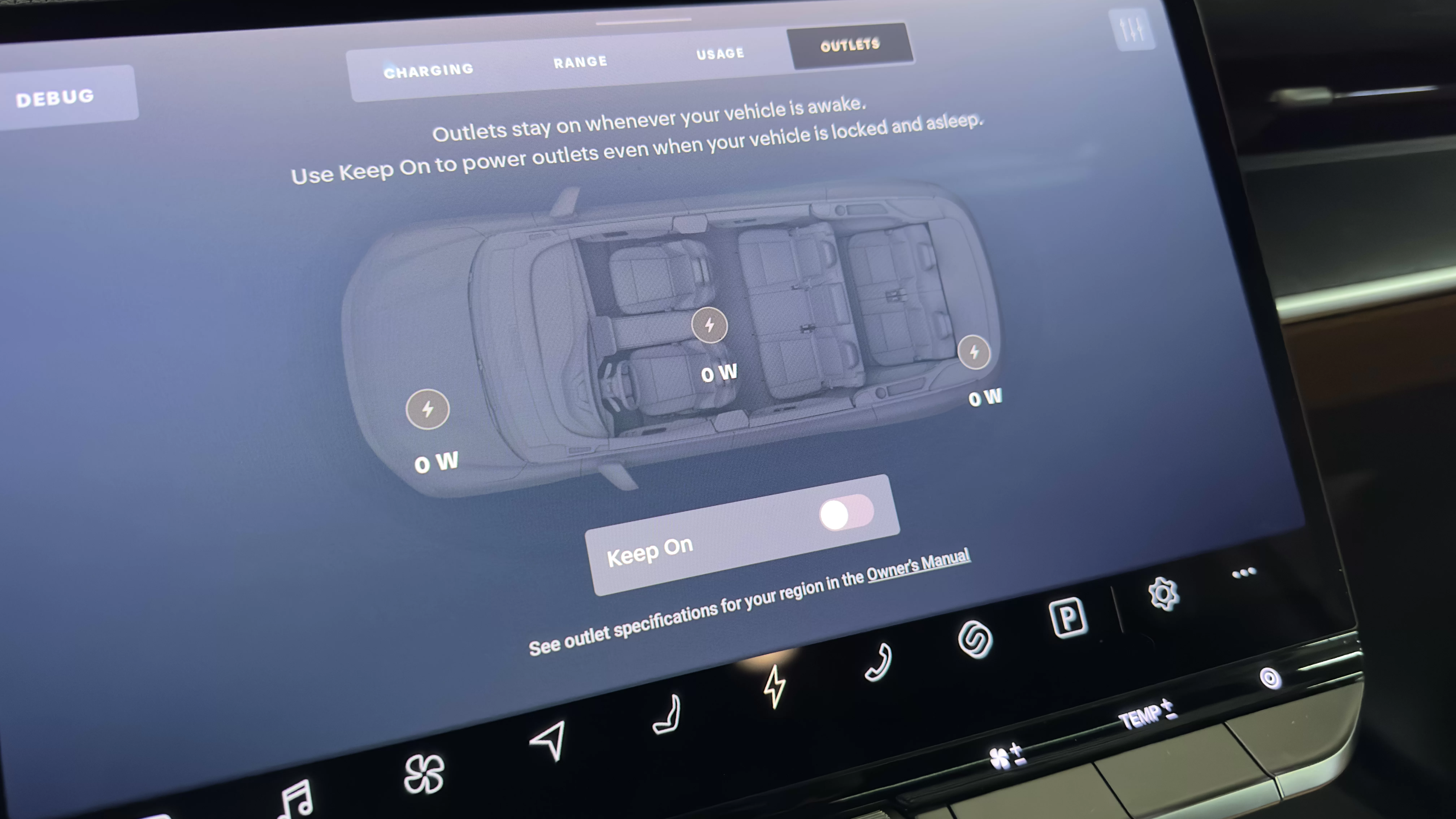

Lucid, please bring the "Keep On" charging setting for the power ports back to the Air if you can via software update,
I have a radar detector with a Dashcam (Escort MaxCam 360c) connected to the console power port (either USB-C or USB-A with adapter) and a Dashcam (Escort M2) in the rear window connected to the trunk 12V port. I'd love to keep them powered on all of the time (24/7), as appears the Gravity can do (have one of those on order too, LOL) to simulate a sentry mode when the vehicle is parked. It would be a new wunder from the wunderbox.

That is an intersting screen! I wanted the opposite.
In my 2025 Air Pure, the trunk outlet is always on, and the USB is only on when the car is on. Since I run my ham radio via a heavy 12V wire from the trunk outlet to the front, I wanted the trunk outlet to be off when the car is off. I did that via a triggered relay box in the trunk, operated by the 5V USB signal from the front. That also required a USB 'decoy' plug in the front, since you only get 5V there when requested via a compatible USB device.
I like that they have the option for to keep on vs turn off with the vehicle. I have a radar detector that I would prefer turn off with the vehicle. However, as for a dashcam, obviously you'd want it to say on.
