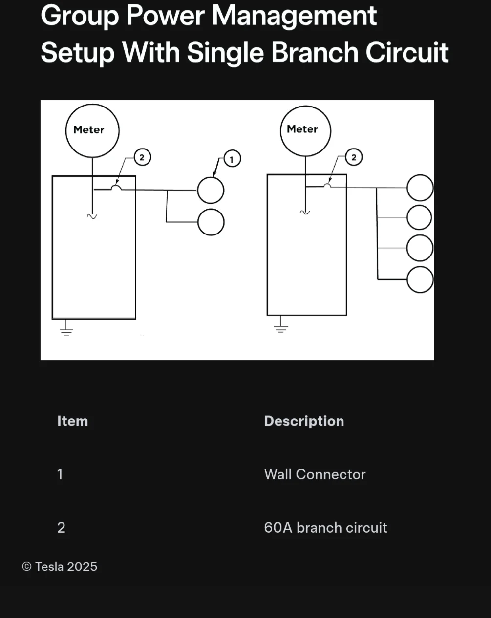

I can't speak to whether your G2 wall connector will work (maybe by reducing the current setting to 48 amps?). But any other NACS charger should work. Lucid's LCHCS is rudimentary in its current state of development. Several other 80 amp chargers are available, some at a lower price than the LCHCS, and have integration with a phone app, charging history and cost estimation, etc.Question: I currently own a Tesla Model 3, and have a 2nd Generation Tesla Wall connector set at 80 amps and connected to a 100 amp circuit. I heard this setup won't be able to charge a Lucid Gravity. So, if I replace the Tesla Wall connector with a Lucid Home Charger, will I be able to safely charge the Tesla Model 3? Are there any caveats to that?
