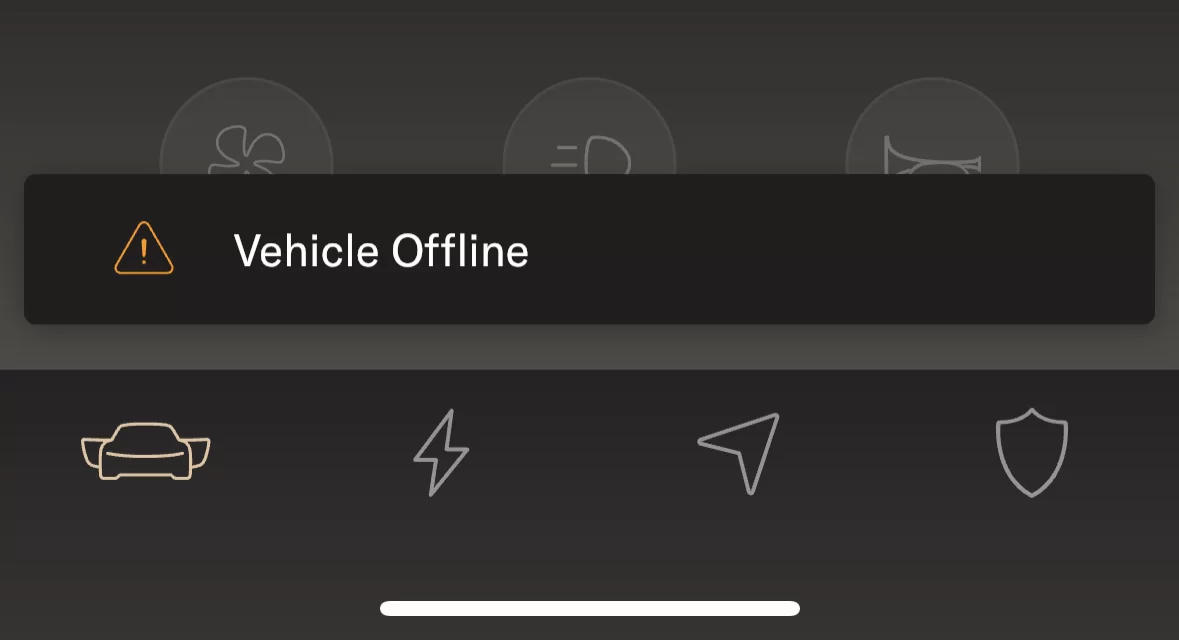

The car reset around 6 … I’ve driven it since … app still shows vehicle offline …
