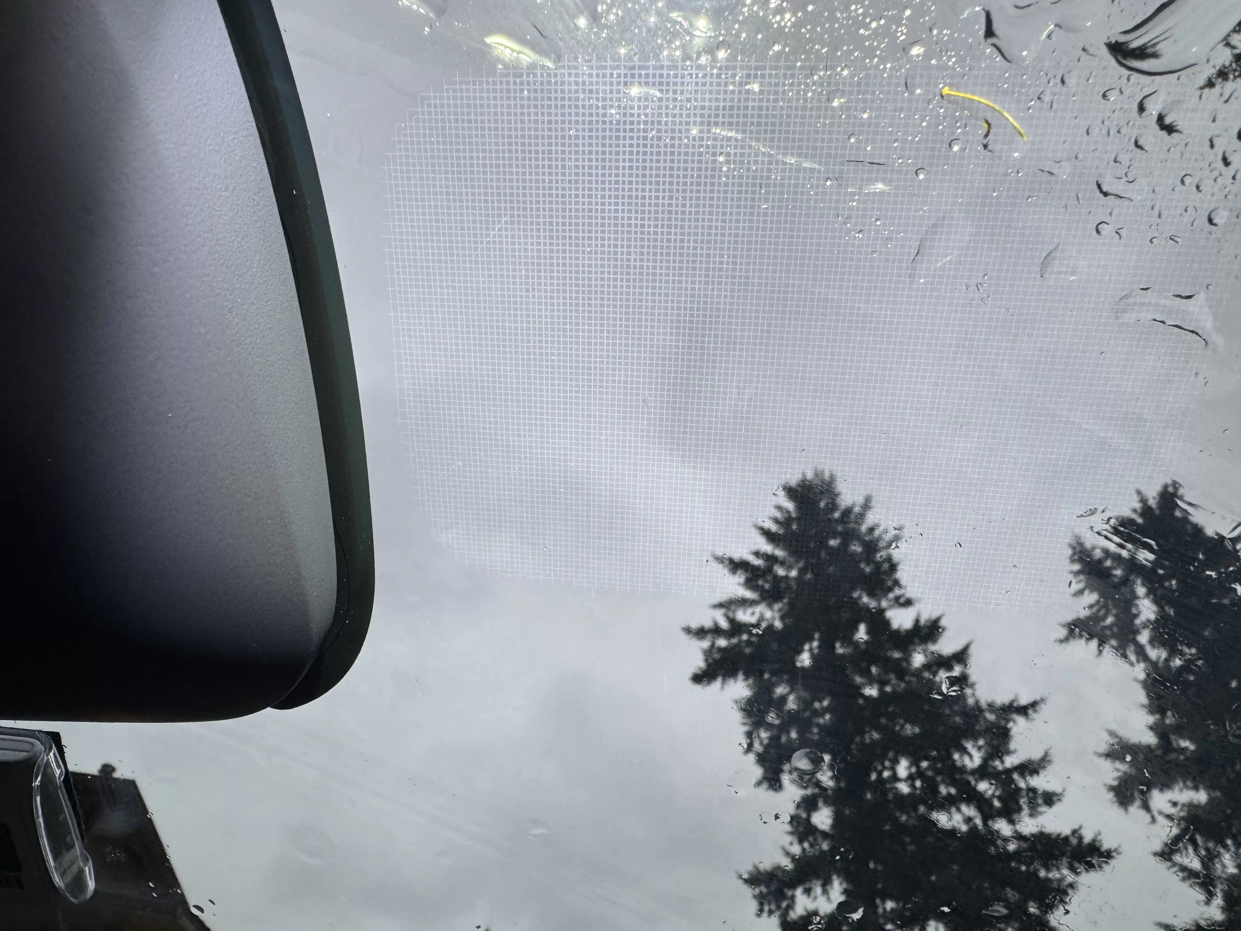

There's a specific place on the windshield where transponders are supposed to be placed to allow RF through. If you look very closely to the right of the center console you can see that the glass looks a bit different, there's a pattern embedded in the glass. I'm guessing it's a hole in whatever protection coating they use in the glass that blocks RF.
I guess it's something that 2025+ have. It's been discussed here before and people with earlier model years have confirmed they don't have this.

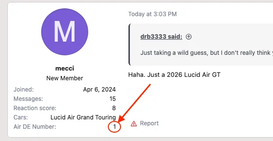

Just taking a wild guess, but I don't really think you have the limited production Air Dream Edition serial 001, but who knows; I am often wrong.
Haha. Just a 2026 Lucid Air GT
This means you own the limited production Air Dream Edition Number 001, so maybe delete this.

Don’t guess at the location. Look for the special area without the metallic coating (dots or clear area). I’ve seen posts for various model years that show either to the right of the rear view mirror or near the passenger side dash. The location is hard to see but it will be visible if you look hard enough and at the right angle. Using a flashlight in a subdued lighting may help.
Since the very beginning of the Dream Edition Airs, the front windshield production has changed several times to allow for EZPass transmission. Mine has this "cut-out" as well.

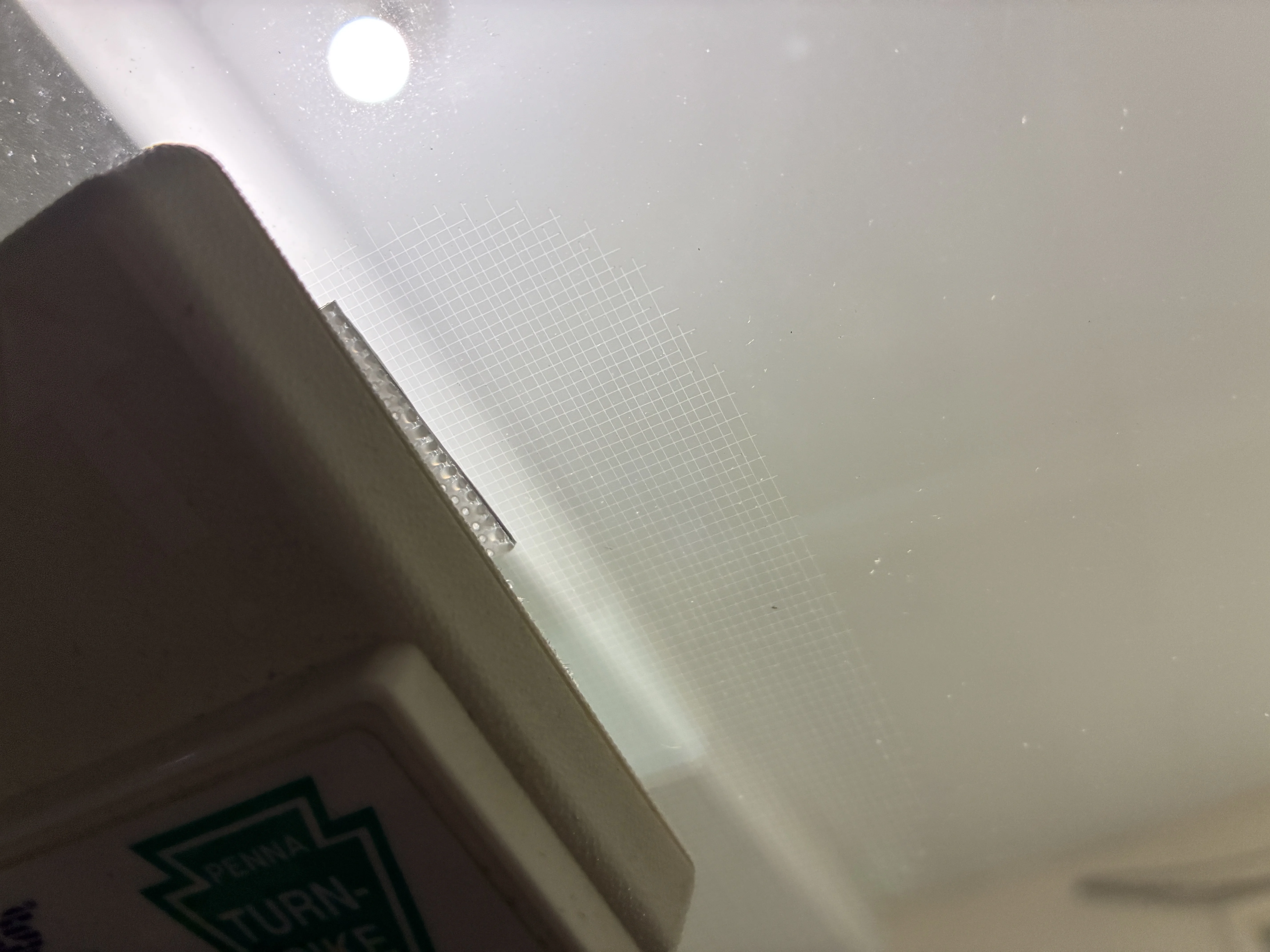

Wanted to close this thread. Finally found the correct location and I have a successful transponder read. This is in my 2026, but I guess approach is the same for others.
Look for a slightly different color (rectangle slot) to place the reader. On 2026s, it's on the passenger side. Pics attached. Sorry for the reflections.

Having the transponder placed incorrectly (but where the Lucid delivery team told me to put it--this is a Gravity GT but I hadn't yet added the car to my EZPass account) cost me about $100 in "extra charges" when my first use of the EZPass was a long trip. Some were reduced but most were not. Now place correctly and also on my EZPass account. That little "RF Opening" is very important.
