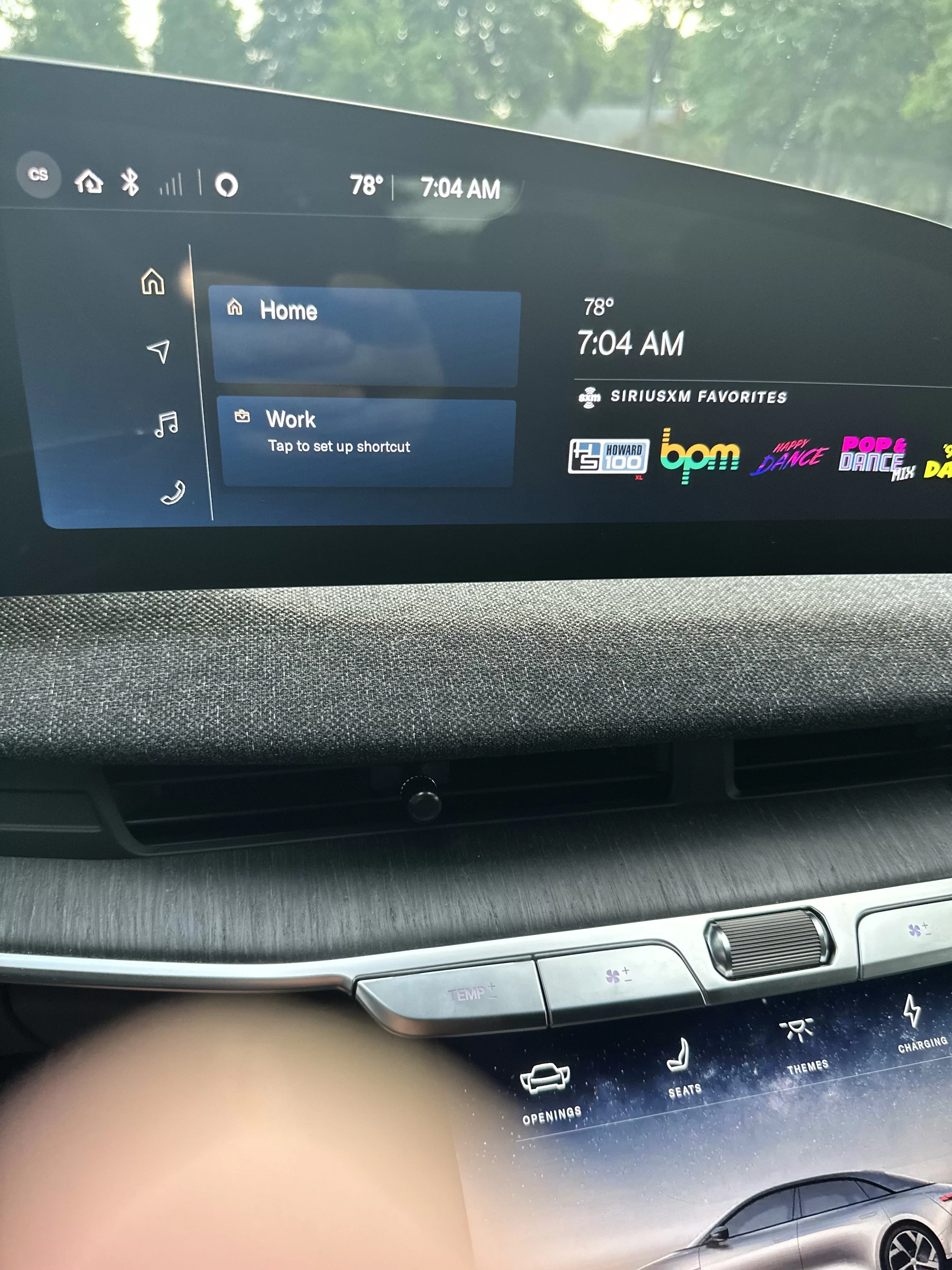

4 days after delivery, my car lost all cellular connectivity. Tried the Air Reset and 2 Button/Brake Reset to no avail. Waiting on service to figure out if they can do remote service or I have to make a 2 hour drive to the service center.
