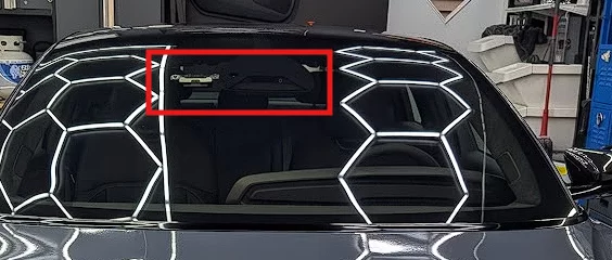

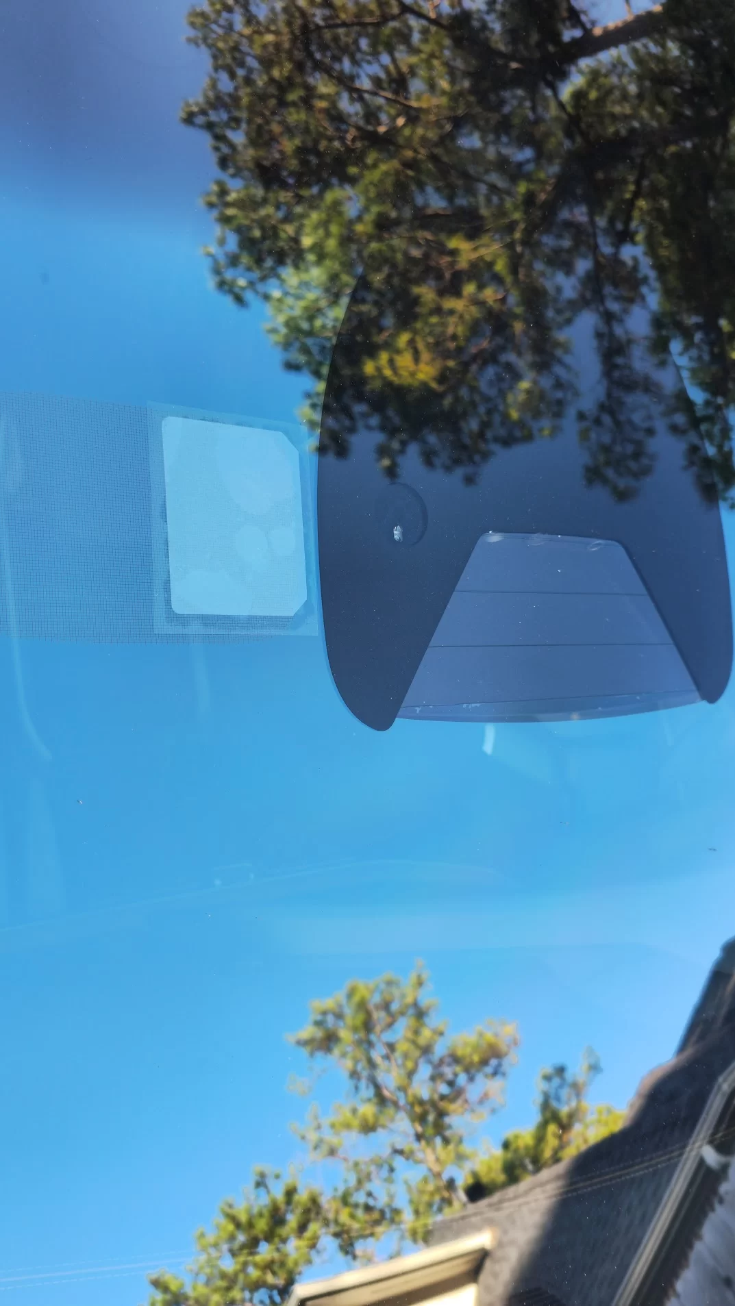

NJ based EZ pass driver here with 2025 Lucid Touring. There is a spot to the right of the mirror that is for your EZ-Pass. it's hard to see, but once you see the spot, it's hard to unsee. If you place the EZ Pass there, it'll start reading. I had the same issue.

Thanks for the feedback. I resolved the ez pass issue by mounting in the spot labeled above. However, my concerns is everything else. No GPS signal and garage door remote doesn't work either through the windshield. It's like I'm driving a faraday box. Sounds like this isn't normal for others with same set up?
Thank you Macbain for showing this! I won’t have to put the ugly front plate transponder on.
