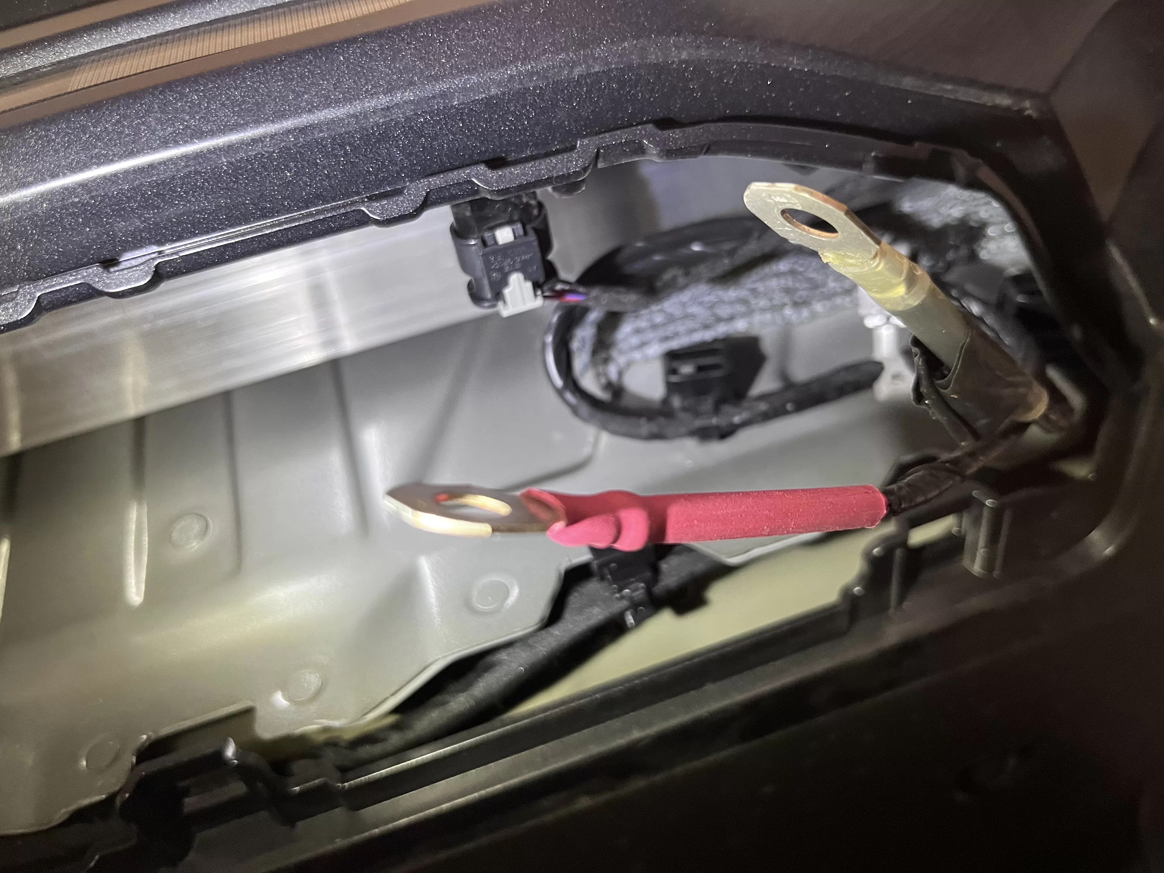

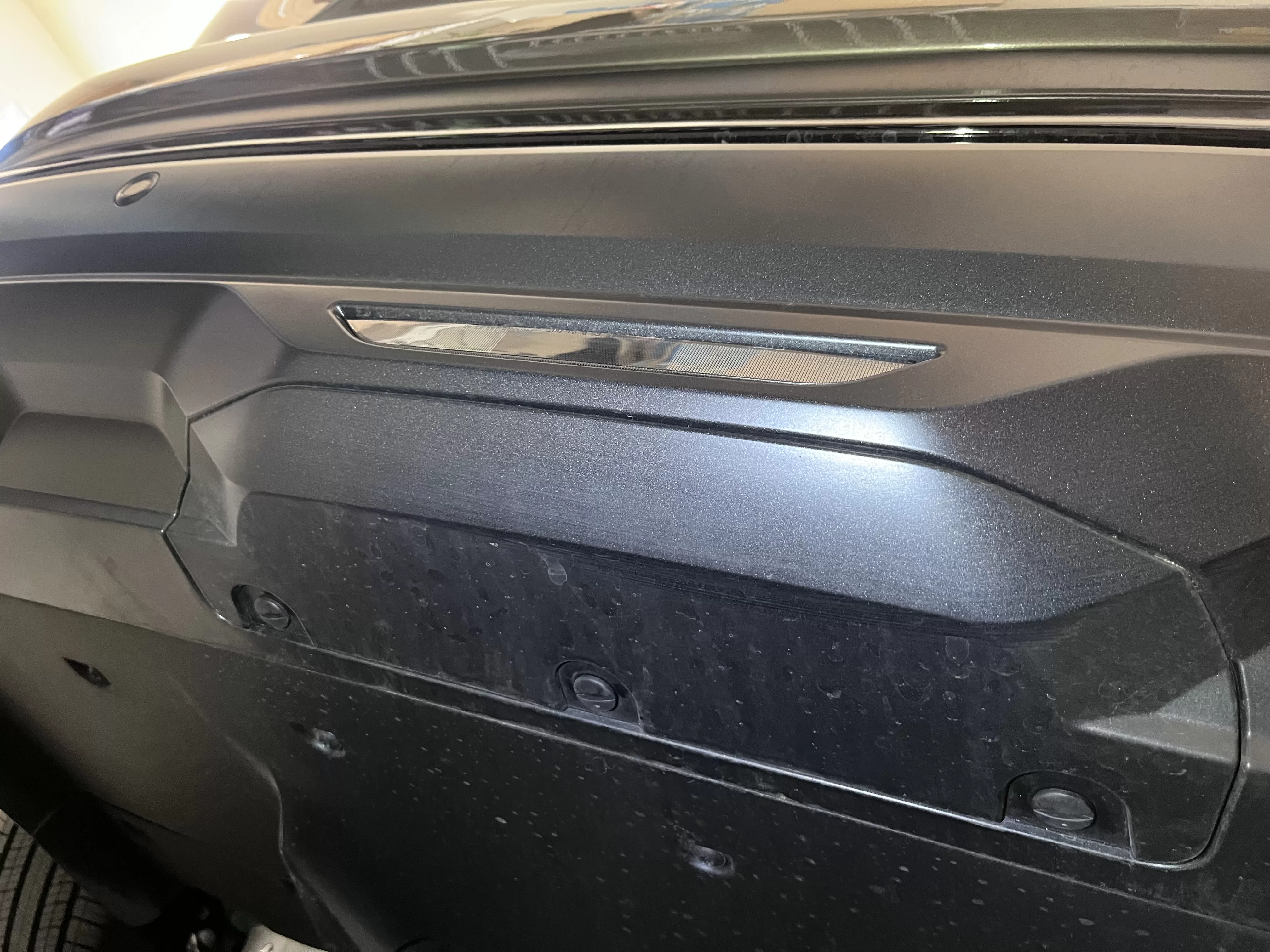

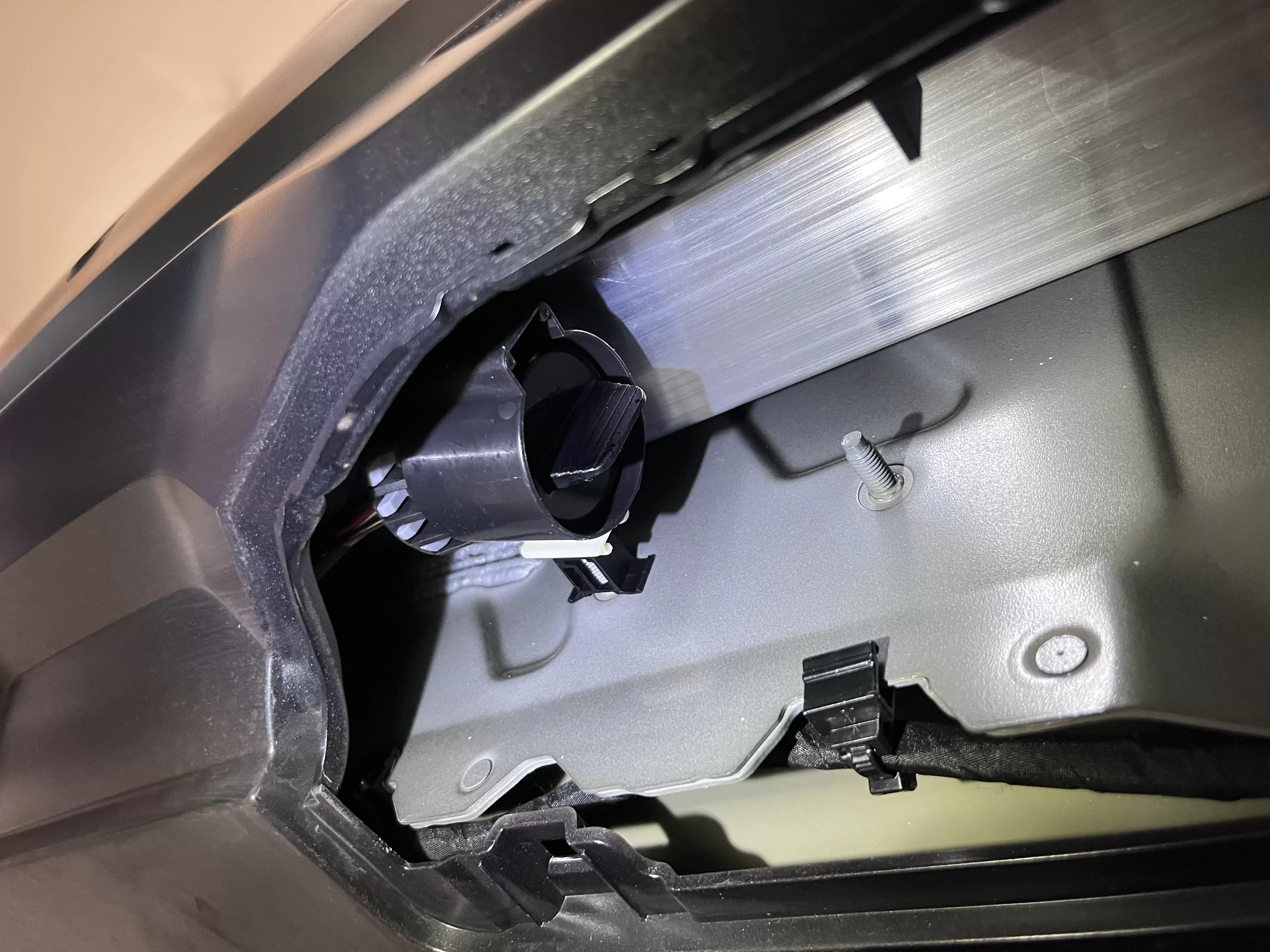

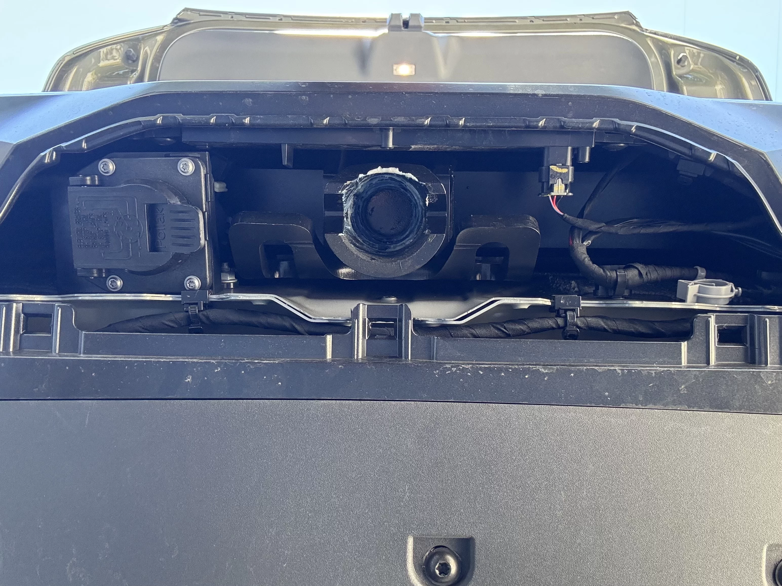

I've seen somewhere an X-ray drawing of the hitch attachment. It's a wide steel piece that bolts onto the rear frame members and lives inside the bumper cover.
The chain attachment points and the receiver attachment point would both be welded to that piece.
So installation of one afterwards would require disassembly of the rear bumper.
that tracks, a friend of mine installed a tow hitch package to his Tesla Model 3 after the fact. I don't think it was Oris based like the Lucid, but yes, it did require removing the whole bumper to do it and took him all day to do by himself. he would not do it again. :)
