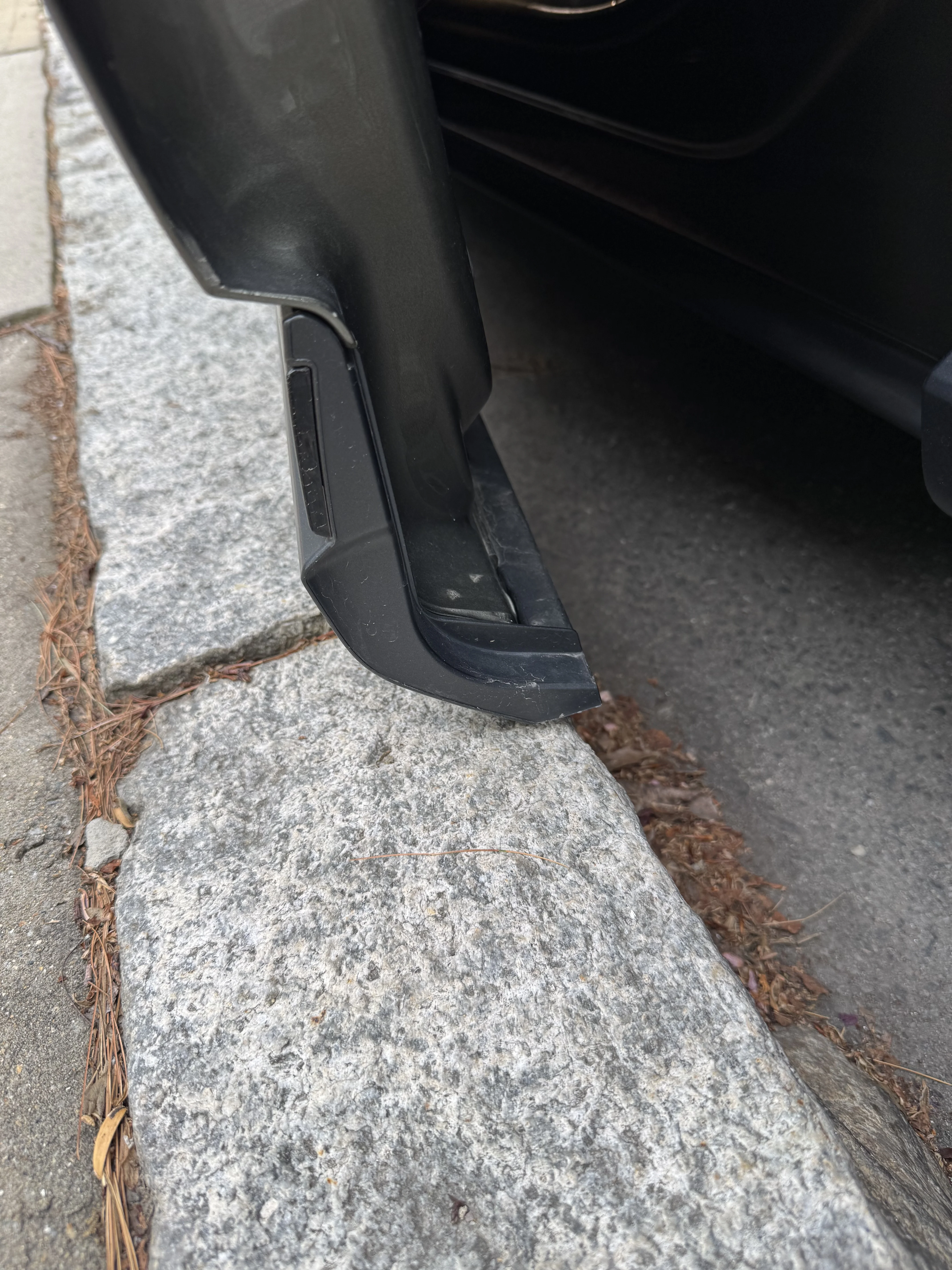

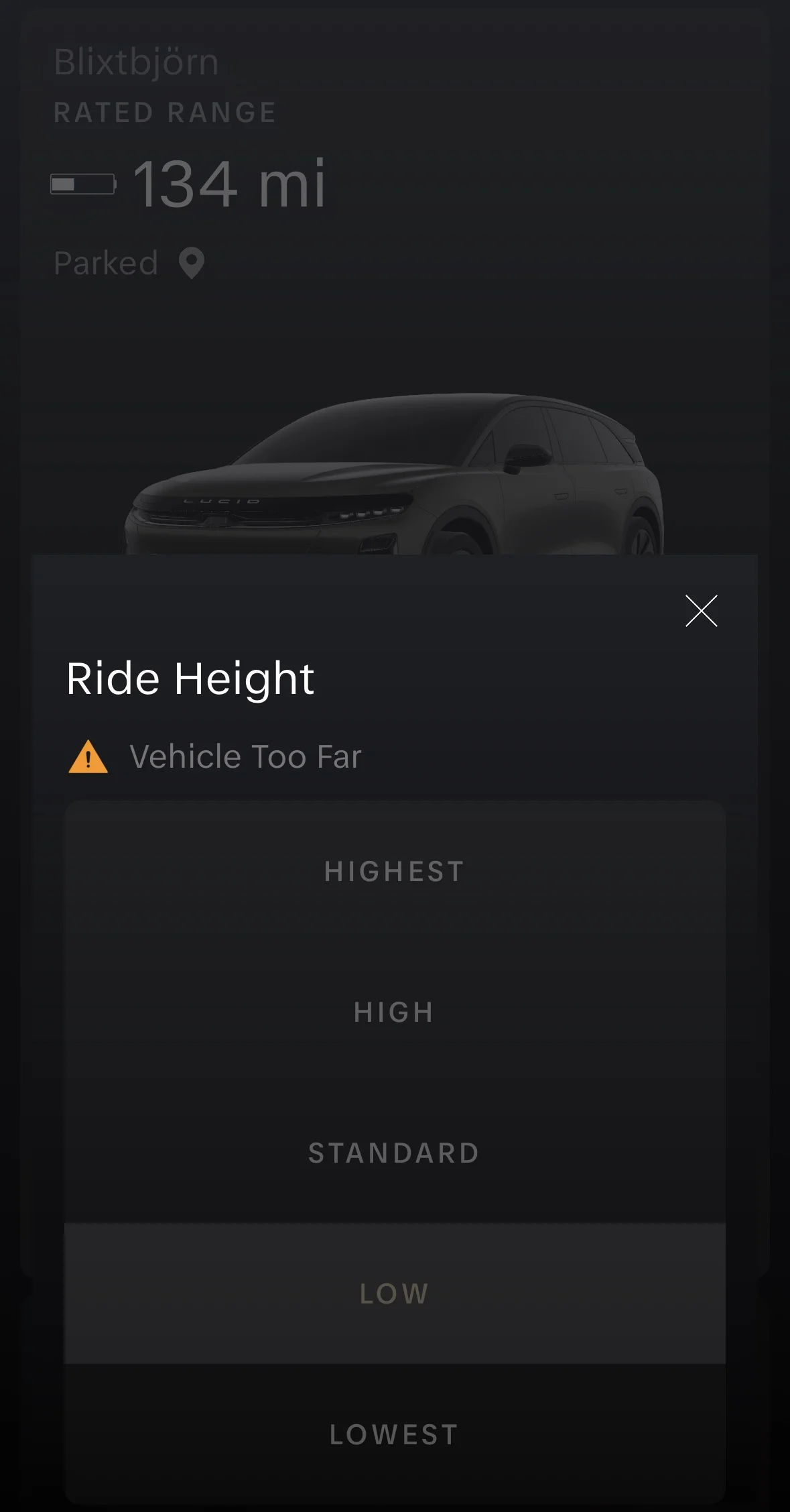

Yes, location services were on. Yes, I restarted the app. The in-app location was right next to me, and yet...
After scratching my head for a 30 seconds I got in on the passenger side and adjusted the ride height on the pilot panel so I could open the driver's door.
Still, weird things like this keep happening. Ride height adjusts due to load and the door can't be closed because manual adjustment can't be performed with the door open. However... this happened. Adjustable ride height is great, but something is just badly designed here.... we've never had this issue with our X.

You can adjust the ride height in the app. The function didn't use to work so well, but it's pretty reliable now. The other option is to turn off the easy exit ride height adjustment, so the car does not go into low when you get out.
