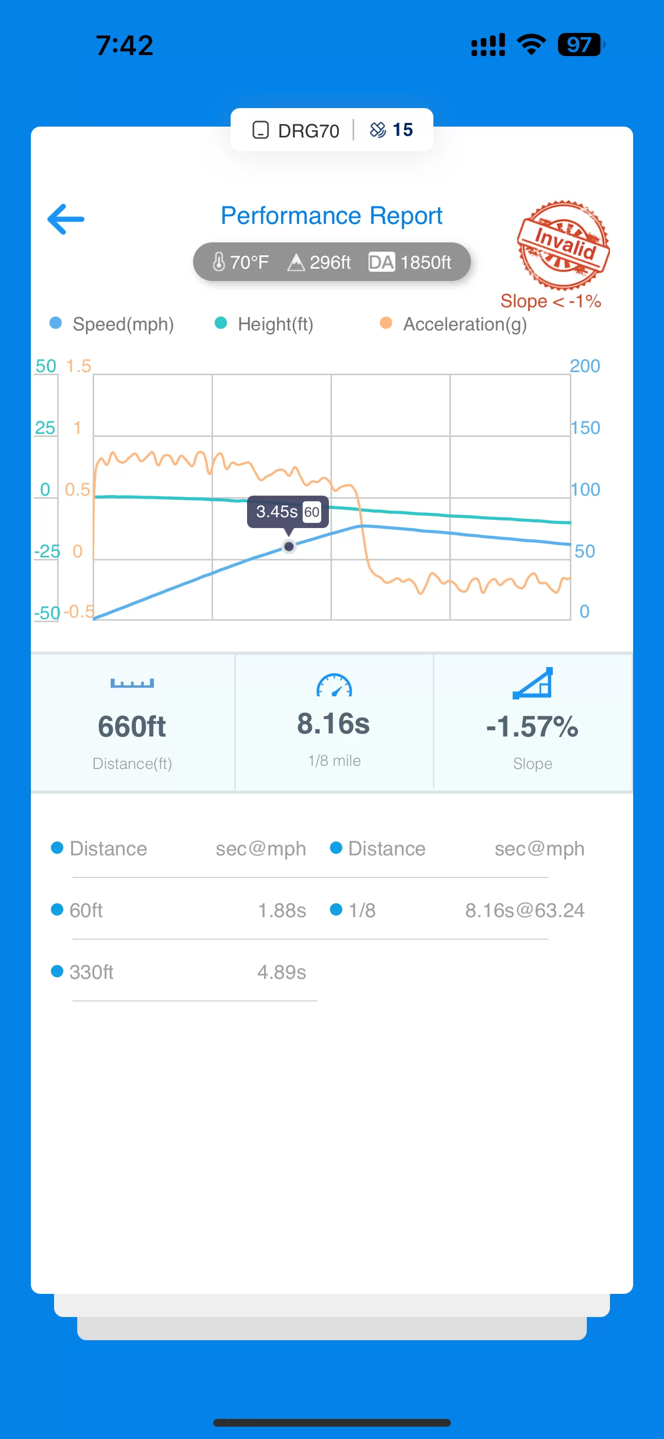

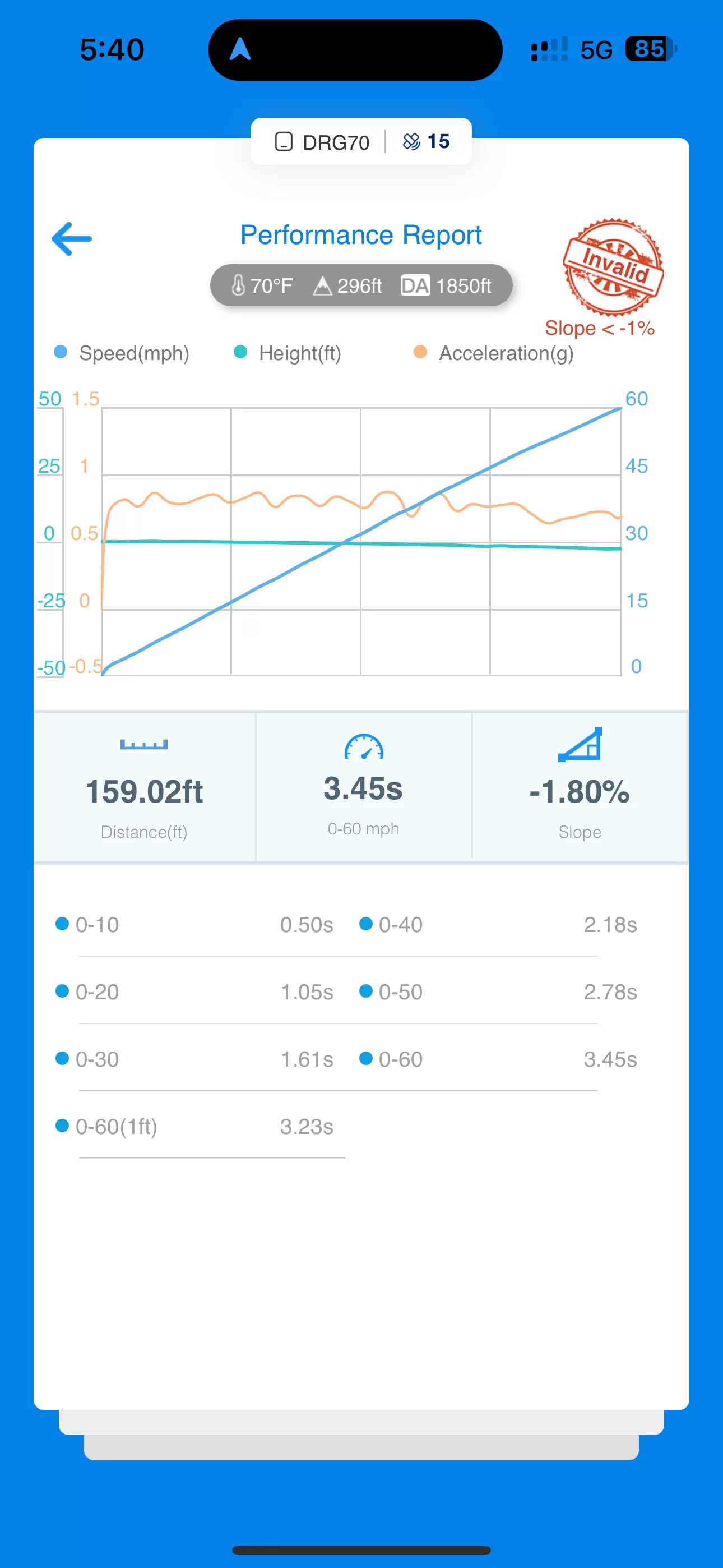

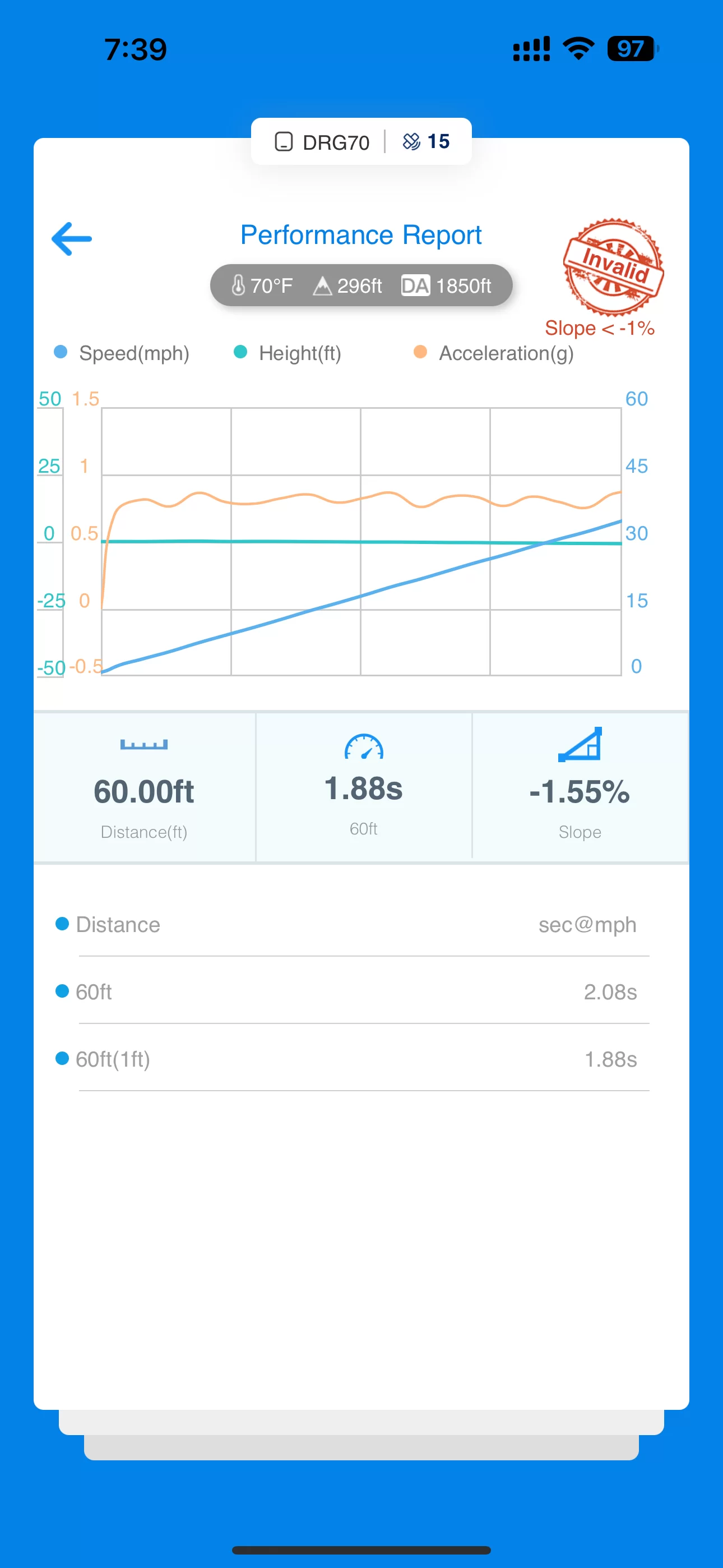

I have been trying to get Borski to measure GT performance and I have failed. Instead everyone had to wait a good 6 months for me to go on a test drive on the day before last.
0-30 my Lincoln is as fast or faster because someone made Gravity real gentle…and after 30…things get real (and yes, I used launch control)
I will be posting a little more data in my FB group simply because uploading is easier and I can go back and fix spelling mistakes as far back as I want….
Borski, you can still redeem your self and run a proper 1/8 or 1/4 mile, and a 70-0 braking test, something the person next to me discouraged me from doing. He was a good sport otherwise as I was testing the Gravity as it was the first EV I ever drove and the 3rd time I was inside an EV…

Does anyone have thoughts or theories on why it might be “gentle” from 0-30? I can’t imagine they would limit its power in launch mode. Perhaps it’s the weight of the car, or limit of the tires?
Thanks for the timings and for the detailed test drive review! I will have to remember to try checking my blindspot in various ways when I do a test drive.
They are definitely limiting power, the surface was random and not super grippy, no tire spin that I can notice at all. Launch control was used so this is exactly working as designed.
They do quote 3.4 to 60 after all and with a slight downhill it went 3.2 with 2 adults inside.
All quoted times include the 1ft roll out as all car magazines.
That's just the way single gear EVs accelerate, constant torque and then constant horsepower (with some rolloff at very high speed.)
As can be seen on the g force line it's nowhere close to breaking traction. It feels like it accelerates faster above 30 because it keeps accelerating at the same rate whereas your Lincoln needs to upshift. For some reason there is a myth that EVs accelerate fast off the line, it's not really true (I'm saying that if you took an ICE vehicle with a 0-60 of 3.5s it would be much faster off the line.)

Doesn't look like draggy is accurate enough to measure differences in "jerk" (the rate of change of acceleration) and it probably wouldn't make much difference in acceleration times (though it might make it feel faster.)
Dragy is track accurate.
Yeah but it's not accurate for the third derivative of track accurate.
speed = distance/time
acceleration = distance/time^2
jerk = distance/time^3
You can see that the acceleration data of drag is already super noisy, the car is not actually oscillating between 0.7g and 0.8g.
Jerk is how long the acceleration takes to ramp up. I'm saying that how fast the car reaches 0.8g acceleration would make the car feel quicker but wouldn't actually make it much quicker.

You are assuming Dragy can’t measure G forces or you can assume Gravity isn’t applying a constant force considering uneven non track surface.
Assumptions are not facts, a best guess.
You are correct that I am assuming that it can't produce clean data because I've never seen it produce clean data and I've seen a lot of Dragy plots.
They all look like this:
Also, they are clearly filtering it which would hide any changes in jerk anyway.
Again, this does not mean it can't produce accurate 0-60 or 1/4 miles times.
It’s also possible the power is not constant and traction could be a limiting factor which forces the ups and downs.
Not sure what we are trying to prove here, Lucid claimed a 3.4 and with a slight downhill and two people it went 3.2 on unprepped surface.
