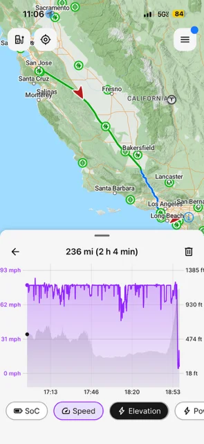

The two big chunks of driving on that Show Low > Casa Grande leg of the trip (the middle section is broken up a lot because I stopped to take pictures in a bunch of places) thanks to the great LucidTracker+ trips feature:
This particular stretch from Carlsbad > Alamogordo includes the Cloudtop > Alamogordo section from 8600 ft down to 4000 ft that is almost all a 6% grade.

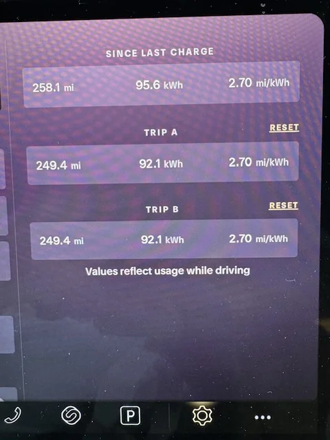

80s through a rain storm…trip both ways to account for elevation. I blame the tires…they really didn’t care about the speed and maintained perfect traction. Temps in the 50s.
