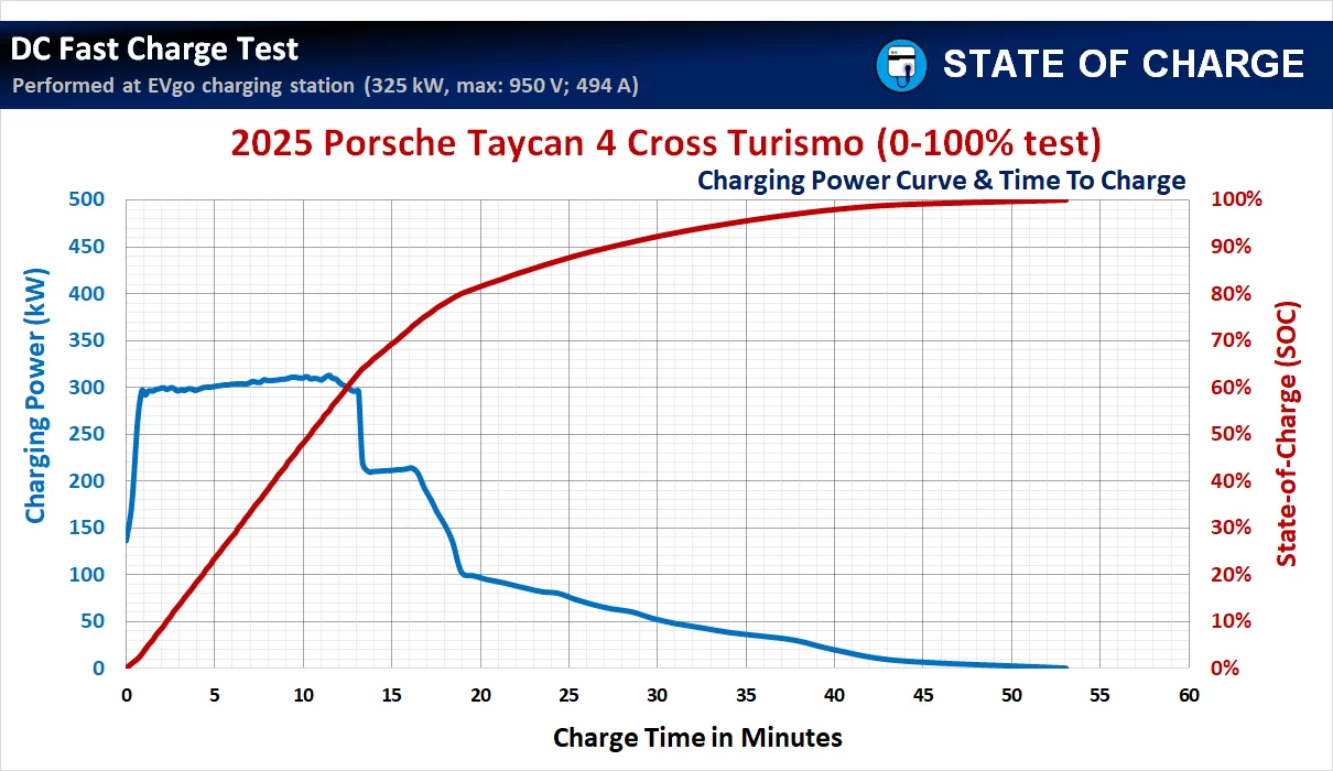

After less than a week with our new Gravity, we're gravely disappointed with the charging. We were promised fast charging at 350 KW chargers of approximately 20 minutes. In fact, the car would not accept fast download and it consistently took nearly an hour for full charge. Who has time for that? My Porsche Taycan charges in 20 minutes on the same public charger. We feel that the car was sold to us under false pretenses.
I think that you are either doing something wrong or that your Gravity needs service. Taycan is slightly faster at increasing SOC, 0% to 80% in 18 minutes versus 26 for Gravity. The Taycan does not charge to 100% in 20 minutes.

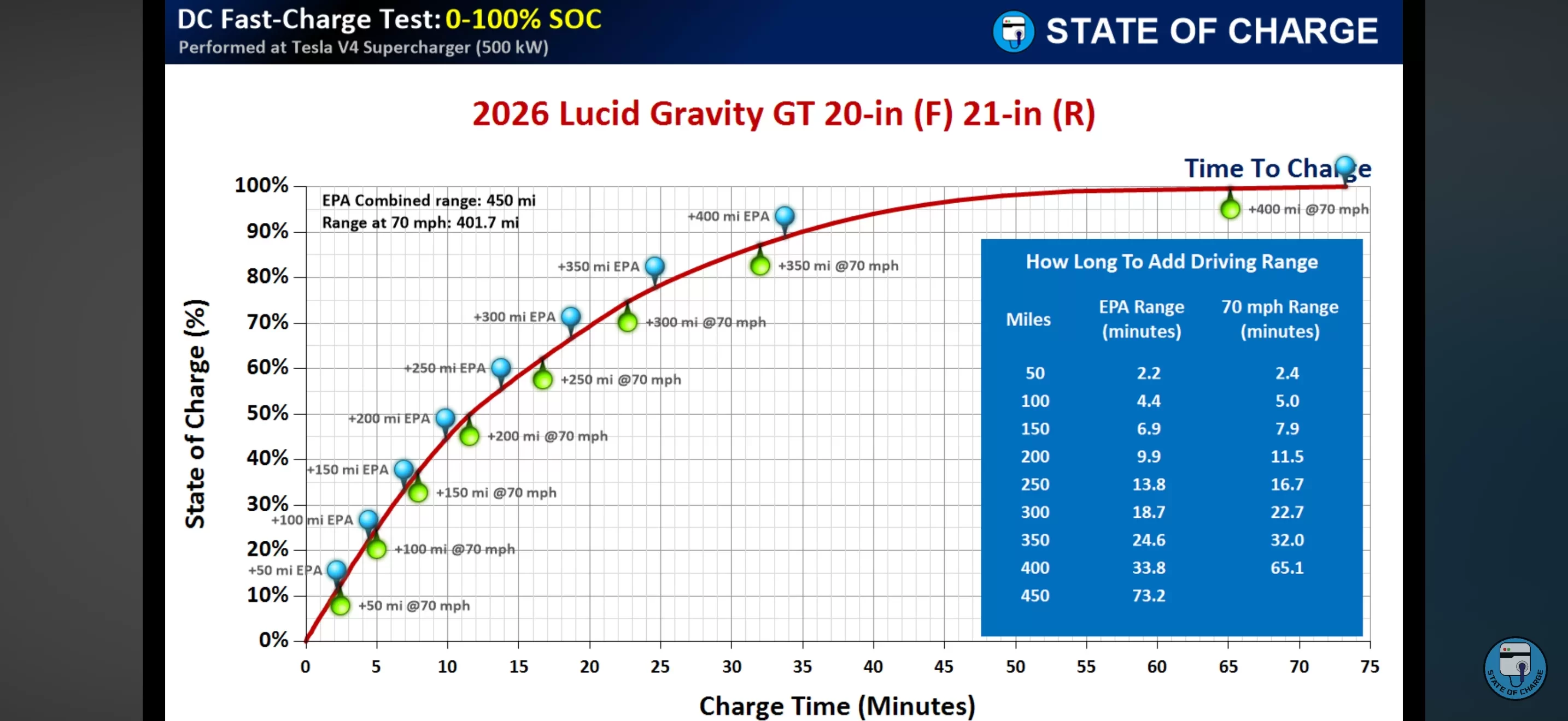

10% to 80% takes less than 25 minutes. 80% to 100% takes much longer, almost 50 more minutes, the same as nearly every other EV.
Gravity is one of the fastest production vehicles as measured in DC fast charging miles added per minute.
200 miles (0 to 50%) in 11 minutes is seriously impressive. Makes a charging stop comparable to a gas stop. Get in, get out!
Anyone charging to 100% on a DC charger is an idiot unless it’s absolutely necessary due to limited charger availability on your trip!
