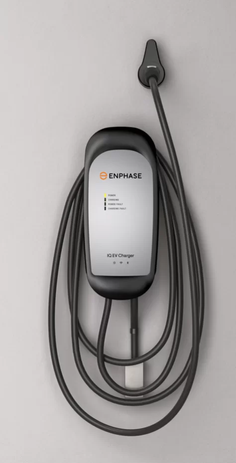

I have what may be a somewhat unique situation but I’ll ask anyway:
I have solar panels and have net metering with my local electric company. I understand that the Enphase home charger can be set up so that it’ll charge excess electricity to my car (when it’s plugged in) instead of sending it all to the grid.
1) if there is only minimal overproduction of electricity by my solar system, will the charger only charge that amount?
2) can I, without having to mess with the app or settings, set it up so that it will ALSO only charge after midnight (when electricity is cheapest to purchase)?
3) yes, the unit ain’t pretty.
