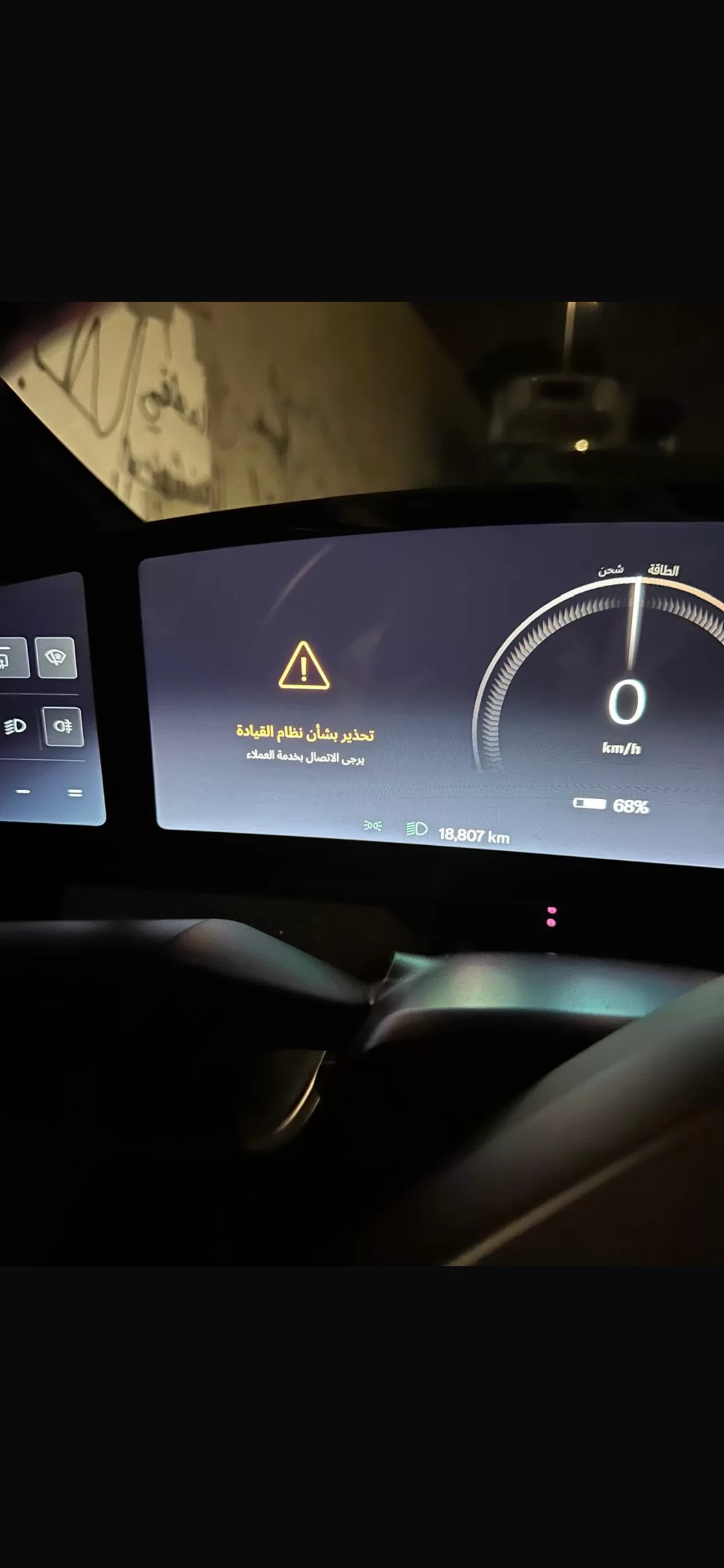

Two weeks ago, this warning light witch say driving system warning appeared in my 2025 Lucid Air Pure. I contacted customer support, and they advised me to bring the car to the service center. So I sent it in.
Today, after two weeks, I received the car back and asked the technician what was fixed. He said they didn’t find any issue, but they performed a software update and the problem disappeared.
It’s worth mentioning that before the issue occurred, I had already updated the car myself to the latest available version, which was 2.6.16.

Same with me. They towed my car. Kept it for 2 weeks. They installed the newest update that became available while the car was at the shop.
Said no hardware issues. Just software. Get the car back this weekend.
Well picked up the car, 4 hours later got the “Drive System Warning” again. What a mess.
I had that warning pop up for a few days, called customer service, waited a couple days for my local service center to reach out and by then it went away and never came back again. No updates involved.
